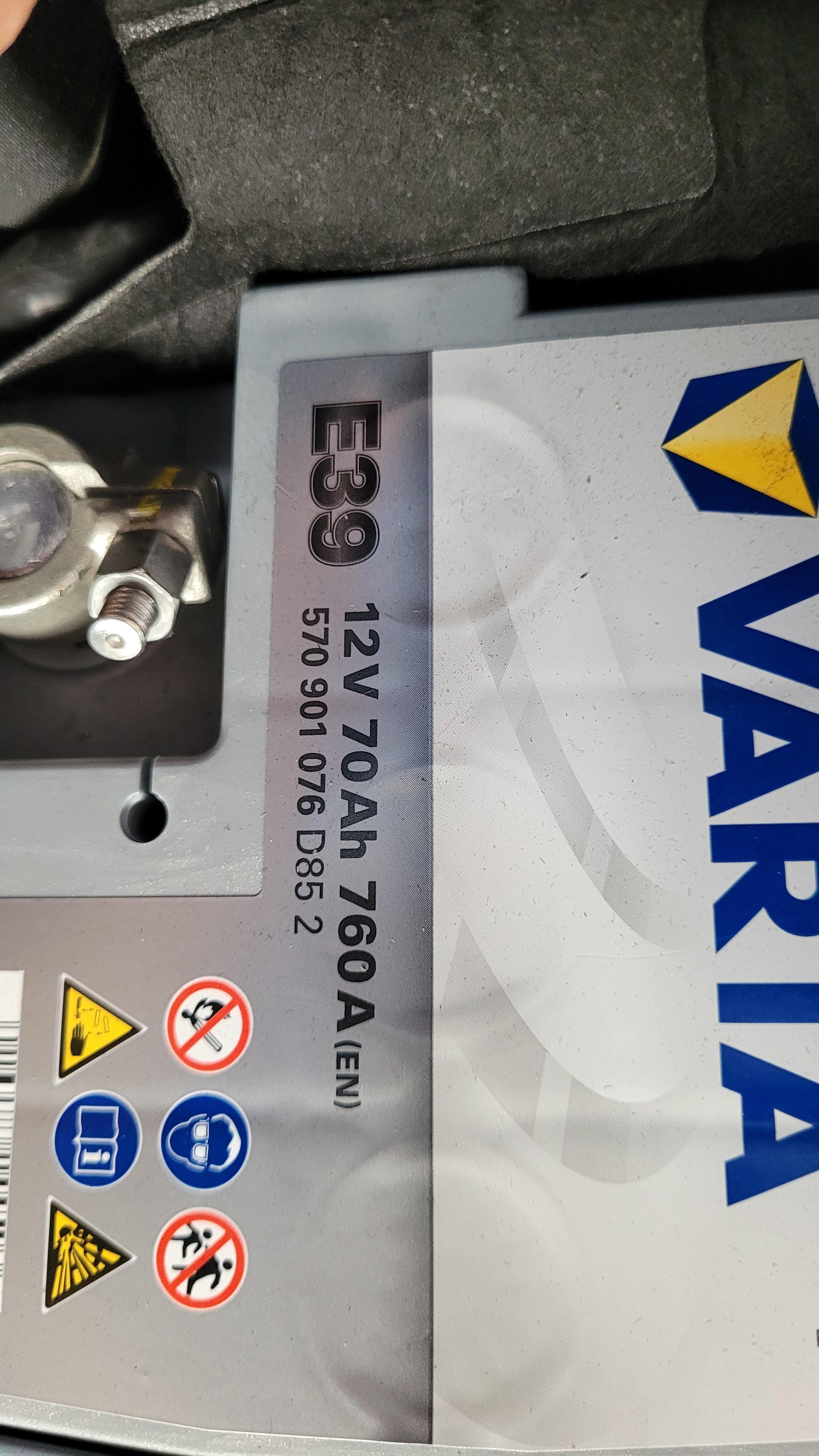

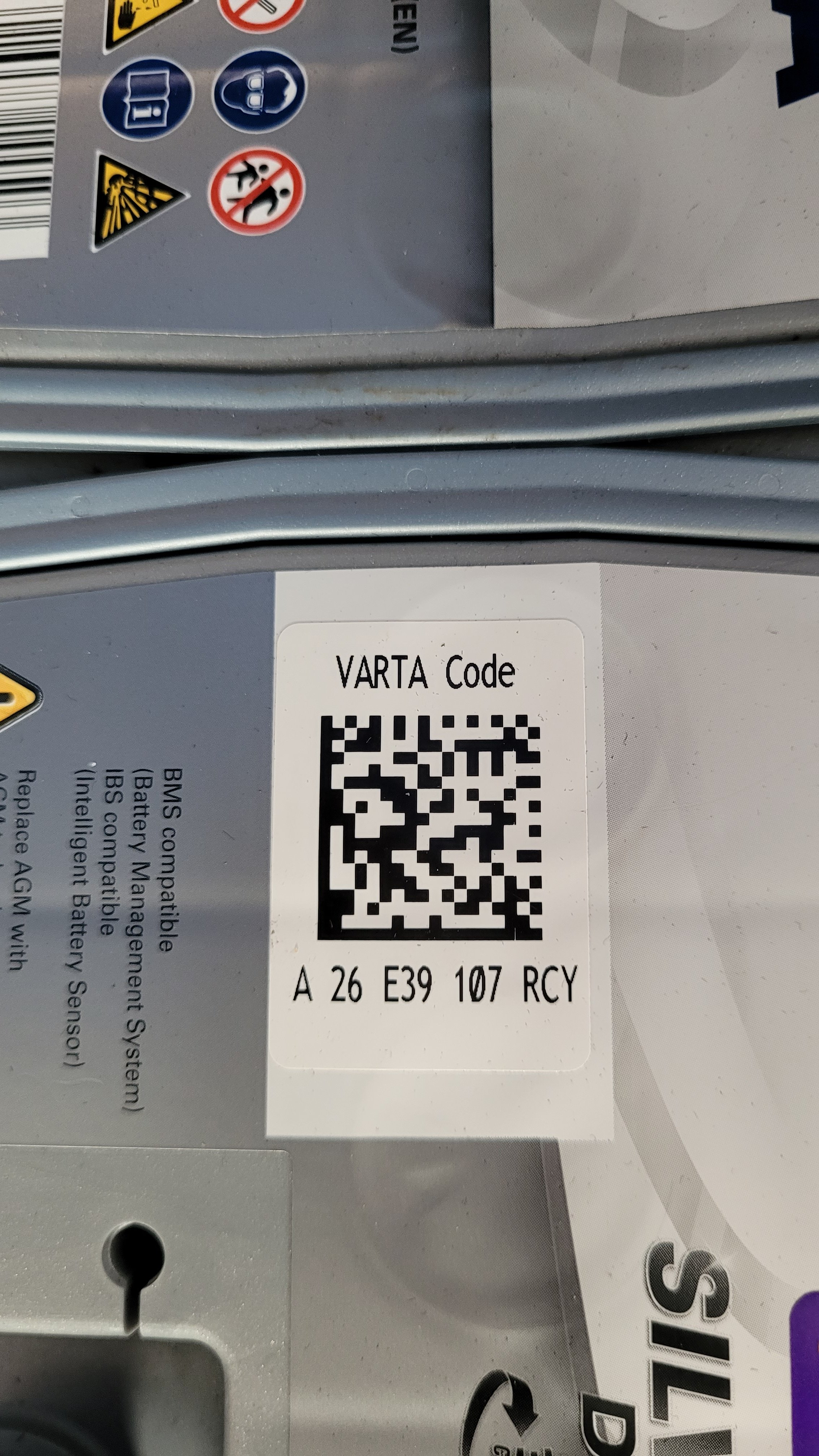

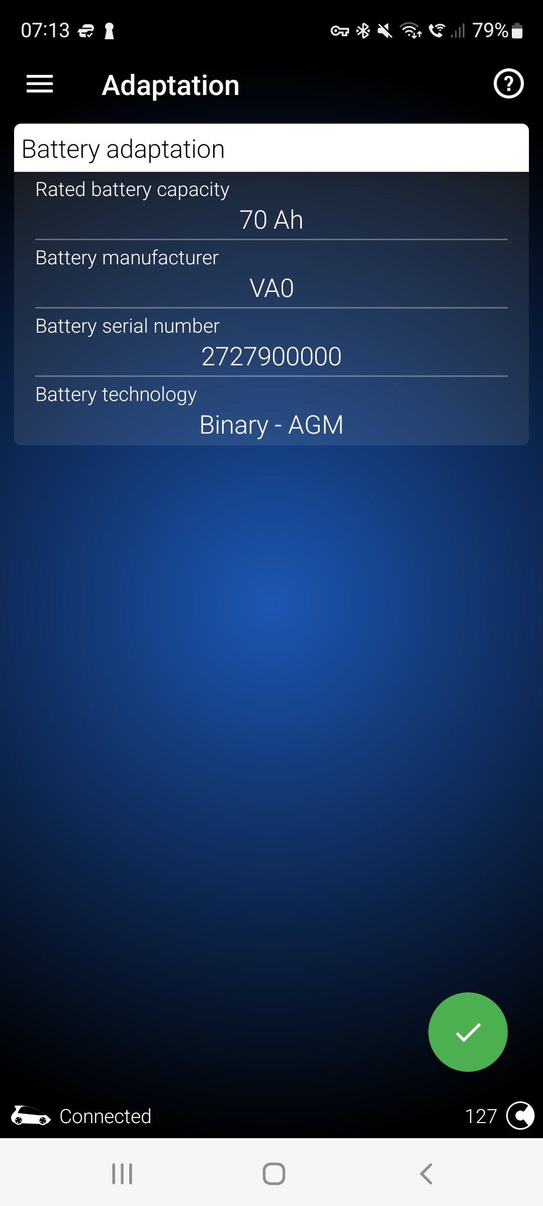

  4. I checked on obdeleven and it looks like the shop machine definitely changed the adaptatiom information. I'll attach the battery pictures and the coding information.
