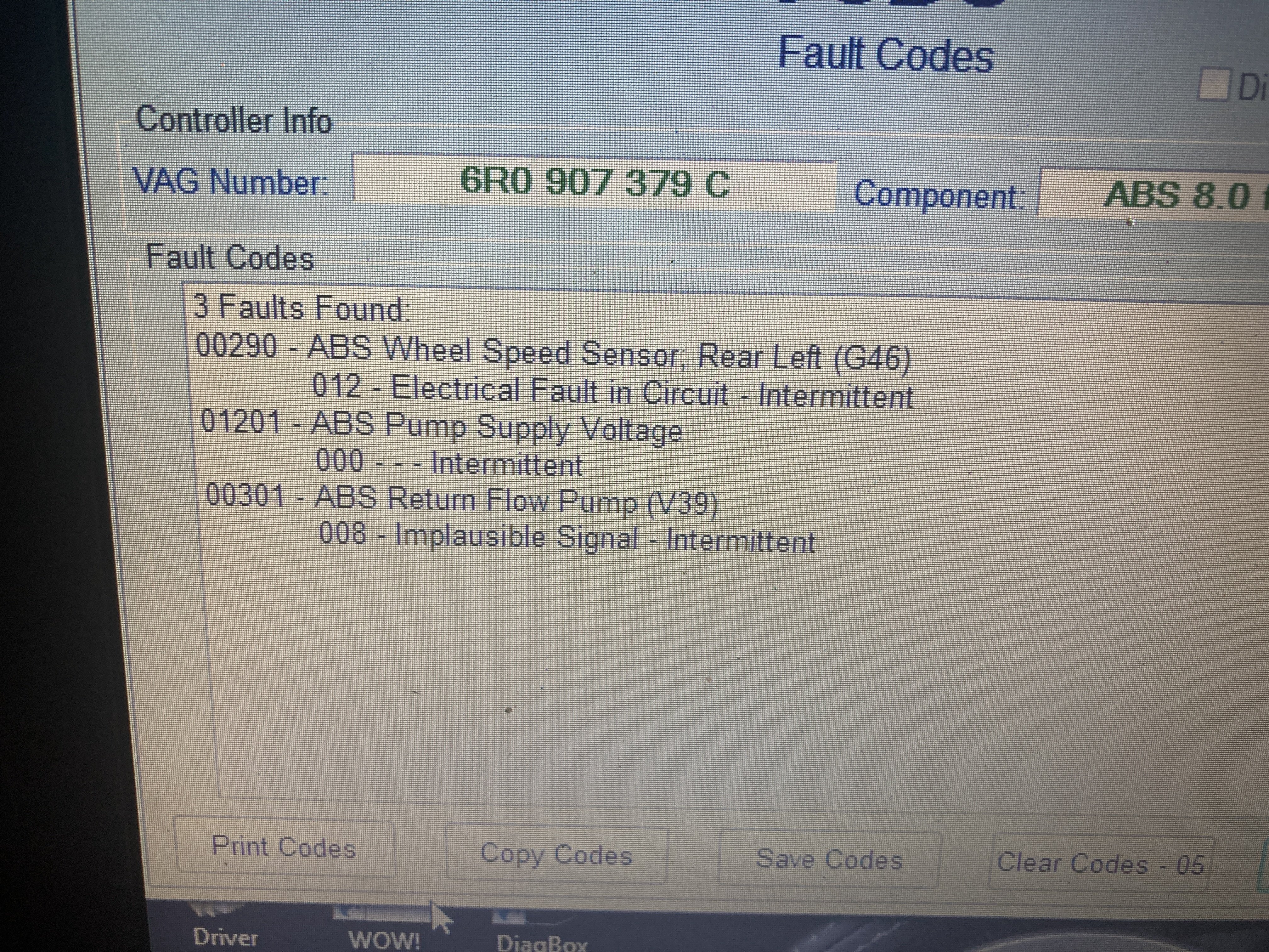

  2. What would be a solution to fixing that ?
  3. Just to add these are the codes
  4. Rear left. I don’t think the issue can be the pump because when I jam the breaks I can feel the rear right still works.
