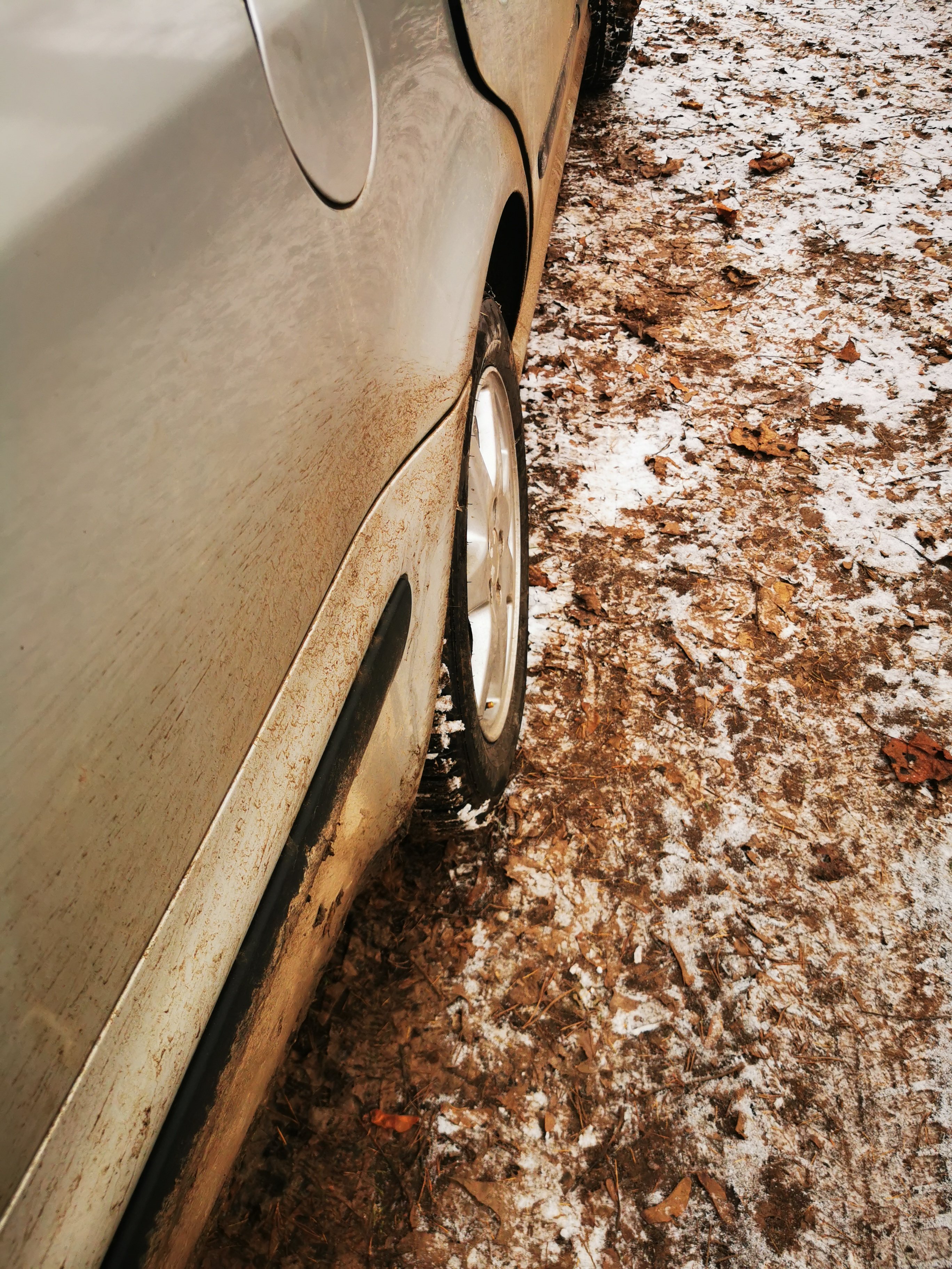

  2. Hello, my skoda octavia mk1 4x4 rear wheels are in negative angle, as more i put weight on rear, then more it goes in that angle. Its eating my tires!!! (both wheels are on that angle) If anyone have had same issues, please let me know.
