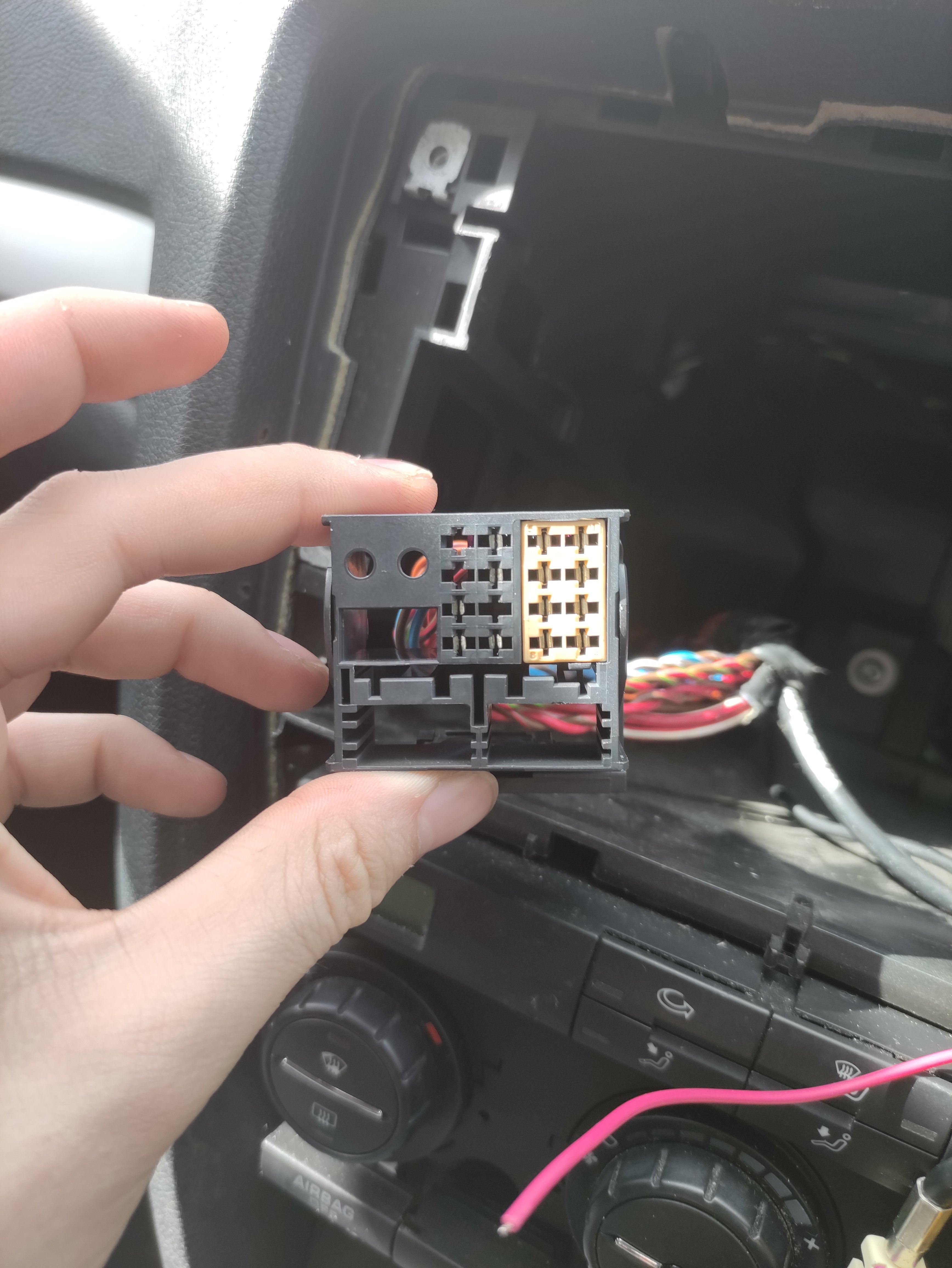

  1. So I installed a reverse camera up to the radio, I plugged into the radio this black small box, I did looked it up - it seems to be some form of Canbox so im assuming the radio is getting information from this. Now I'm not sure why (as im convinced i originally has this plugged in when i originally had the battery draining issue) but after putting this in and the gps everything just worked, the radio knew what my car was doing (Turns off and on with ignition, backlight turns on when i put my lights on)

  10. I understand what you mean about the live and switched live cables and that may be the case but I've read in this thread that the Octavia II doesn't have an ignition switch, so that would mean that even if I did switch the wires it would still draw power from my understanding? I apologise, I am clueless when it comes to electrics. Interesting stuff, would it be possible to do this at my home or would I need a professional to code it?
  11. Sorry I forgot to mention I'm also trying to figure out exactly what pins do what inside my radio to make sure the adapter is lining up with my car connection
  12. Hello, I've installed a aftermarket android radio into my skoda octavia II 2006. This one to be exact: Junsun V1 The installation went okay my issue is that when I take the key out of the ignition the radio doesn't turn off and drains my battery. I know there is something I have to do with the yellow and red wire within the adapter given from the product but I'm clueless when it comes to electrics, if somebody could explain to me what I have to do/get that would be amazing thank you
