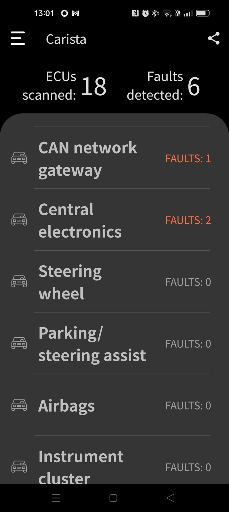

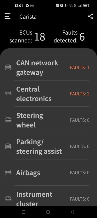

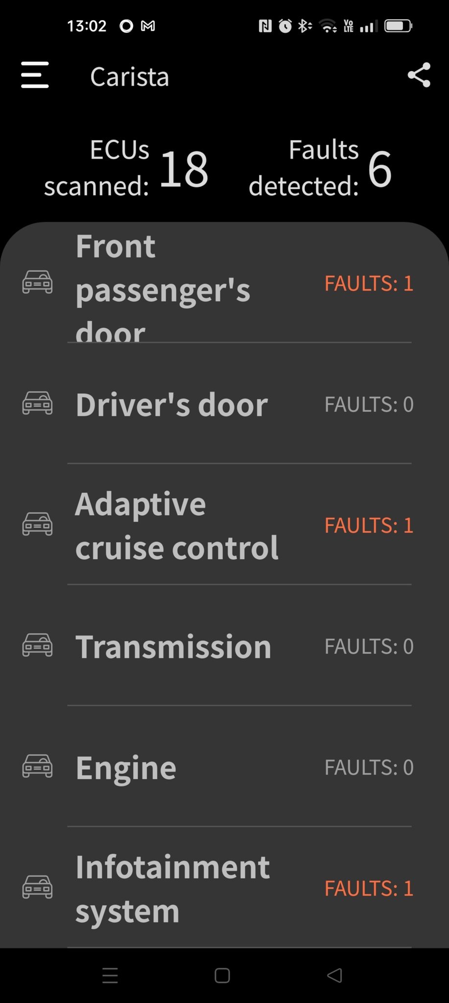

  2. I have no adaptive cruise control. I have no problem with central locking or anything else. The only thing is the broken bulb warning that pops up now and then. It is not broken but gets no voltage. Before I start searching for broken wires in a fairly new car of go the the dealership, I want to make 100% sure it has nothing to do with the firmware.

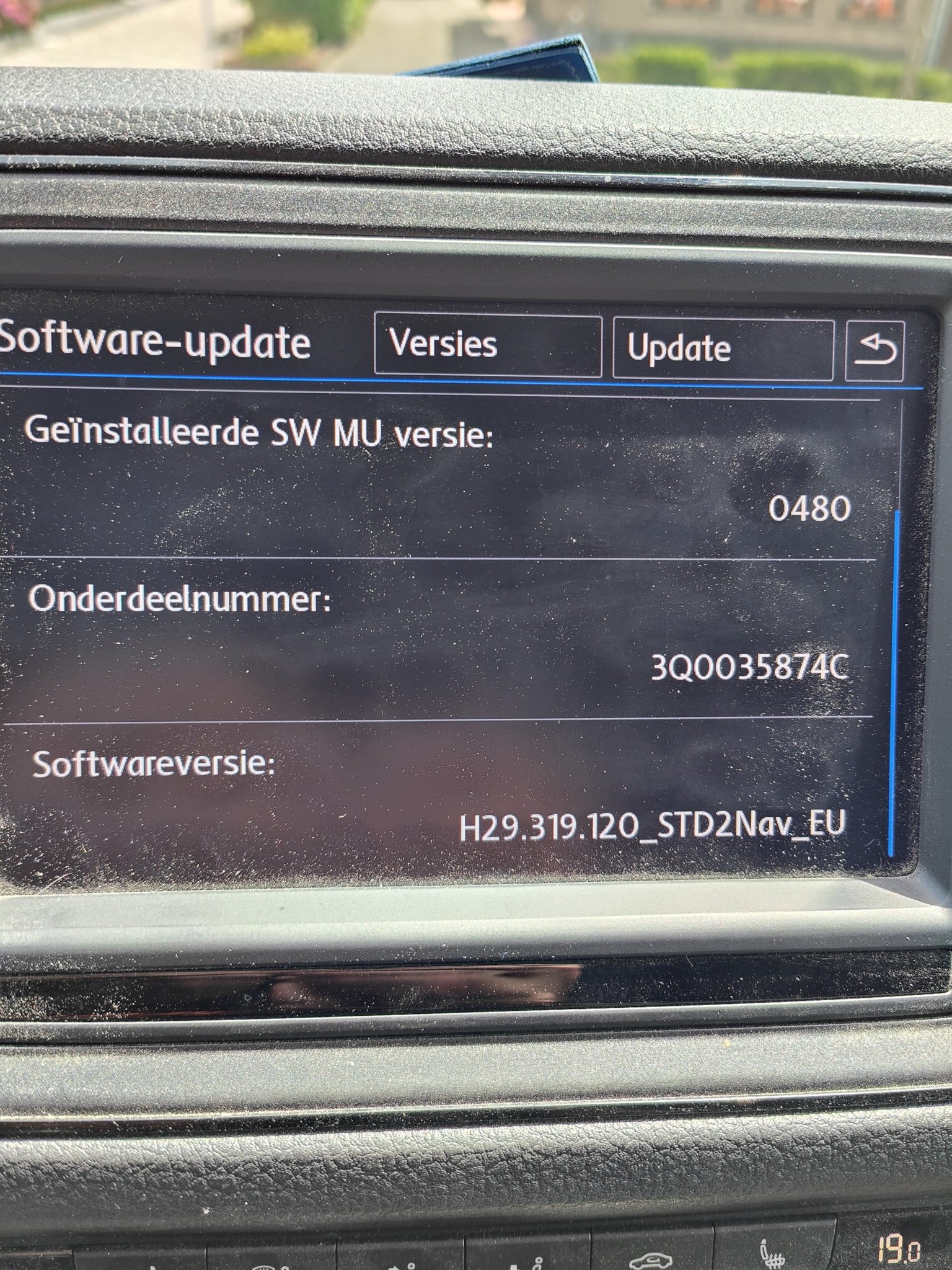

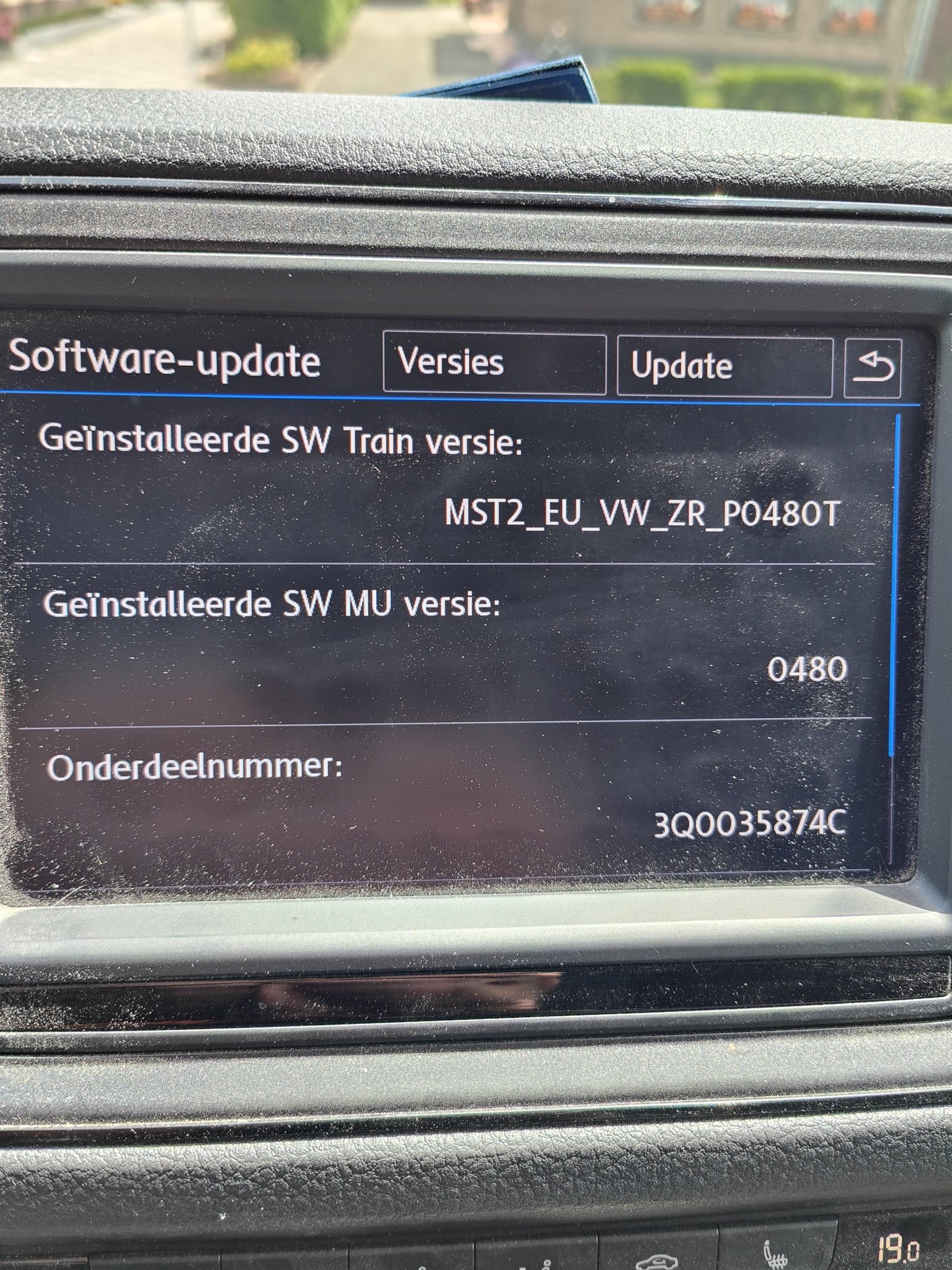

  3. I have 0480 now but since that is on my system I have errorcodes that were not there before. One code has something to do with the media system. One code with problem central locking system and front right turnsignal does no longer work. Bulb is OK, just no more voltage on the cable and an error on the main screen. I now that this should not affect other systems in the car but it all started a few days after the upgrade. It can be all coincidence but to make sure I would like to roll back to 0478 to check.
  4. @pab567 can you please give me a link? Thank you! 🙂
  5. Hi, Like it says in the title, I am looking for this version: mst2_eu_vw_zr_p0478t Can someone provide me with a download link? Thanks,
