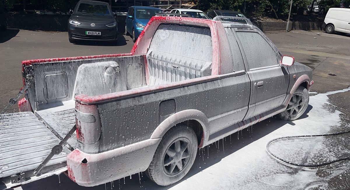

  1. Bought the truck as scrap and recovered it to the dealership. Don't mind about the value as it will be my car with no intentions to sell.... ever. I wanted one for ages and this one is far from original already! photo is from the day I bought it, Purple and red... horrible! I do think the 1.2 will be an easier swap.
