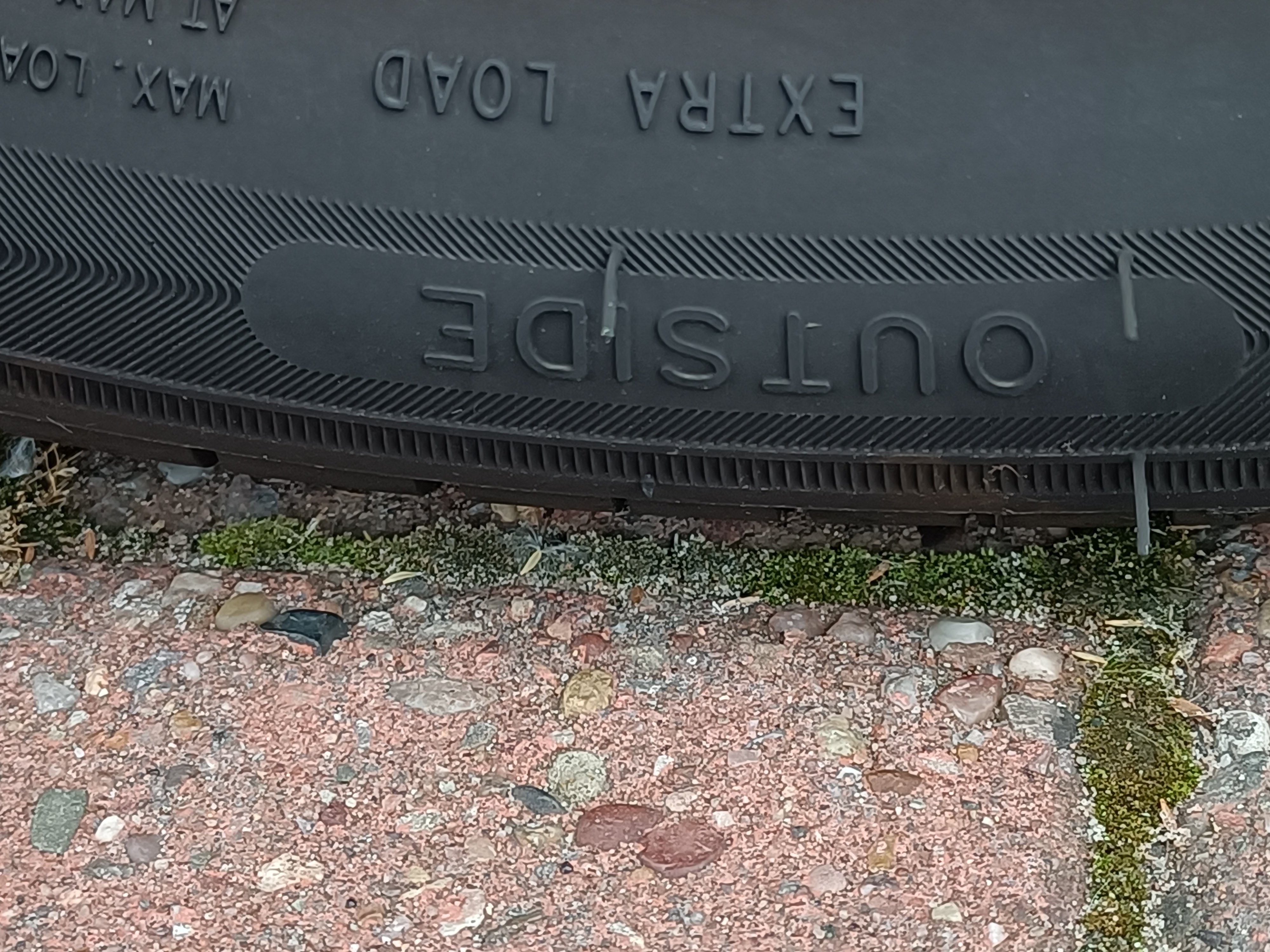

  6. Just checked. Looks like they are extra load. I did tell the tyre place I tow a caravan.
