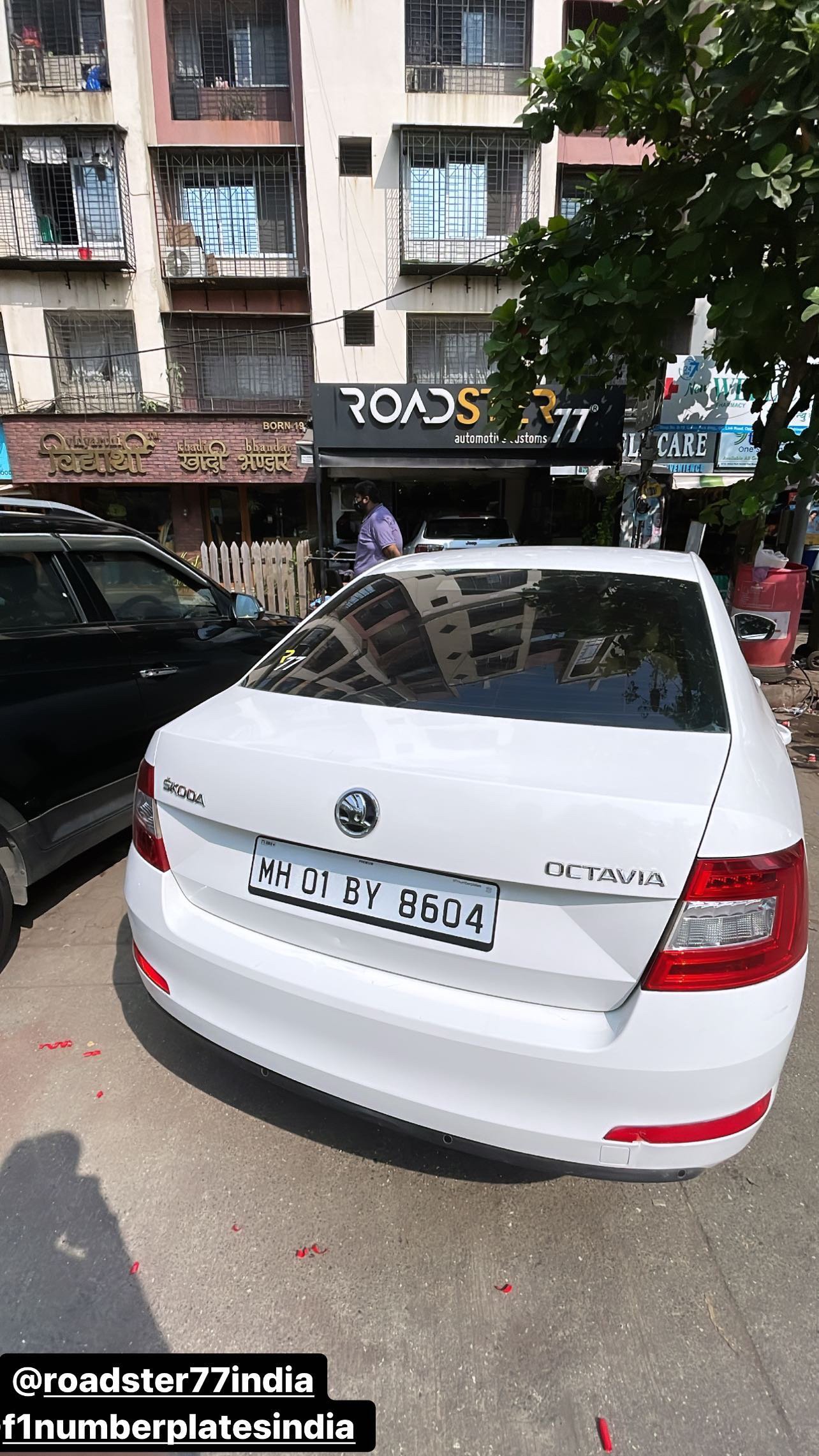

  1. Hello Guys! Firstly, I would like to thank all of you for helping me and keeping me motivated not to sell off the car. Invested quite a fair share of amount and time to bring this beauty back to a decent condition. Replaced all AirCon Components (Condenser, Compressor, and Evaporator) Replaced the Auxiliary Coolant Pump which solved the check engine light issue. Flywheel was replaced (It was needed) Timing Belt Kit replaced Basic Service and Gearbox Service including DQ250 Oil and Filter change Complete Suspension Overhaul Currently I am stuck with Power loss issue, unable to figure out the reason for this. Also blown Intake Manifold/Charge Air Cooler (I have temporarily cut off the coolant lines and made a direct connection to the inlet and outlet to prevent the engine from hydro-locking) I would also like to know if the Airbag and Central Locking connected, my car does not lock while driving, and there is a sound from the rear doors of the locks clicking. (I have checked all the connections and wiring, everything seems to be intact, and no signs of damage visible). We have run diagnostics on VCDS and yet there is no error for Central Locking function, but my Airbag light is on.
