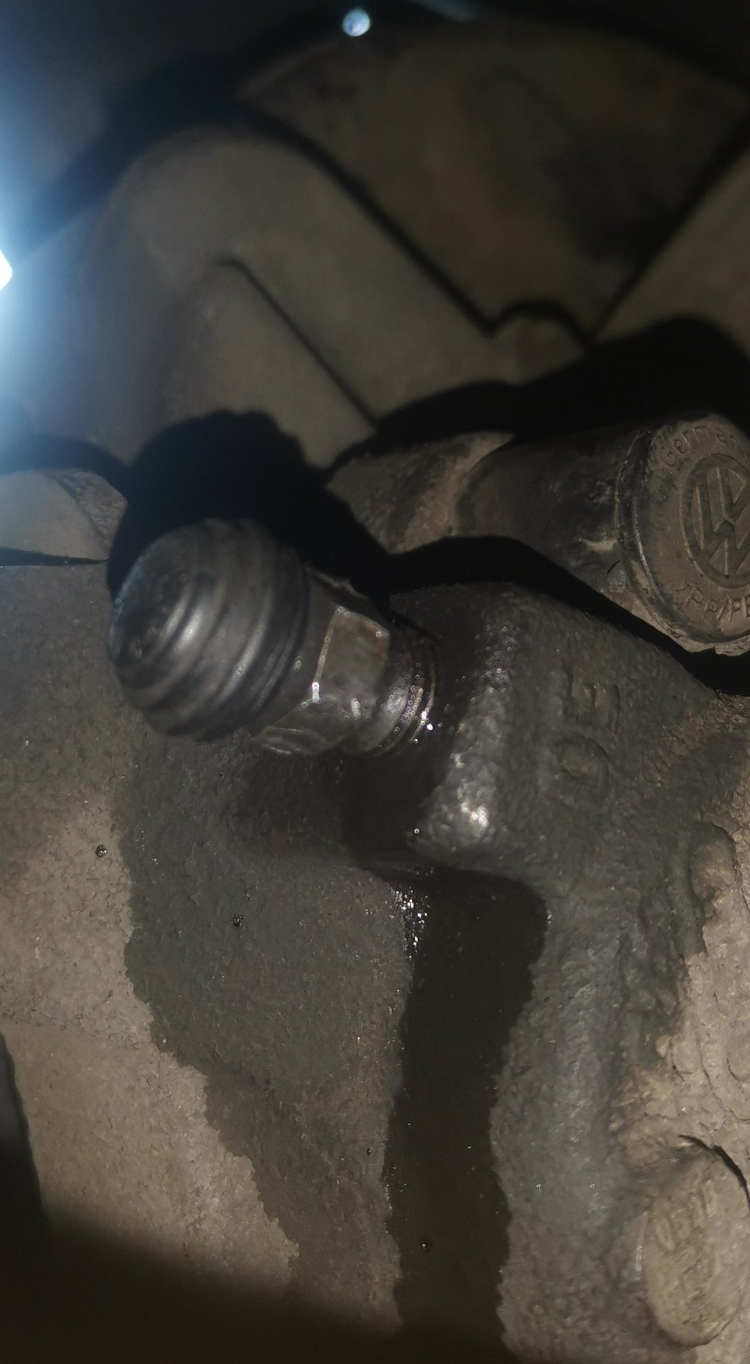

  4. Can anyone shed light on this. I bled my brakes and 6hrs later witnessed brake fluid dribble from each caliper on the front end of my vehicle. Is this normal? The reason I ask is because it has not done it since (it's been 36hrs) and I've done some decent driving since then. I've kept a close eye but am struggling to fathom how it may have happened in the first place unless there is indeed a leak at the bleed nipple threads.
