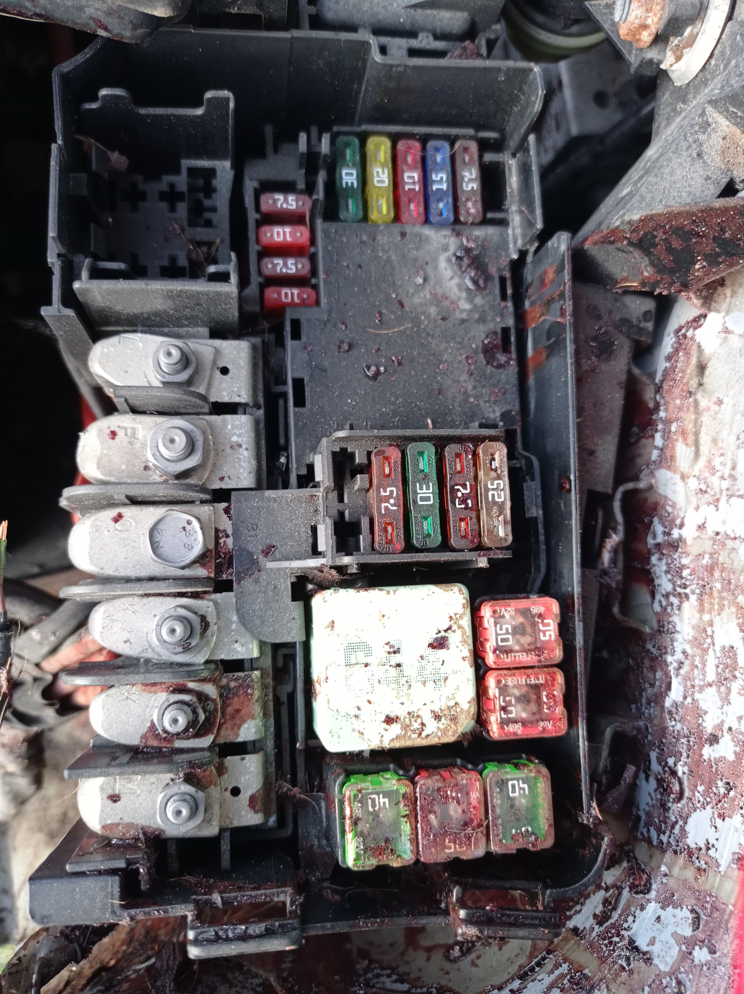

  2. I didn't remove fuses, I tested the small metal part on the top part of the fuse, And yes, it was continuous bleep. Although, there was some blood inside.
  3. I assume fuses are fine, since there was a beeping when connected with voltage tester

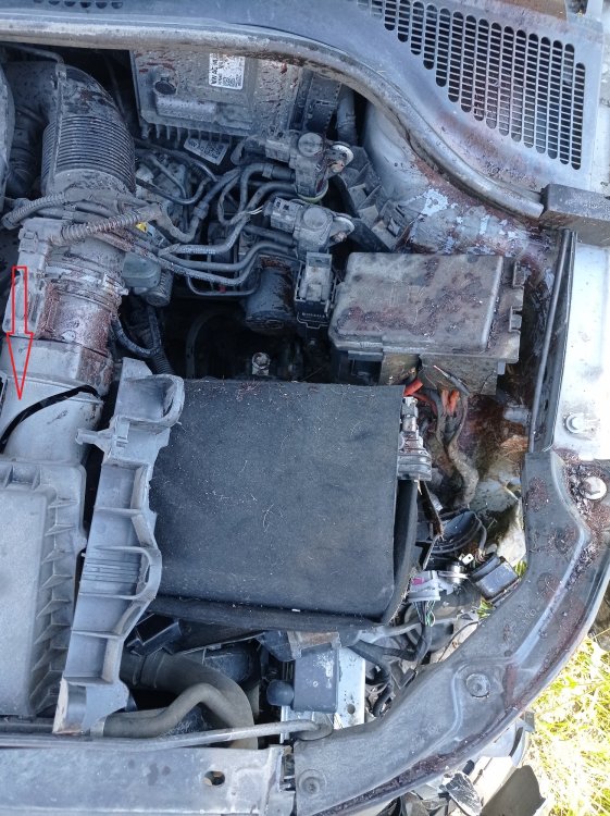

  5. Thank you for your input, sir. Uploaded additional picture of whats the situation under the hood. I also tried 2nd key, I did OBD scan and cleared the codes but that didn't help either, scan showed this results: Fault code: P067100 Cylinder 1 Glow Plug Circuit Last occurred at: 70123 mi Details: Frequency : 1 Mileage at last occurence : 70123 mi Time at last occurence : 13:58:59 Details about fault status : The fault is active Infos about fault priority : Attention: Critical fault! We recommend an immediate service appointment with a station near you. Fault code: P067200 Cylinder 2 Glow Plug Circuit Last occurred at: 70123 mi Details: Frequency : 1 Mileage at last occurence : 70123 mi Time at last occurence : 13:58:59 Details about fault status : The fault is active Infos about fault priority : Attention: Critical fault! We recommend an immediate service appointment with a station near you. Fault code: P067300 Cylinder 3 Glow Plug Circuit Last occurred at: 70123 mi Details: Frequency : 1 Mileage at last occurence : 70123 mi Time at last occurence : 13:58:59 Details about fault status : The fault is active Infos about fault priority : Attention: Critical fault! We recommend an immediate service appointment with a station near you. Fault code: P229400 Fuel Pressure Regulator "B" Control Circuit / Open Last occurred at: 70123 mi Details: Frequency : 1 Mileage at last occurence : 70123 mi Time at last occurence : 21:37:34 Details about fault status : The fault is active Infos about fault priority : Attention: Critical fault! We recommend an immediate service appointment with a station near you. Fault code: P009000 Fuel Pressure Regulator "A" Control Circuit / Open Last occurred at: 70123 mi Jul 16 2022 Issues (4) Engine Fault code: U112300 Databus error value received Fault code: P164E00 Oil pressure regulation valve Electrical error Last occurred at: 70123 mi Details: Frequency : 1 Mileage at last occurence : 70123 mi Time at last occurence : 21:37:34 Details about fault status : The fault is active Infos about fault priority : Attention: Critical fault! We recommend an immediate service appointment with a station near you. Fault code: P200800 Intake Manifold Runner Bank 1 Control Circuit / Open Last occurred at: 70123 mi Details: Frequency : 1 Mileage at last occurence : 70123 mi Time at last occurence : 21:37:34 Details about fault status : The fault is active Infos about fault priority : Attention: Critical fault! We recommend an immediate service appointment with a station near you. Fault code: P004500 Turbocharger / Supercharger Boost Control Solenoid "A" Circuit / Open Last occurred at: 70123 mi Details: Frequency : 1 Mileage at last occurence : 70123 mi Time at last occurence : 21:37:34 Details about fault status : The fault is active Infos about fault priority : Attention: Critical fault! We recommend an immediate service appointment with a station near you. Fault code: P16C100 Heater support pump Open circuit Last occurred at: 70123 mi Details: Frequency : 2 Mileage at last occurence : 70123 mi Time at last occurence : 21:37:34 Details about fault status : The fault is active Infos about fault priority : Attention: Critical fault! We recommend an immediate service appointment with a station near you. Fault code: P023A00 Charge Air Cooler Coolant Pump Control Circuit / Open Last occurred at: 70123 mi Details: Frequency : 2 Mileage at last occurence : 70123 mi Time at last occurence : 21:37:34 Details about fault status : The fault is active Infos about fault priority : Attention: Critical fault! We recommend an immediate service appointment with a station near you. Fault code: P199E00 Cylinder head coolant valve Open circuit Last occurred at: 70123 mi Details: Frequency : 2 Mileage at last occurence : 70123 mi Time at last occurence : 21:37:34 Details about fault status : The fault is active Infos about fault priority : Attention: Critical fault! We recommend an immediate service appointment with a station near you. Fault code: P199D00 Cylinder head coolant valve Short circuit to ground Last occurred at: 70123 mi Details: Frequency : 1 Mileage at last occurence : 70123 mi Date at last occurence : 00.01.2000 Time at last occurence : 00:00:00 Details about fault status : The fault is active Infos about fault priority : Attention: Critical fault! We recommend an immediate service appointment with a station near you. Fault code: U140000 HydraulicSupplyUndervoltage Last occurred at: 70123 mi Details: Frequency : 2 Unlearning Counter : 132 Mileage at last occurence : 70123 mi Time at last occurence : 23:15:12 Details about fault status : The fault is active Infos about fault priority : Attention: Critical fault! We recommend an immediate service appointment with a station near you.

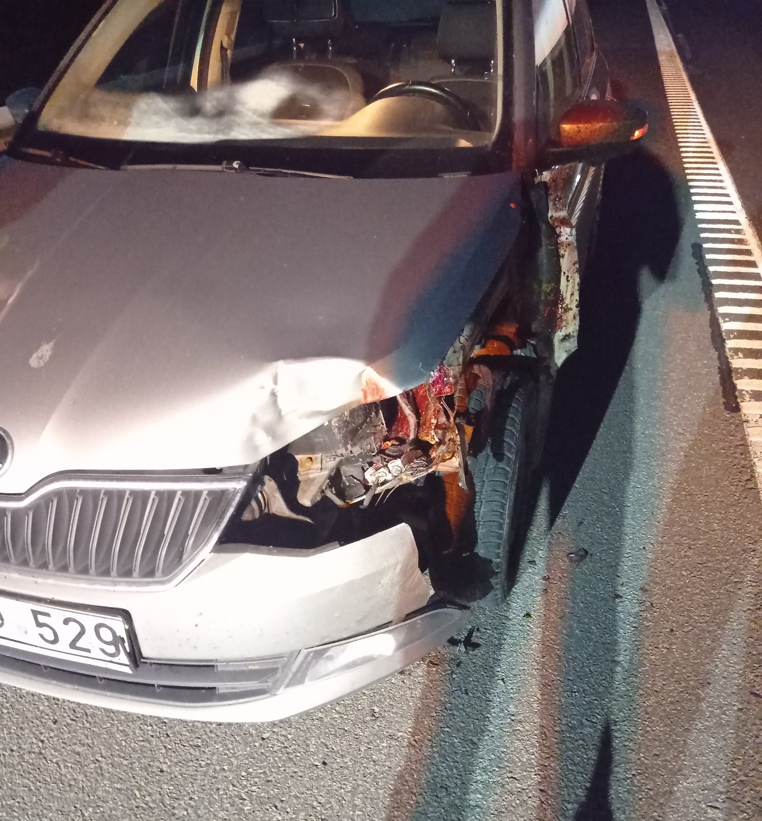

  6. Hello dear VAG friends, few hours ago my gf hit an animal, the damage is quite low from what I've seen over the years but I still need some help. After the hit the engine was fully working, but once we shut it off it wouldn't start. Starter in fully working condition and it feels like car wants to start, but it sounds like fuel is being cut off. There are no leaks or anything, the damage didn't touch internal parts which could impact the engine work. My question is mainly is there such thing as fuel cutoff for 2015 Fabia, or the data goes straight to ECU and only error code cleaning can help? I am adding the picture of the damage
