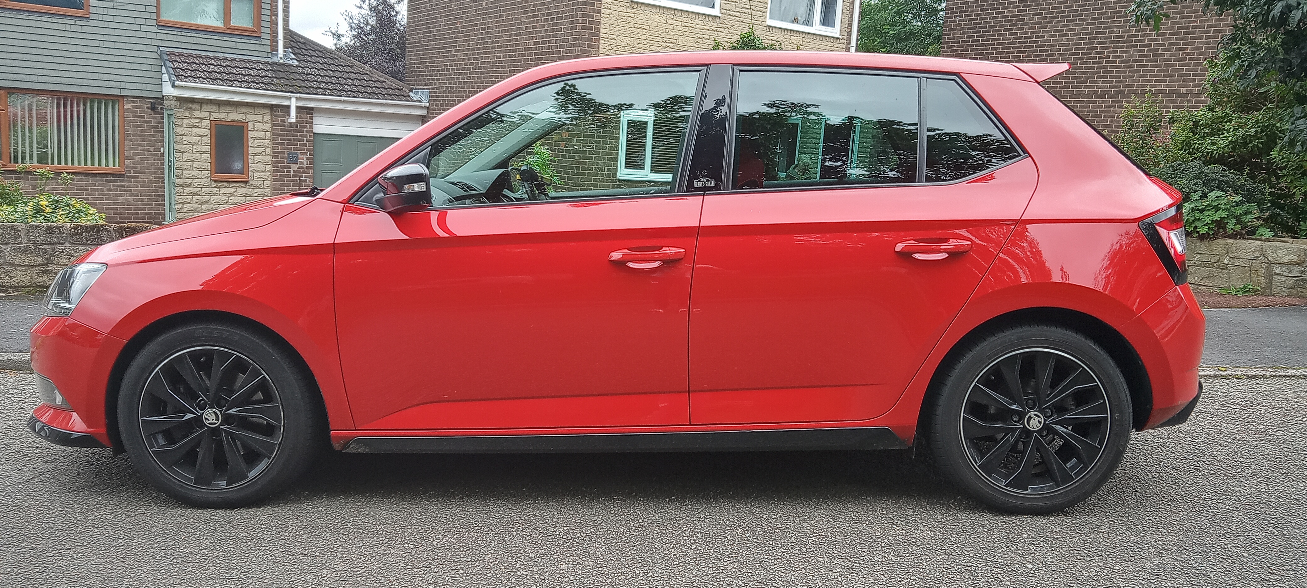

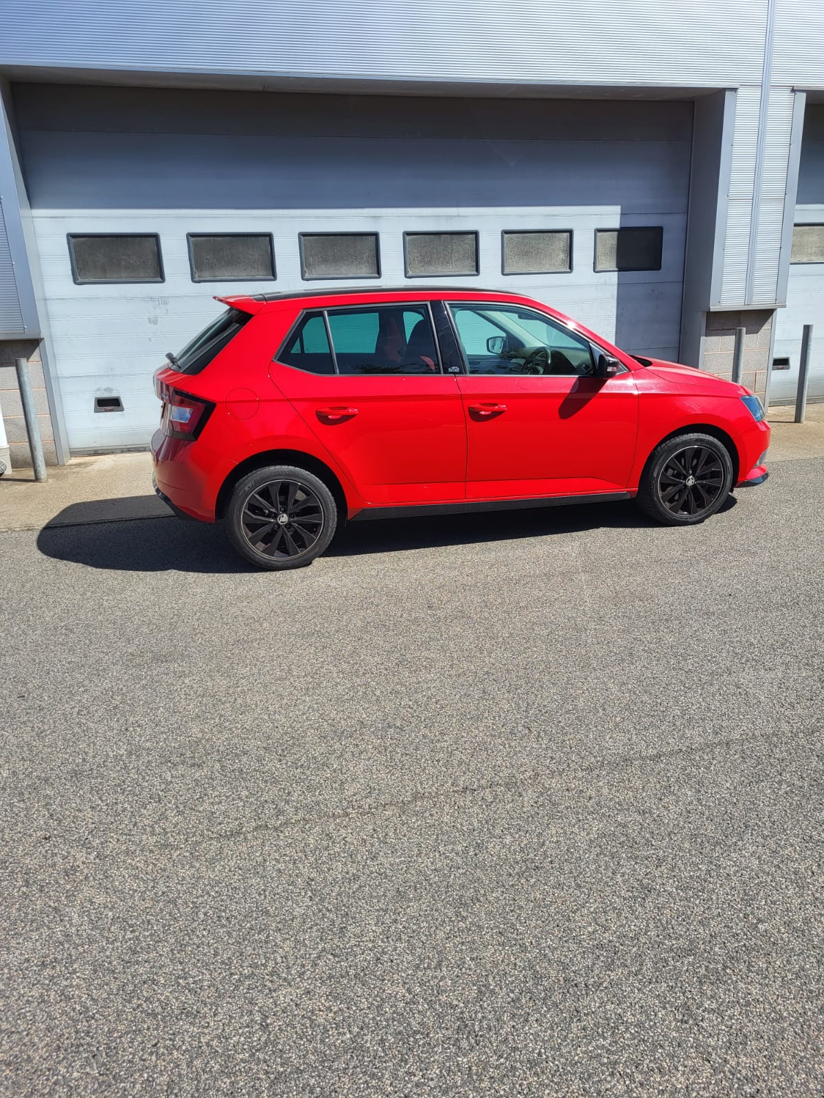

  8. Apologies for the delay.Before and after photos of my sons now lowered Monte Carlo
  9. If anyone is looking to lower their Fabia I can recommend the above. My son has a 2017 1.0 Tsi Monte Carlo and from day 1 he has banged on about lowering the car. ( In my mid 50s I'm not a great advocate of lowering cars, but I have to admit that the standard set up does look a bit high - especially the rear) . With an advisory of a weeping rear shock on his MOT a couple of months ago, this was the excuse he needed and against my better judgement, ordered the above kit at just over £300. Now fitted it has transformed the cars handling - no body roll with the only compromise being a barely noticeable deterioration in comfort over rough surfaces. My wife has a 2016 Polo GTI which has fantastic handling but drive over Cats eye and your likely to loose a tooth filling. To be honest with a 35mm drop all round, the car does look better
