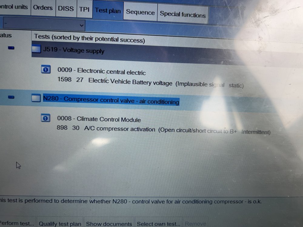

Actually the 00898 error popped up today on the official authorised dealership scanner. I have attached a pic of the scan. I thought you noticed it. Sorry

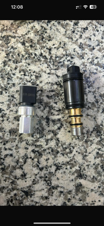

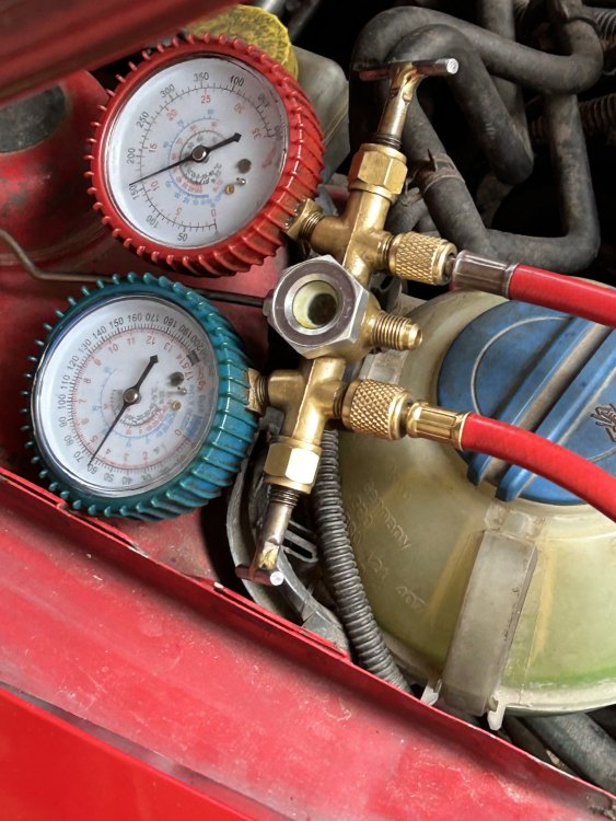

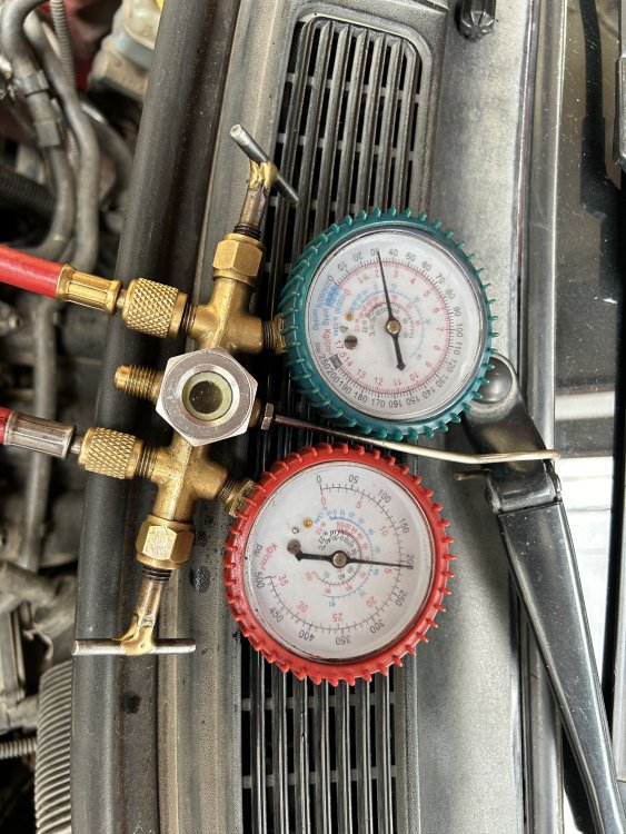

I mean i changed the high pressure valve. Sorry my bad. The high pressure switch is what I was told. I’ll attach a pic of things i changed. Have a look. yes you are right the second photo of the manifold was immediately clicked as soon as the cooling stopped(you couldn’t feel the car getting warm yet, it will take some time) if i waited further in sure the compressor wouldn’t start again and the gauge reading would change.

Hey @Breezy_Pete, it will still take a week for my generic kkl cable vag com to arrive from china. meanwhile I took my car to the authorised dealership to run some test and this is the test that came out, i have attached it with this post. i have also attached the before cooling goes off and after cooling goes off low and high pressure on the manifold. Have a look. Thanks
