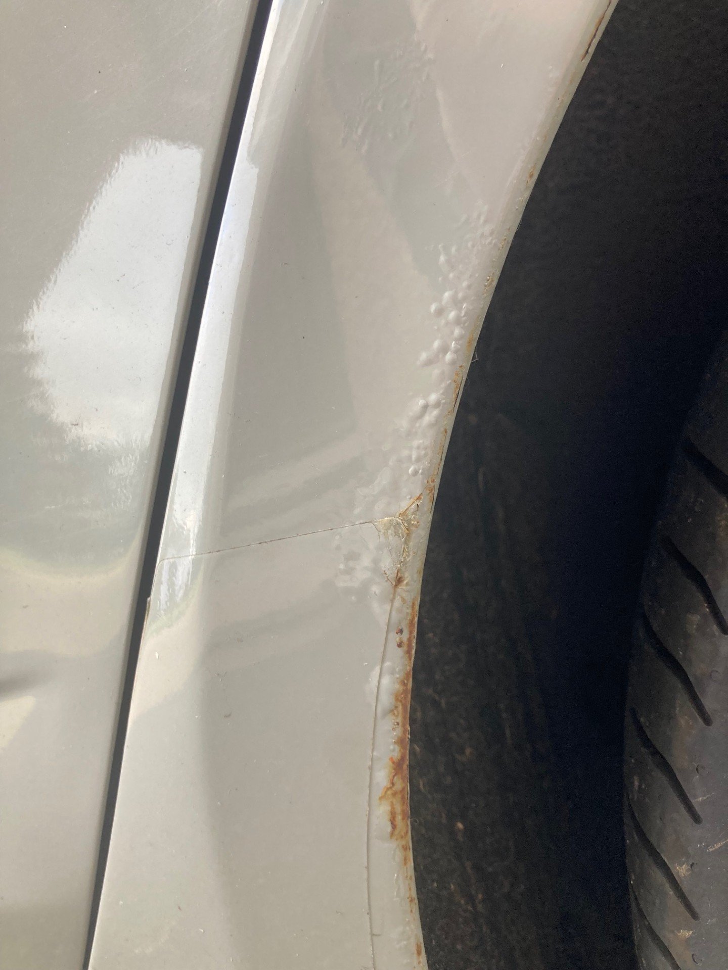

  1. Hi folks, just wondering if anyone could give a ballpark figure on sorting some minor wheel arch rust that Ive noticed on rear left side as per pic attached. The car is a Mk3 Octavia - are they prone to this? It doesnt seem bad - arch still seems sound enough its just more like starting to bubble up through the paint. I know I can get a quote from body repair - just looking a ballpark figure to know if what I'm being quoted is reasonable. So any help much appreciated Cheers
