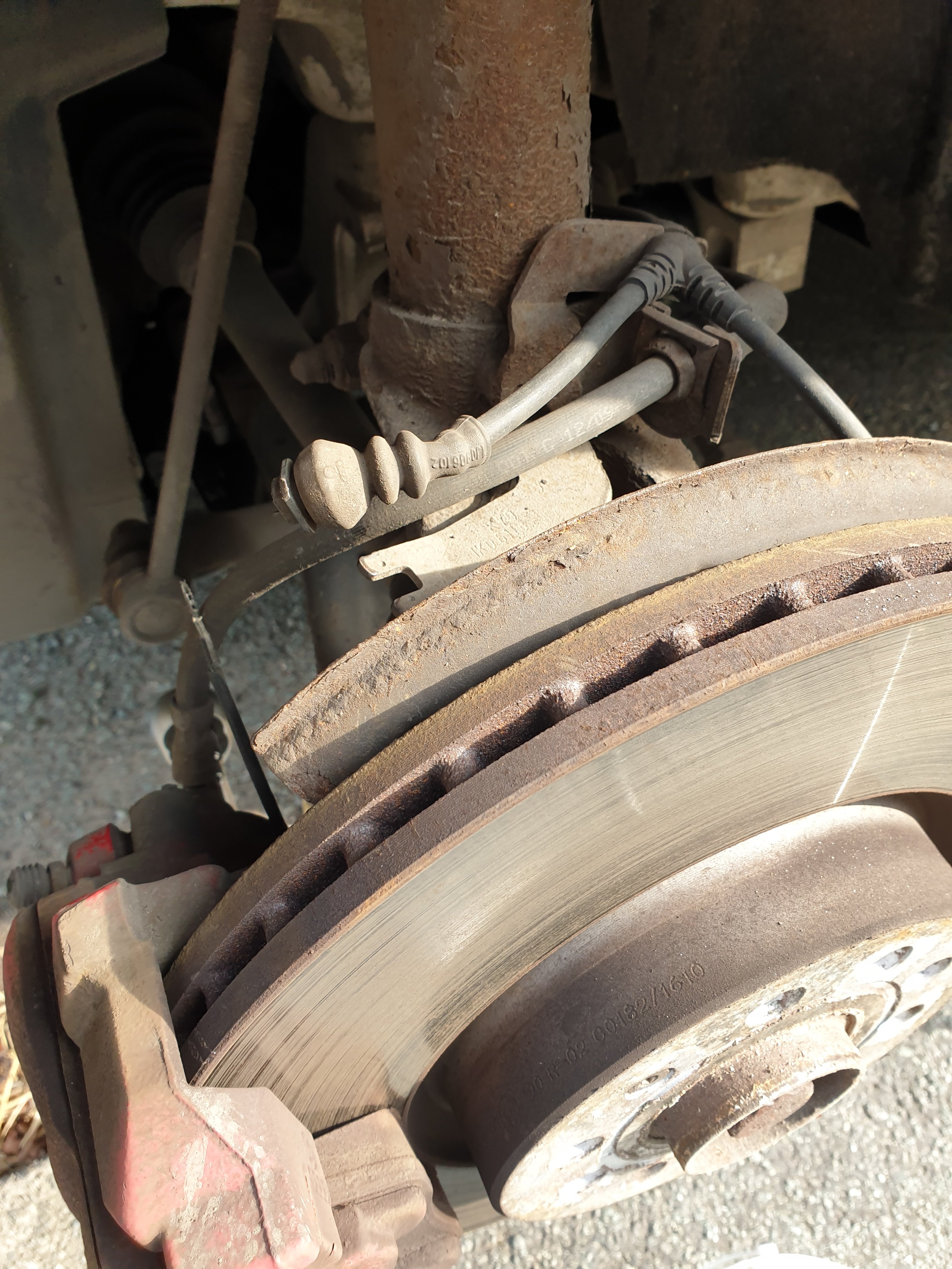

  12. Yeah, it's only on the left inner pad. I was surprised to see so much meat left on the pad, I'm pretty sure they've been on well over a year (though I might be mistaken). My last car (a Citroen) ate pads like digestive biscuits. Thanks to both for your replies.
  13. So if I just connect the ends of what's left of the cable together then I'm good? Thanks, sounds like an easy fix. The old pads had the sensor fitted and connected, I did them a while ago. You can't really tell from the photo but there is still a trailing lead coming from the inner pad but the plug and socket are missing. I'm guessing I've driven over something that's caught it at some point.
