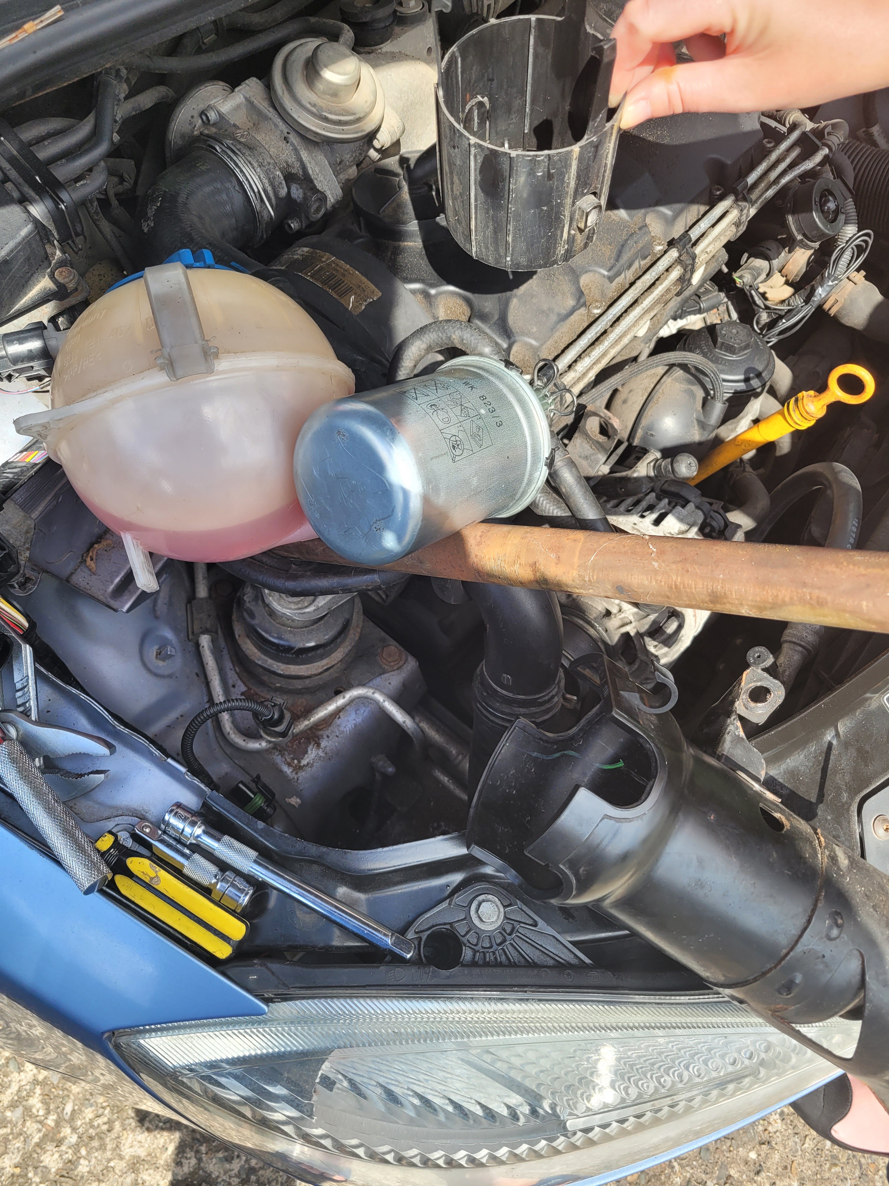

  1. Yes did it this morning. had to undo 2 nuts that held water bottle so i could release and get to the 3 bolts that held the fuel filter case and hold everything out the way with a bar rather than disconnect. Horrendous design and you will need T45 bits Thanks all for your input much appreciated
  2. Anyone know how many torque screws hold the filter case in place? i can see 2. if its just the 2 then shouldnt be too bad with an extension on my ratchet. looks like a T45?
  3. Hi Everyone, new to the group. My Roomster 3 1.9tdi has blown drivers side side light bulb. My big hands dont fit in to change the bulb. Tried most things but just cant get my hands in. Anyone else tried changing these bulbs? Easy on passenger side but fuel filter housing is in the way. Have seen 2 torque screws low down that hold the holder in place is this the way to do it? Thank you, i feel embarrassed asking about a bulb replacement but its driving me nuts!
