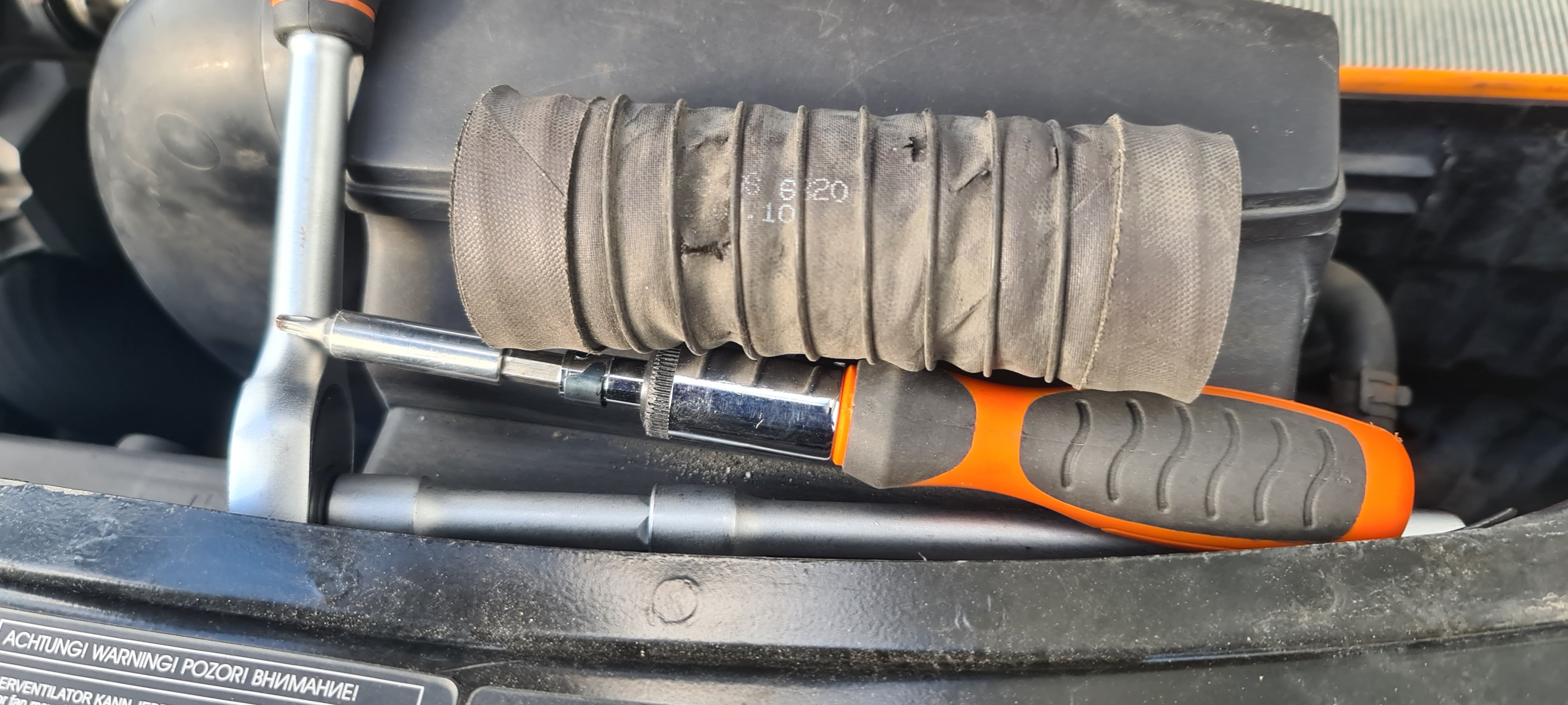

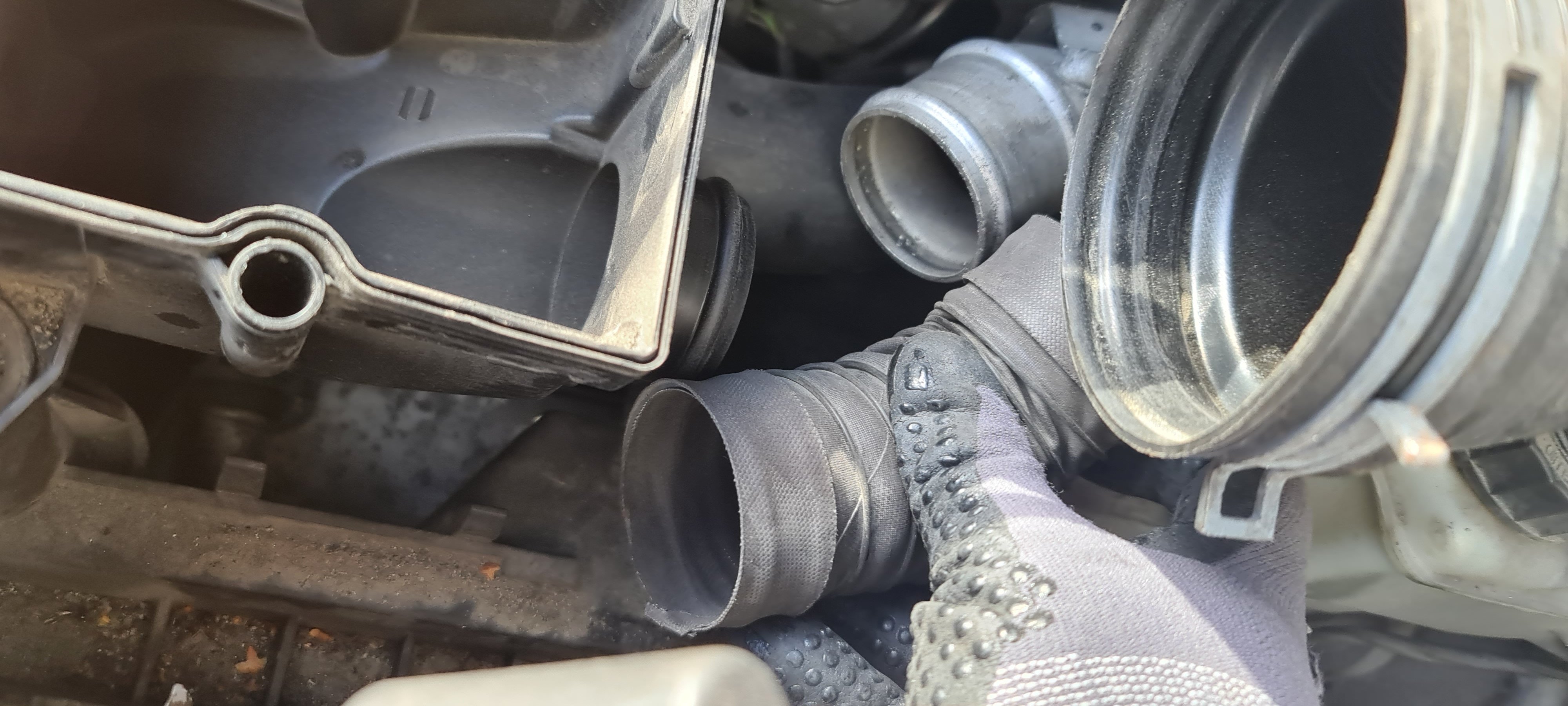

  9. So I was poking a bit around as I am changing the air filter and I noticed that this tube was damaged. I have no clue what this tube might be called and I tried browsing through the usual places where I buy parts from without any luck. Hopefully someone here can help.
