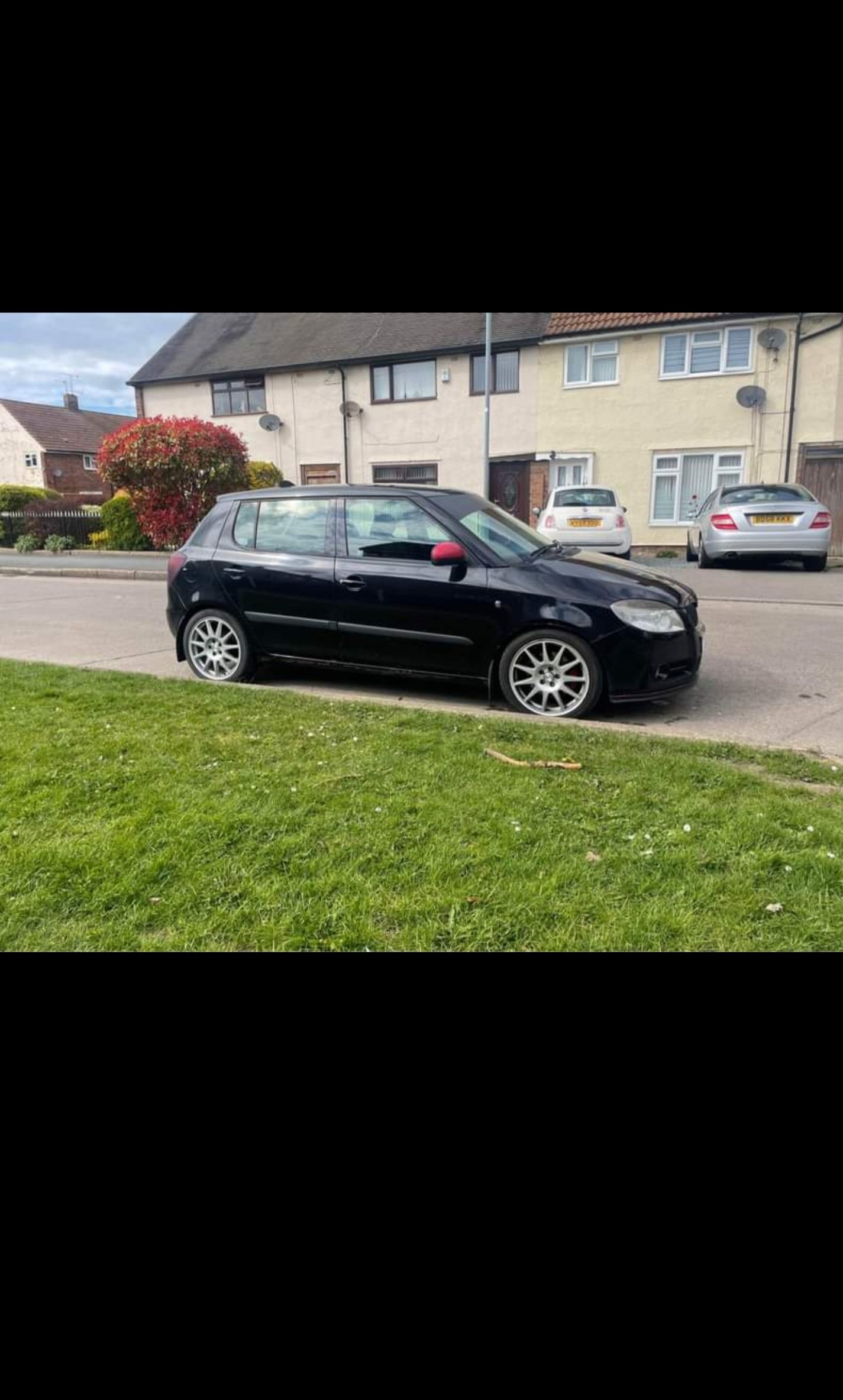

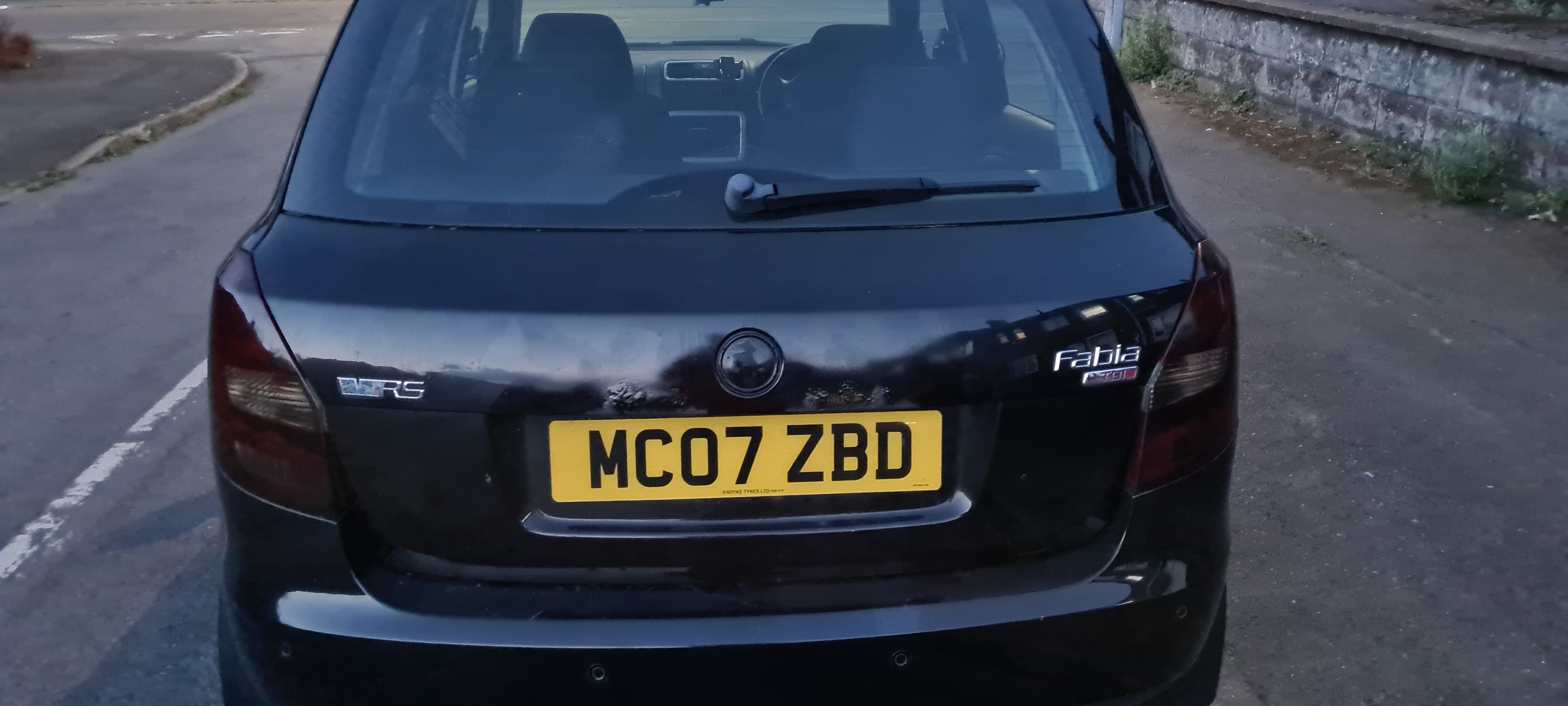

How i said up on the first post, i have the car for 2 months, and i am new into the fabia's. now i know that i don't have a vrs, and i know that i should have the engine of pd130, if i am not wrong.

is it an mk2 vrs- skoda fabia vrs 1.9 tdi stopped while driving
Hello, i have a Skoda Fabia VRS mk2 1.9 tdi, 2007, it has 116k miles, timming belt has been done at 115k with the oil change and service. I was driving the car up on the hill, and on second gear arround 2000rpm the engine stopped, i tryed to start it again but nothing happend, i can mention that after i needed someone to tow me. Aftrr 2 hours of stand-by i tryed to start it and it started for 2 seconds after died again, it will start again after 3/4 hours of not moving. I putt a tester on it but no errors showed on the screen. Can someone give me some ideas please, i have the car for 2 months and i don't know quite the history of the car. Thank you in advance. - skoda fabia vrs 1.9 tdi stopped while driving
