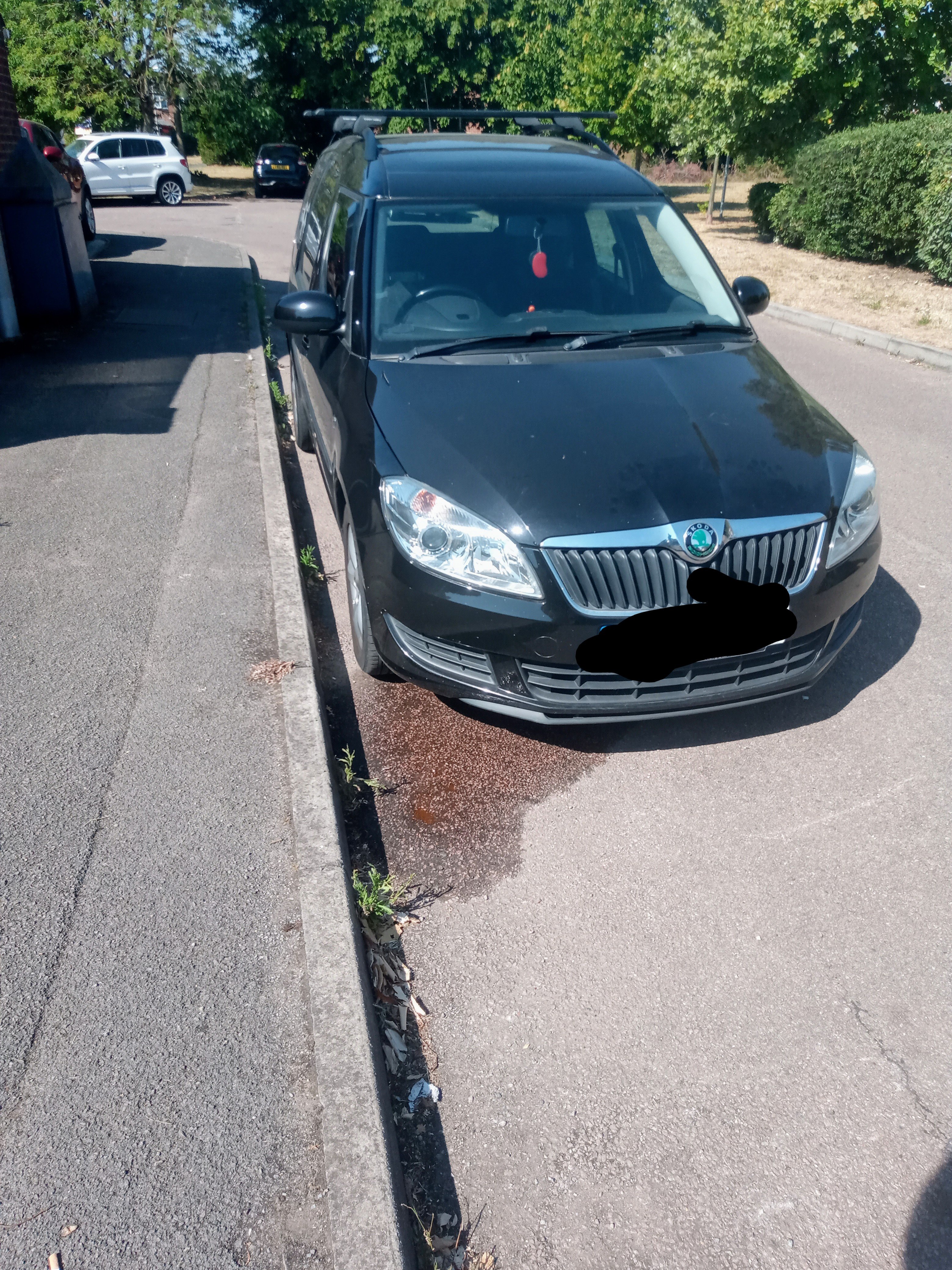

  6. So woke up this morning to this. Expansion tank fully drained.Booked in Monday at least you can see the leak. First time it has been obvious.
  7. Thanks so hard to find problem drove 60 miles the other day no issues came out next morning expansion tank empty and no leaks visible under car or engine bay.
