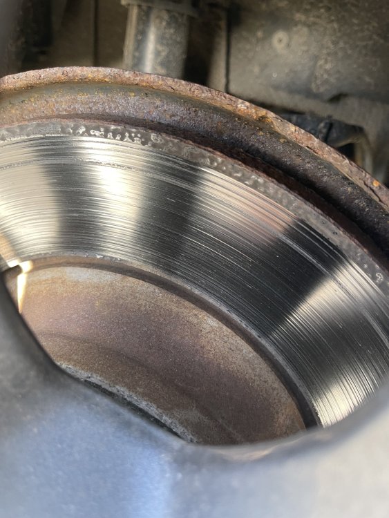

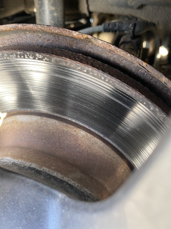

  1. Hi everyone, At my last MOT Skoda West End advised I need my rear brake discs replaced. I had the rear brake discs, pads, etc replaced 2 years ago and have since done 22k miles. I have read brake-pads-replaced-after-50k-reasonable-distance and surface-of-brake-discs-rust-quickly and people seem to suggest some of it could be down to the ACC, which I do use a lot. However, I struggle to see how a brand new set of disks would need replaced just after 2 years ... again and again! Additional information * I didn't ask for actual measurements, like everyone else I got given a % * Its a 5 year old Skoda Kodiaq with 36k miles on the clock From the MOT Nearside Rear Brake disc worn, pitted or scored, but not seriously weakened (1.1.14 (a) (ii)) Offside Rear Brake disc worn, pitted or scored, but not seriously weakened (1.1.14 (a) (ii)) Wonder what to do now? Chance it for another year? or get Autohaus to have a look? The brake disc in question :
