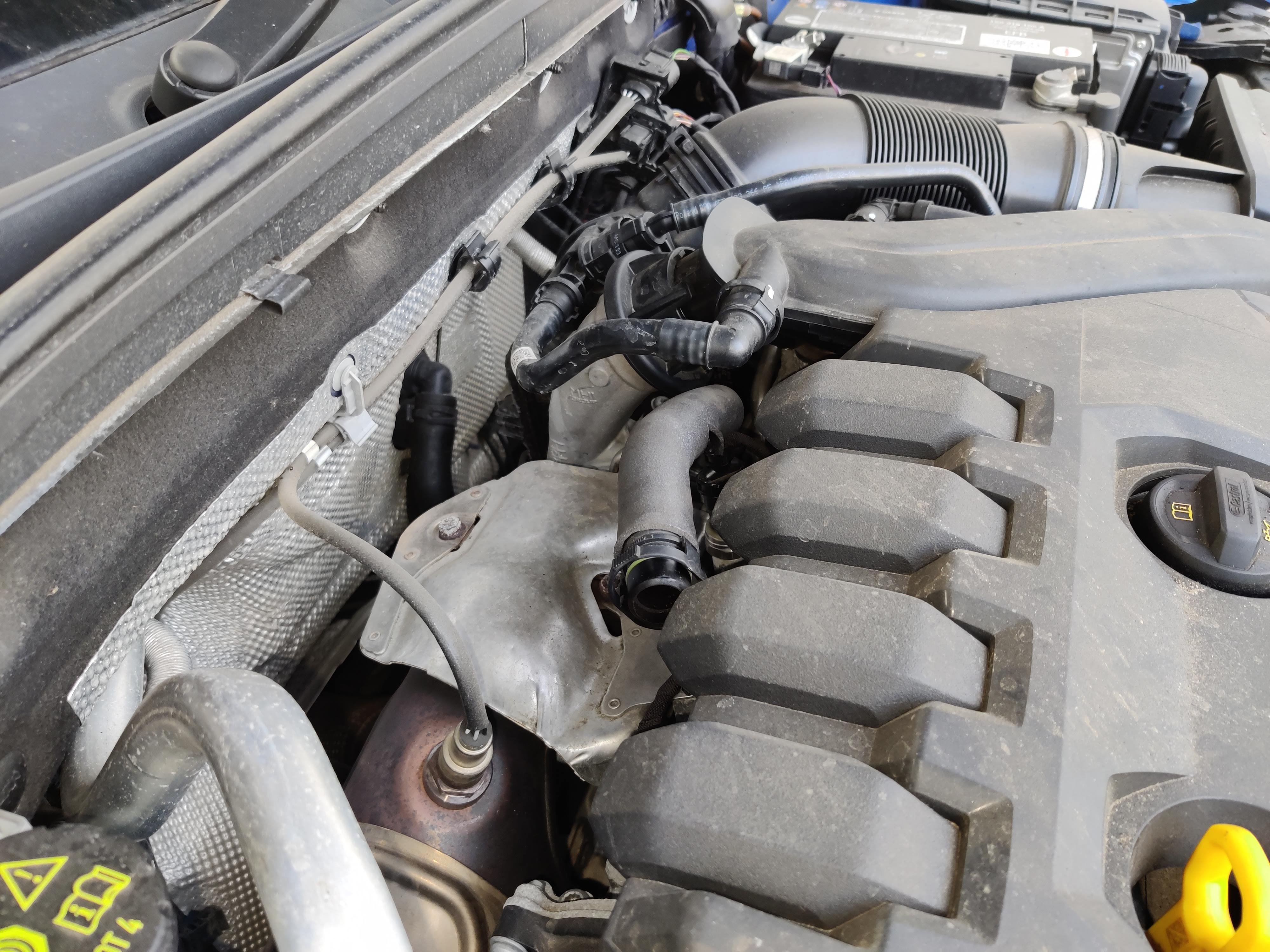

Mk3 1.5 TSI service problem
OracsRevenge replied to OracsRevenge's topic in Skoda Octavia Mk III (2013 - 2020)
Yes both were Aylesbury (Bristol Street) Skoda. I didn't take a photo with the cover off unfortunately, but I think the original photo shows all they need to know. I'll be having words tomorrow. Thanks -
Cheers for the diagrams, I've been out, removed the cover and bingo, it's the green highlighted pipe. Clipped the pipe back on and tested it, all sorted. Thanks for the help 👍 -
Hi, Just had my Octy back from a service and it's making a new turbo flutter type noise, audible in the car. I opened the bonnet and found a loose pipe. 4 weeks till Skoda Aylesbury can fit me in to look at it, just checking if this could cause the noise, and if it's easy to refit. I can't immediately see where it's supposed to go. Any help gratefull received. Thanks
