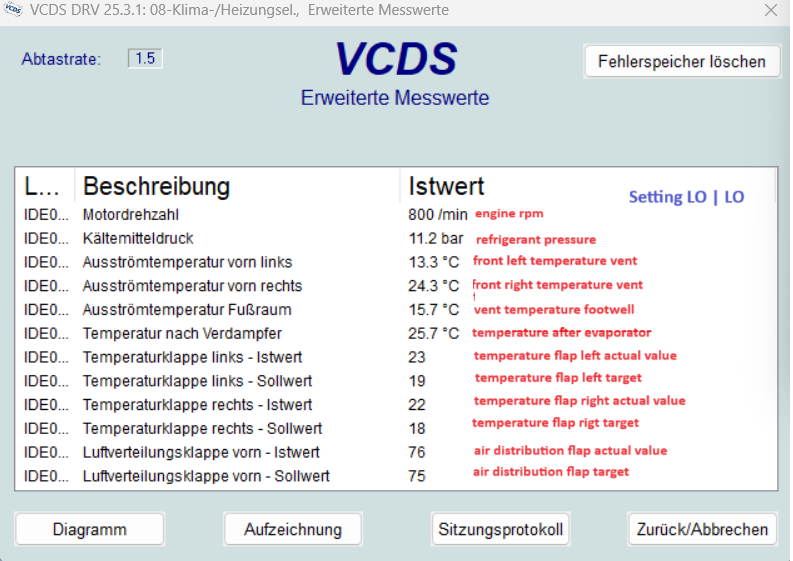

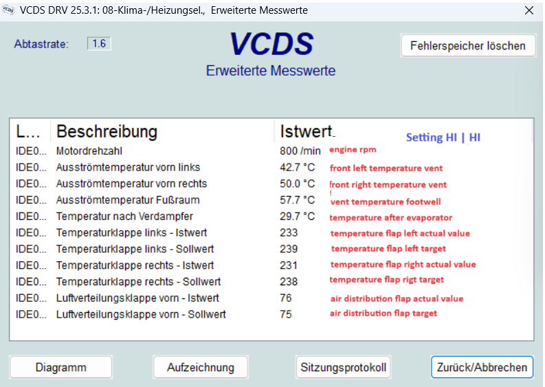

  1. Hi there, I have a Skoda Kodiaq MY2019, 2.0 TDI, 140 kW (190 HP), 4x4, DSG. The Kodiaq has a 3-zone Climatronic. Unfortunately, this is causing problems. If I set both sides at the front to “LO,” only the driver's side gets cold. The passenger side stays warm. The air conditioning does not work here. If I set both sides at the front to “Hi,” both sides get warm. I also noticed that when I start the car, I always hear a brief “metallic noise” from the ventilation system that lasts a few seconds and then disappears. VCDS does not report any errors with the Climatronic. I tried to output some parameters, but I don't see any errors. Does anyone have any idea what the problem could be? Many thanks in advance.
