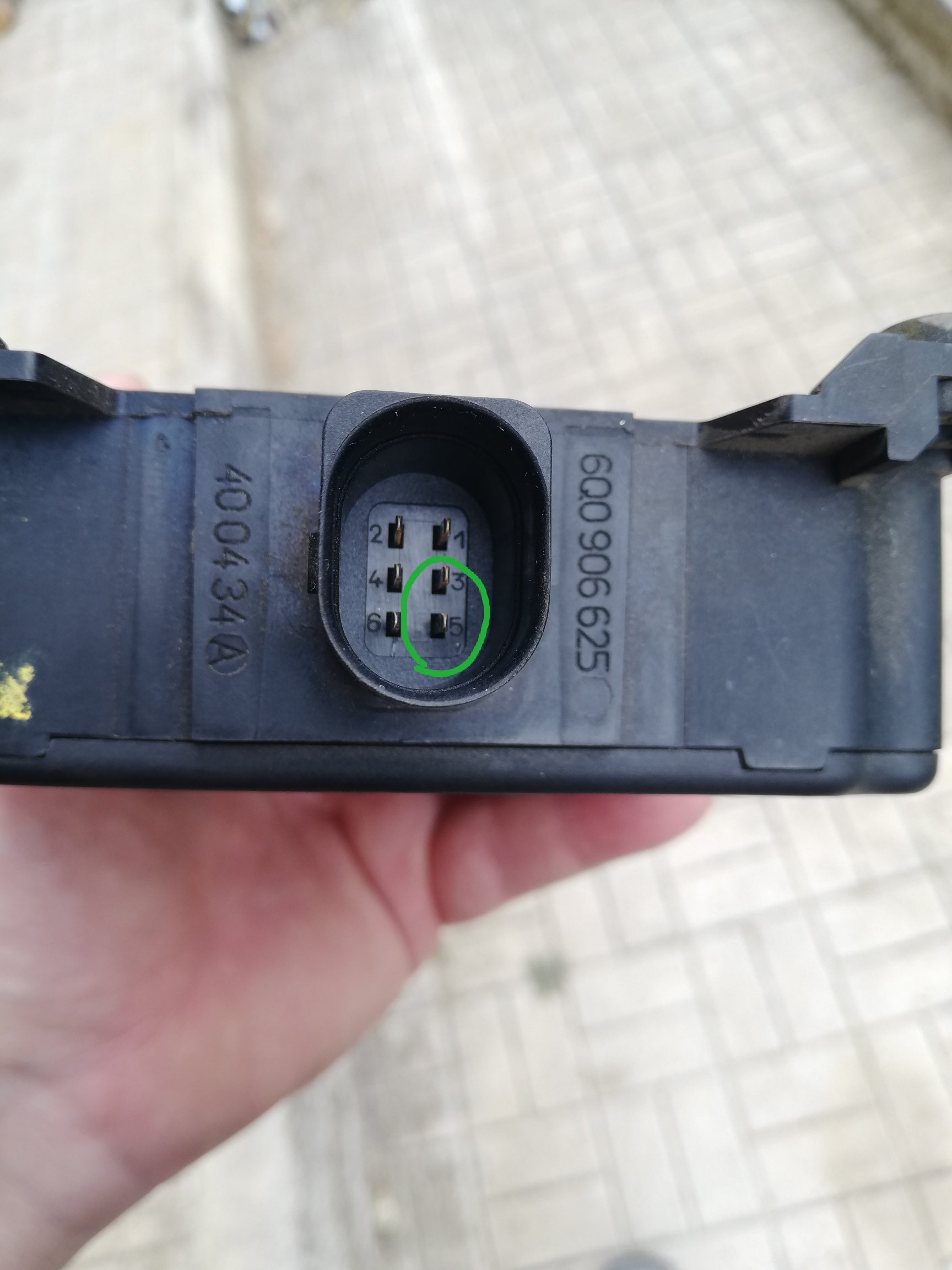

  2. Unfortunately I have to rely on the Google translation, which I realized was not accurate. I post a photo, so as to better understand what I'm talking about.
  3. Yes, I've already checked. N18 EGR 16.5Ohm (14-20 Ohm on manual) value within limits. N239 flap 31.3Ohm (25-45 Ohm on the manual) value within the limits. N75 16.5Ohm (25-45 Ohm on the manual) value below the limits. I have noticed that often the n75 sometimes does not immediately discharge the pressure as it should, and this I think is another possible symptom of a faulty n75. do you think?
  4. Hello guys, I wanted to ask for your cooperation.On the vacuum valve block of my Fabia Rs Tdi I measured the resistance of pins 3-5.The resistance measures 16.5 Ohm but, from the workshop manual, it appears that the value should be more Since I have a strange defect not always present (identified in diagnostic with P1592), it could be the n75 in the valve block that is faulty but I don't have a new block that I can measure to understand if the measured resistance is actually wrong. of you has the possibility to measure this resistance on the valve block?
