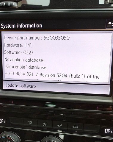

  2. Will search for the firmware from other forums and if unsuccessful will just buy a new head or sell the carπŸ€₯. I love my music. Thanks for everything @varooom you've really enlightened my on VW stuff

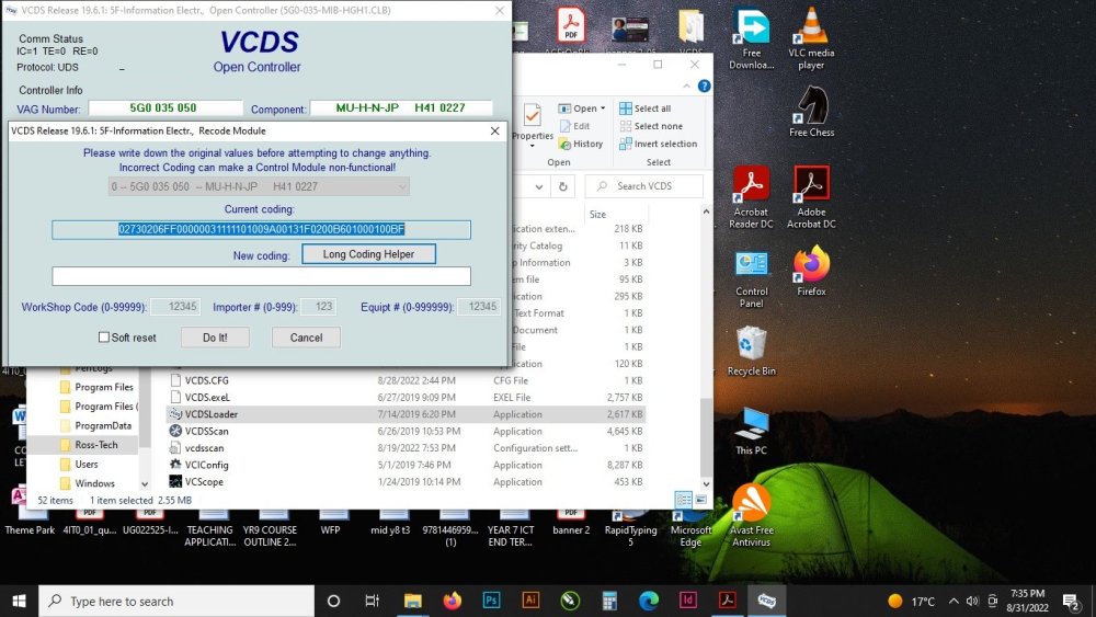

  6. Have done so on VCDS forum right but I am just a layman with coding. Getting help there currently and hope all goes well
  7. Appreciated bro, will try harder on coding to restore sound

  9. Hi My VW Golf 2014 MIB1 infortainment (attached part no.) only has sound in the morning when the car starts but after switch off engine and remove key when I start the car any other time in the day no sound but working well and buttons functioning. The VCDS error code generated attached, have tried long coding on the module but not helping, anyone with ideas will appreciate
  10. I really appreciate you going out of your way to assist. I think both or one would solve my sound issue since in the morning when i start the car the radio has sound but in i switch the engine off the the infortainment don't have sound. Kindly share I try the update since In Kenya and not using Navigation. Thank you

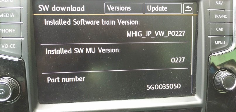

  11. Any way to update using alternative? My infortainment unit loses sound and think it's bugs in the firmware

  13. Hi. Any firmware update file for 5G0 035 050 MIB1 unit? Installed software train: MHIG_JP_VW_P0227. Been referred here and I am sure will get help I have a VW MK7 2014 Golf variant, thanks
