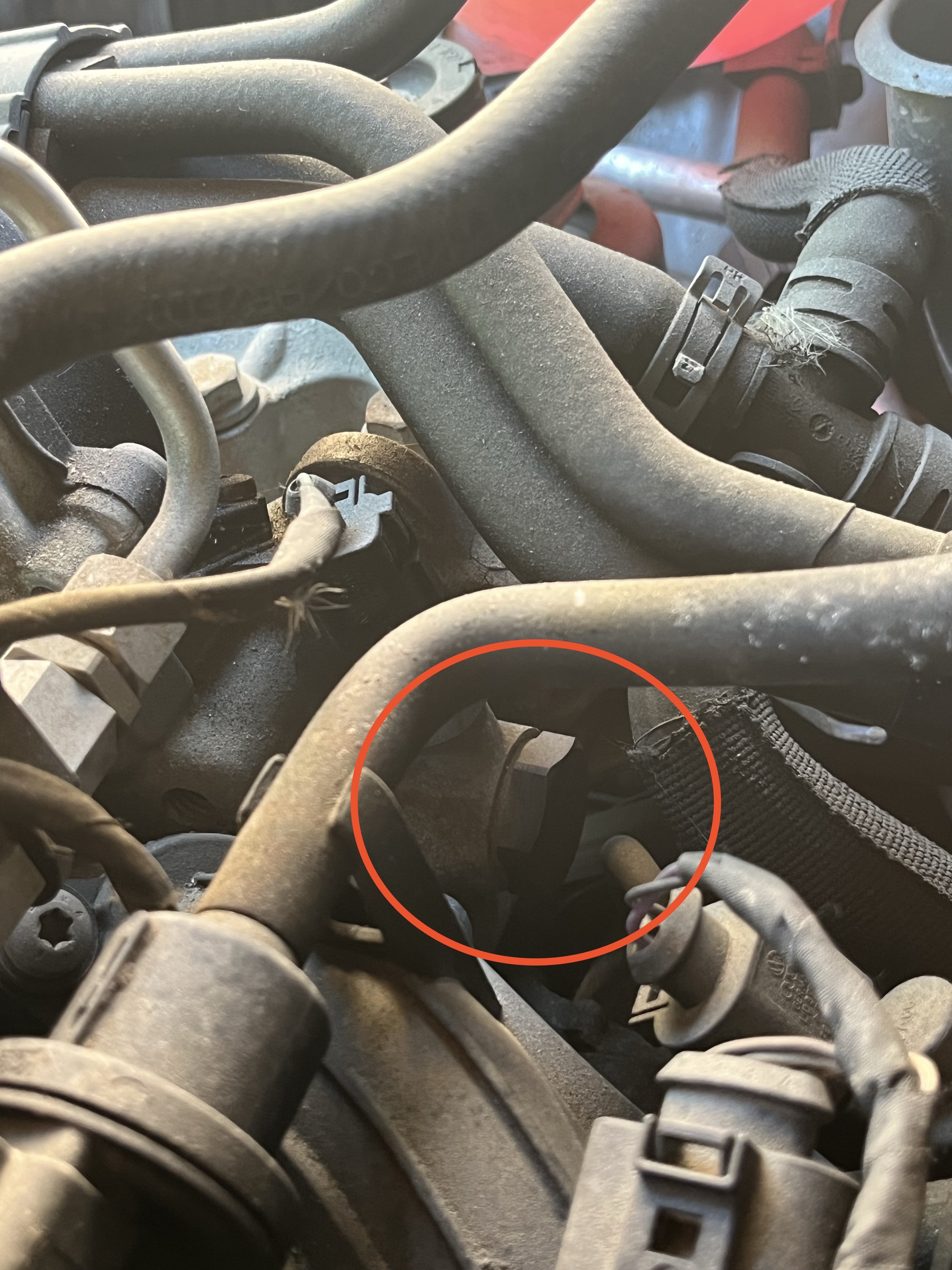

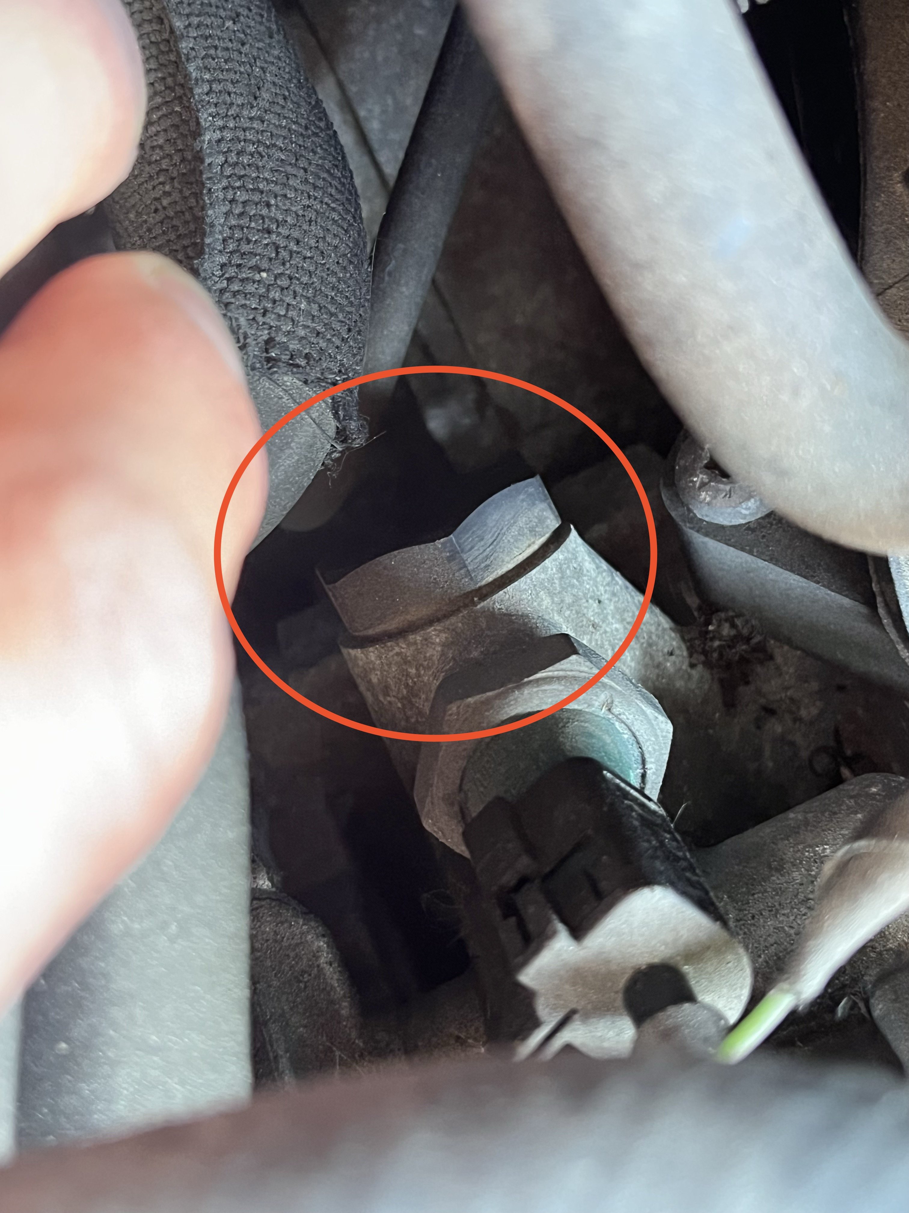

I think I found it :) This is it right? Do I have to take any precautions, or make any preparations before unscrewing the old tensioner? Or should I just unscrew it, from a cold engine, and put the new one in?
