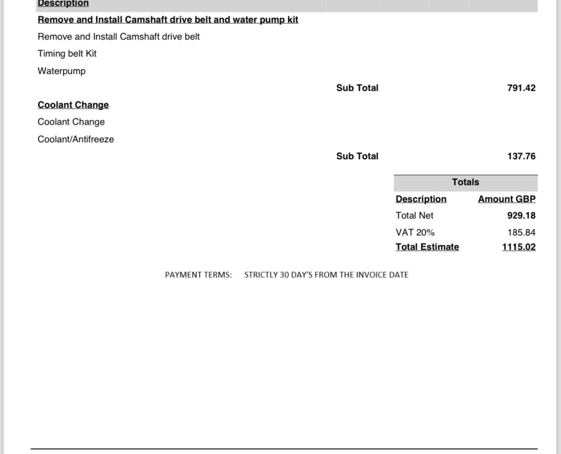

  1. Been quoted nearly £1200 from my local Indy garage to change the belt and water pump on my 2019 1.6 tdi SE tech. 89000 mls. last time I had this work carried out was in. 1.6tdi seat Toledo, which only cost £400. wtf edit: my local Stealer quotes £1027.36
