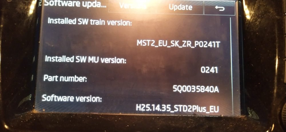

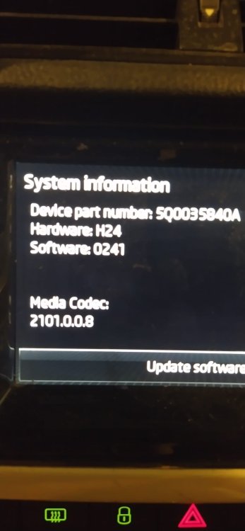

  4. Hey @pab567, @RomanB & @varooom, I've been recently following this thread and noticed you guys are the leading experts in the matter. I tried updating my Skoda Fabia 2015 Bolero system by Technisat. I'm corrently running the following: If i understood correctly the latest firmware for my system is the 253? I've downloaded it from the "mibsolution" link @RomanB provided and extracted it into a usb thumbdrive, which was formated to fat32. As I go to update through the "service menue" I encounter the following error: "Error file access Code 15 Cannot find the correct medium" Could any of you assist me as of what is going wrong and how to do it correctly? I've tried 2 different USBs and also the older version 245 & 252 with the same error occuring. Any assistance would be very appreciated. Thanks in advance!
