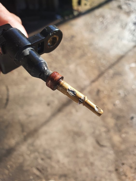

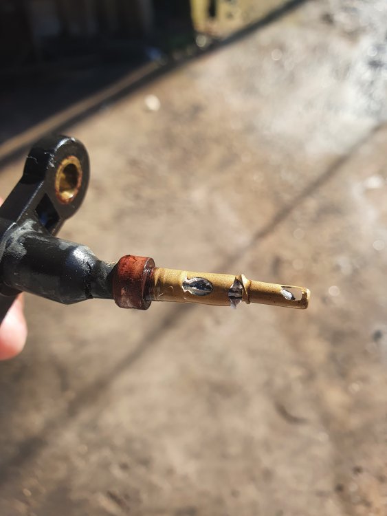

  5. Sorry that picture is from a month ago when I replaced the part. So that sensor in the pic was on the car for 9 months. Not sure how the current sensor is looking on the car but I know its gone as my temperature gauge on the dash is going zero to 90 and all over the place. Wanted to know what I can do to fix it properly so I don't need to replace it anymore
  6. I've had the car for 5 years now. I have never used any flush. Just topped it up with the pink solution mixed with water and I'm putting parts from GSF part or EuroCarParts etc so I don't think they are genuine
  7. Hi thanks Its the Coolant temperature sensor I've attached the pics so u can see the corrosion. I have changed this part 5 TIMES so I know this is the culprit. But I wanted to know why is keeps going on my car and surely it shouldn't need changing every 9 months (1 month this time). I Don't think is a normal thing. When I take the sensor out the coolant does come out but shouldn't it all drain out? There is still some left in the coolant reservoir
  8. Hi, new here I had my octavia for 5 years now, no problems but always had this annoying problem. 63 plate 1.6 tdi manual mk3 Every 9 month to a year the temperature sensor goes. the dash starts showing the needle going up and down for a few days then it just reads zero. I changed it a month ago but this time it didn't last the "9 months". Its gone again. any reason why it keeps happening? Everytime I've changed it, the sensor looks corroded. And when I do take the sensor out, shouldn't all the water in the system come out? Cuz sometimes the coolant reservoir still has coolant in there. Maybe there's a blockage somewhere in the cooling system? Sorry for long post and any advice would be gratefully appreciated Thank you
