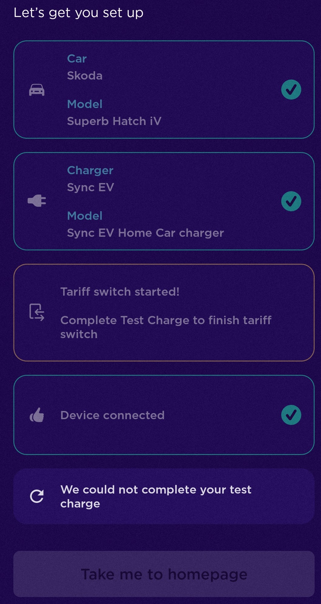

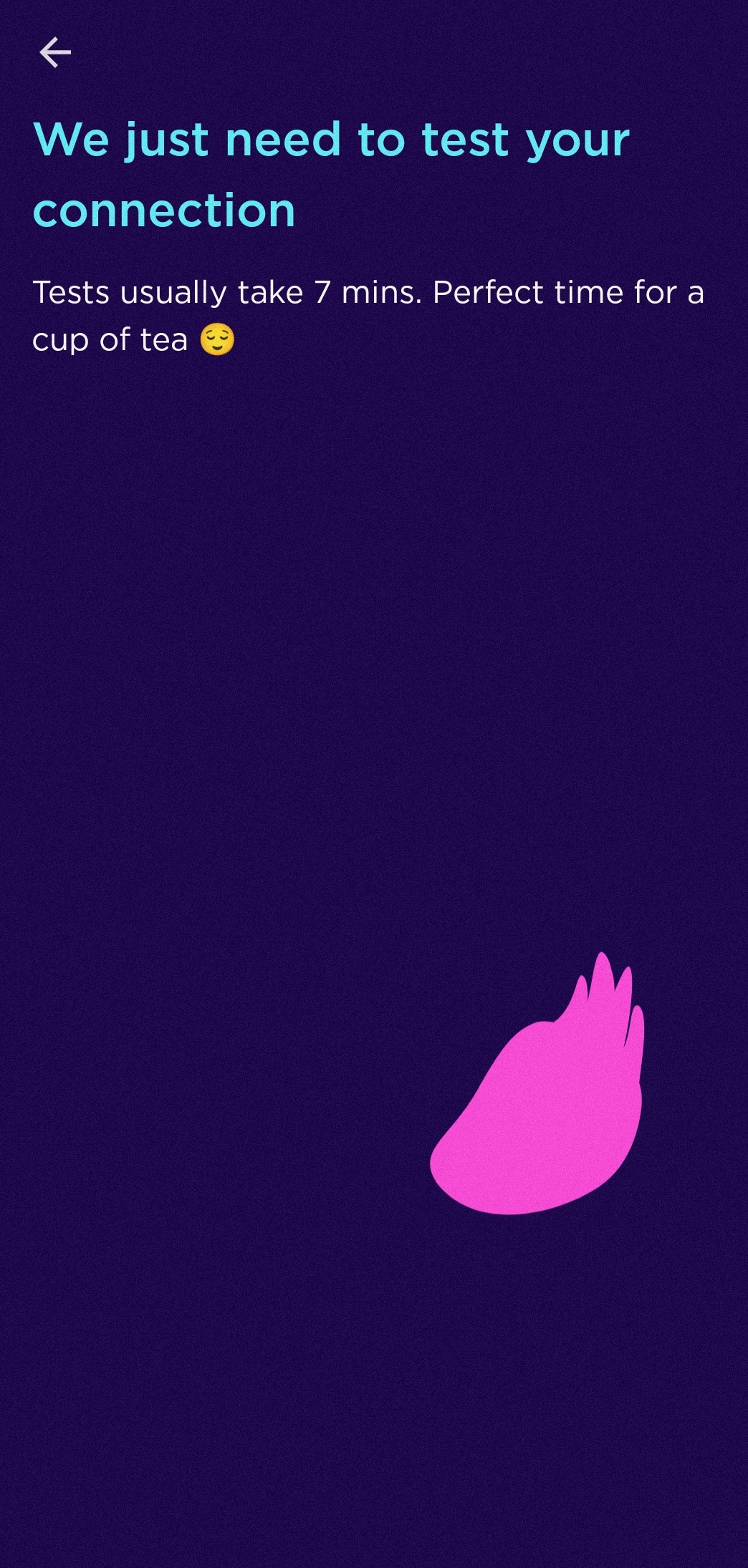

  7. Is it possible the reason I can't get it to complete the connection test is because I have a SMETS1 smart meter? Also there seems to be no way to plug my car into the SyncEV charger without it automatically starting to charge. If I stop the charge using the syncEV app it will not start charging again unless I unplug & plug the car back in. Still no word back from Octopus after a second email. I'm going to get this working if it kills me. 😁

  9. Hmmm, getting a bit further through the testing on the Octopus app but failing on the last connection test. 🙁 Intelligent Octopus is so close I can smell it. 😂😂

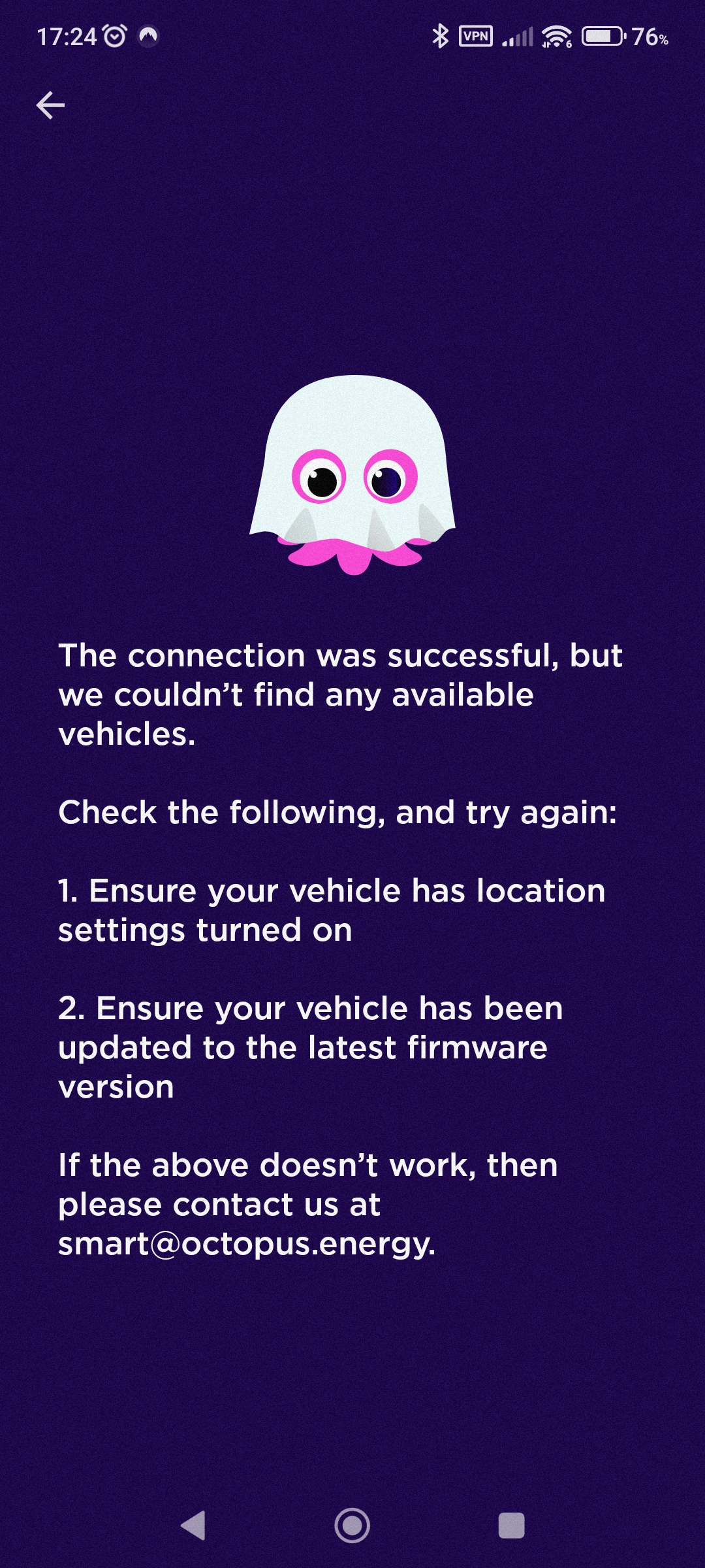

  10. I have sent an email explaining the problem to Octopus so here's hoping they get back to me with a positive resolution. It does say to make sure that the vehicle has the latest firmware. Is that an over the air update or is it something the dealer has to do?
  11. Anyone got Intelligent Octopus working with their Skoda Superb IV PHEV? I was trying to take advantage of the low overnight tariff. I have a SyncEV charger. I went through the Octopus app & it all goes through right up to the last part stating the connection was successful but couldn't find any available vehicles. Just wondering if someone has successfully got this to work? I've checked that the car location sharing as activated & that there are no updates available.

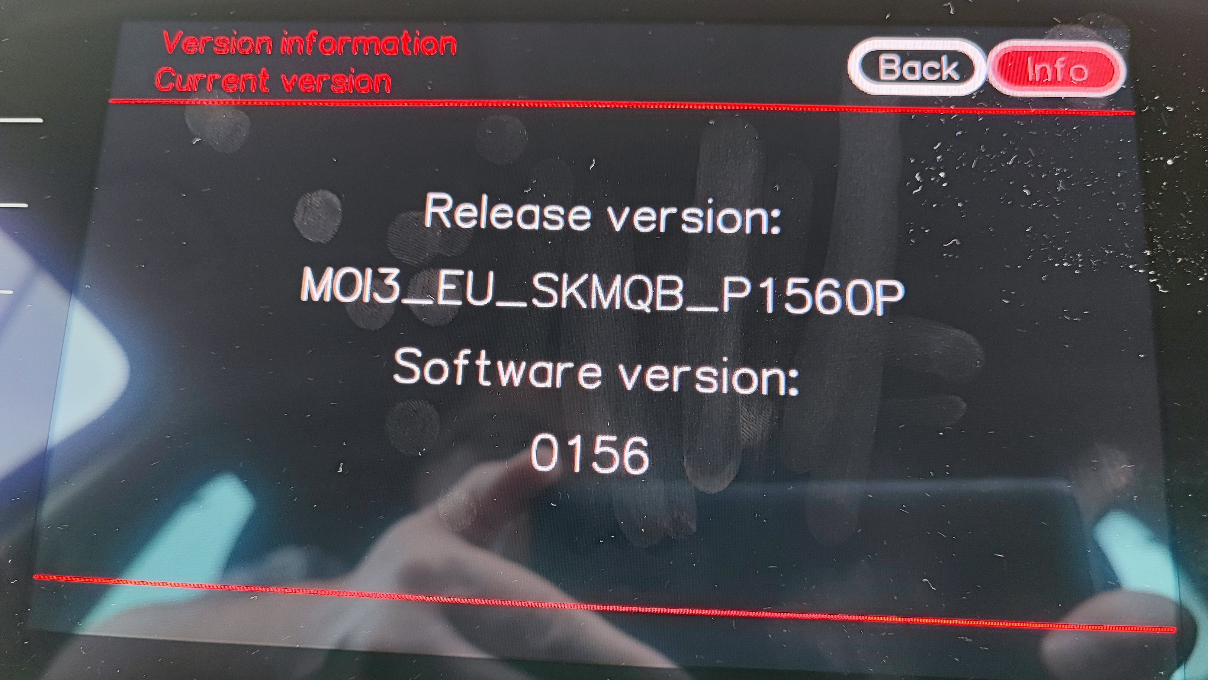

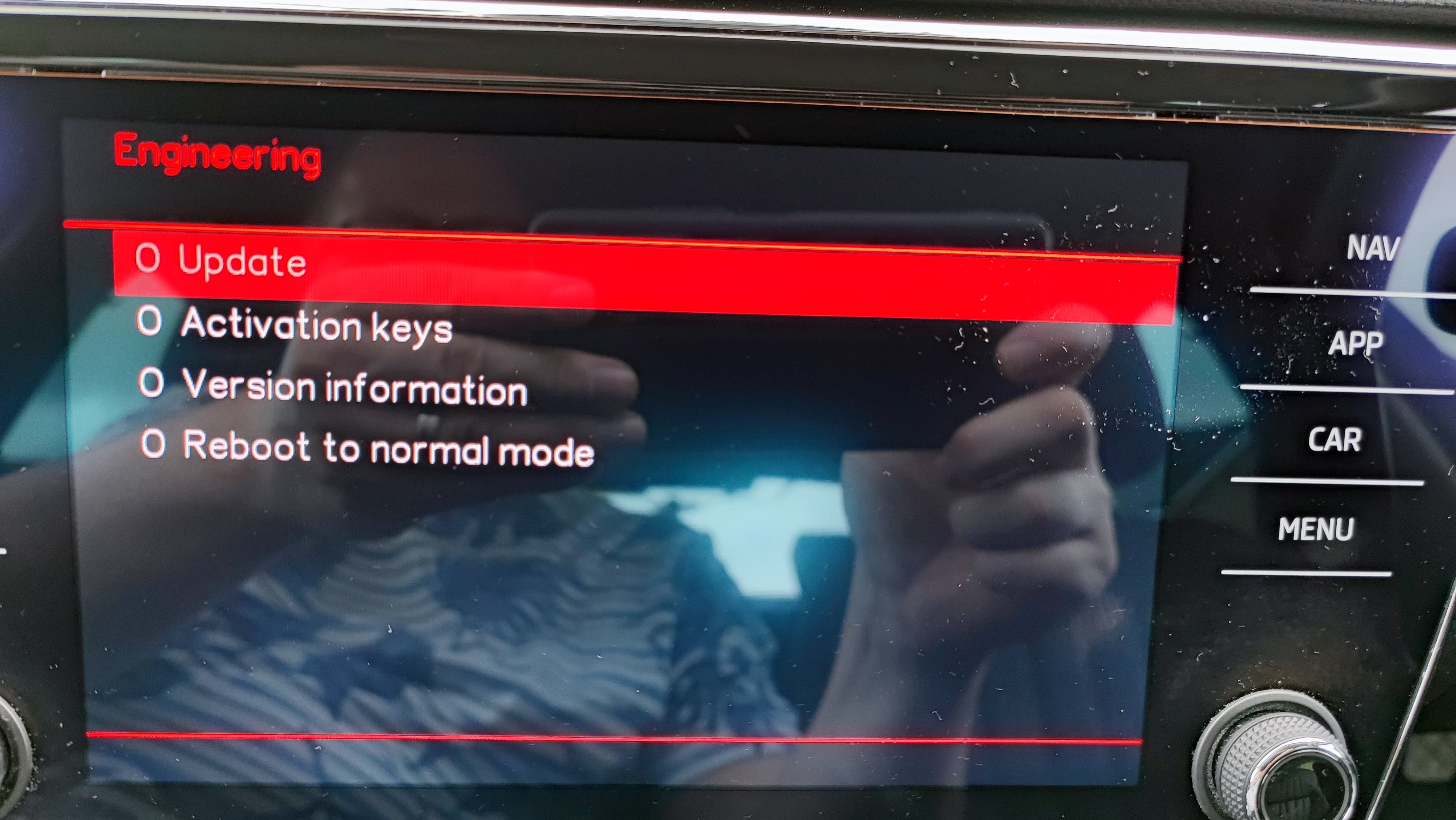

  13. Hi varoom, I've rebooted the unit & is this the software train in the attached photo? I held the menu button down & this is what came up

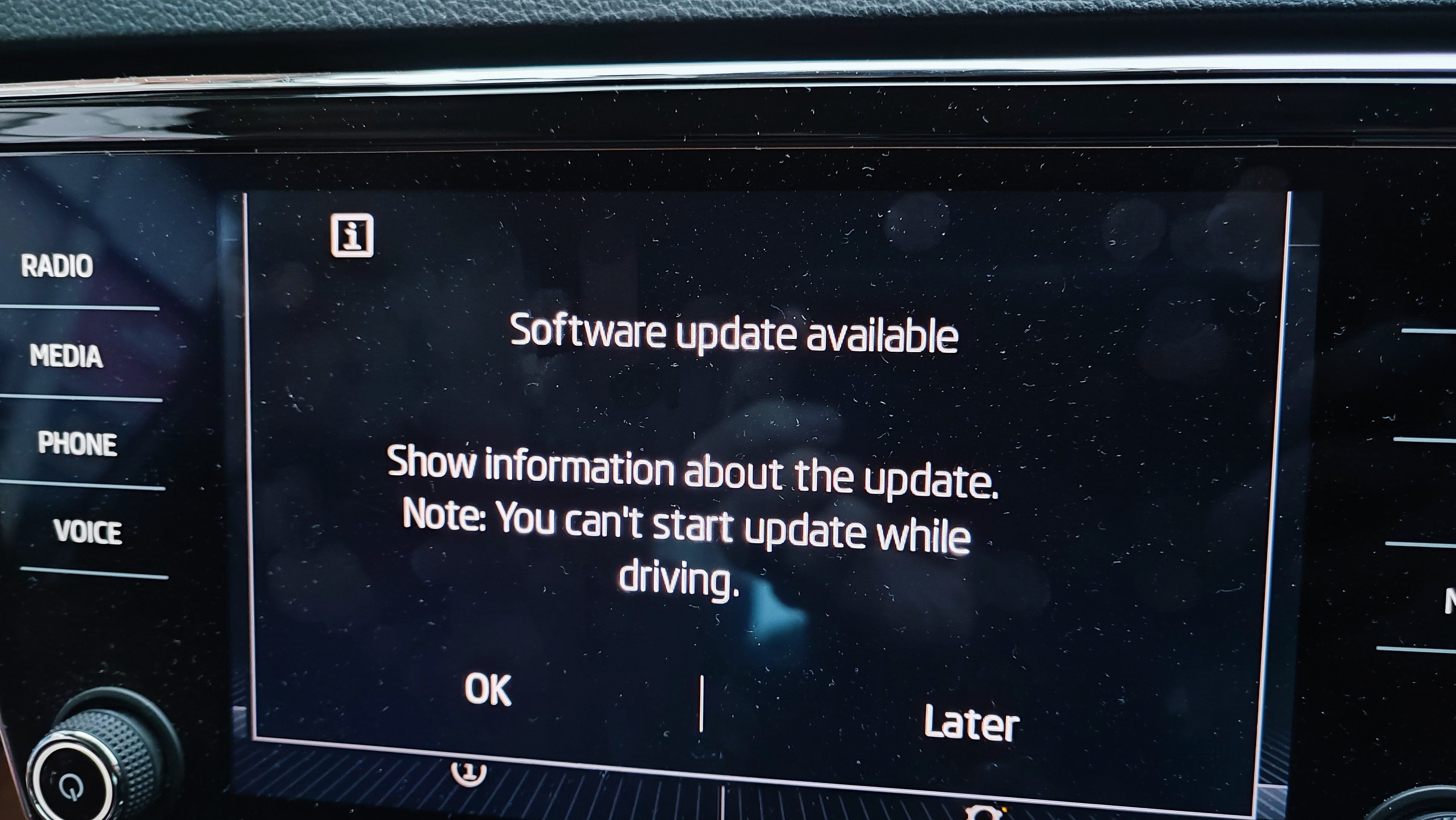

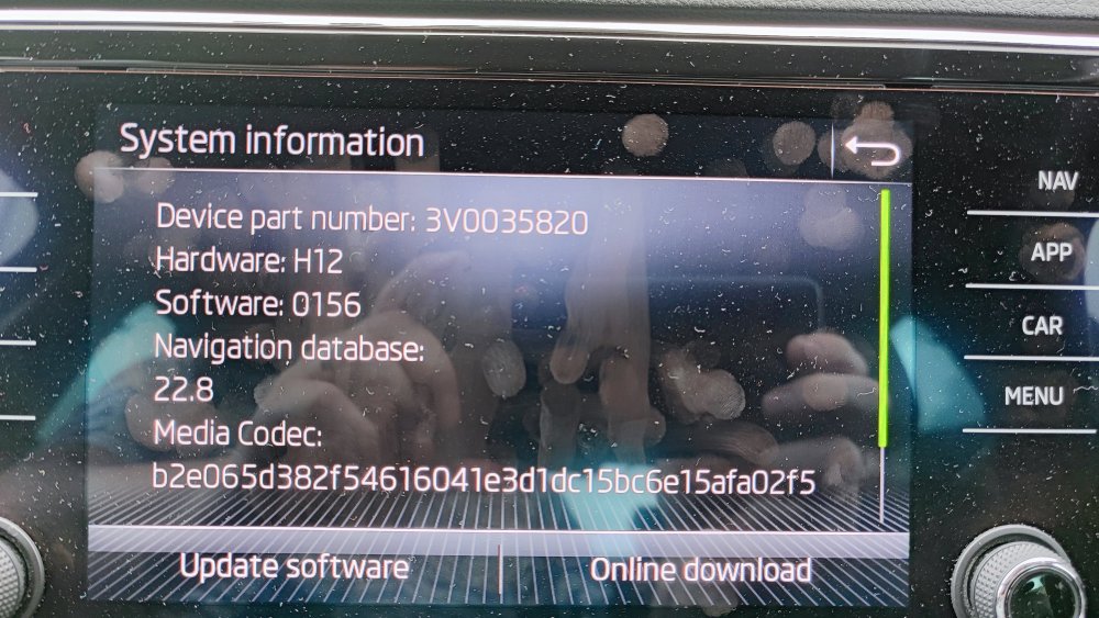

  14. I'm getting software update available messages pretty much every time I drive the car. This has been going on for months now. I've had it to the dealer & they reported back that all the software is up to date. It doesn't matter if I press OK or later, the message dissappears until the next time I start the car up? I've also included a photo of my software revisions as of 9th Sept 2022.
