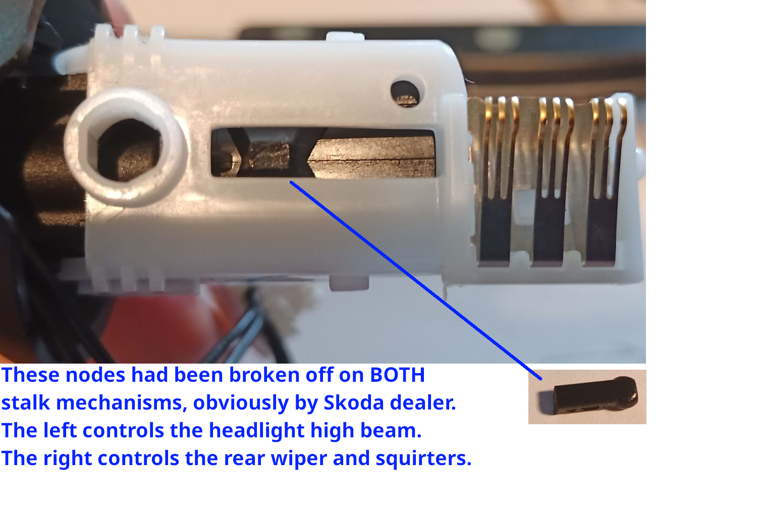

  2. Update: I've discovered the problem --- Skoda service centre "mechanic"! As bizarre and crazy as it sounds, the authorised Skoda repairer must have physcially broken BOTH multifunction stems on the steering column. They were working fine before the electrical fault it was sent to them for. The part in question I have a photo of included. So if the push pull part of the multifunction stalks on the steering column do not work, these broken plastic nodes are likely the cause. I've repaired them temporarily by gluing them for now. Skoda dealers in Australia only sell the complete two stalks and they charge over AUD$500 plus GST. I could not even contemplate that the "mechanic" at a Skoda service centre damaged both of these so presumed it must have been related still to wiring problems rather than mechanical breakage. If it was only one, I would have considered it to be mechanical more likely, but BOTH. I am still in shock! Oh how wrong I was. The level of incompetence by Skoda "mechanic" is unbelievable, or malevolent actions by someone there. Either way they are dodgy beyond belief.

  4. I am working on a Skoda Octavia II 4WD Diesel TDI 2010 model that was reclaimed from a dealer that was extorting the owner and doing a **** poor job. It initially was in there for not starting (bypassing the light brown Earth wire for immobiliser etc managed to get it working) When it came back all of the dash sections had been removed and the wiring loom had been completely untaped so it looked a right mess. They had even moved an engine fuse to the wrong slot. The dealership had also removed the heater/aircon unit as well. I've put most of it back together and the vehicle now runs. However, it has a problem now (I don't know if it had at the time of initial vehicle failing to start) in regards to the levers on the steering column. Both the high beam and the rear wiper/squirter controls. Both of these are the push forward / pull back type controls. The other switches and buttons all seem to work fine, including horn and radio controls. At start up, the rear wiper starts up and squirts water for 15 seconds or so. This cannot be stopped. During operation of lights, the high beam selector does nothing. And the three controls on the other lever switch do nothing, ie rear wiper, rear squirter, front squirter. It seems odd that it is only the actions of push/pull on the levers that do not work while the other buttons all seem to work fine. I do not have a VCDS HEX2 diagnostic computer. I am suspicious of some electronic fault in the spring wheel unit (sticker shows 5KO953569E) as I cannot see any obvious wiring problems. The owner has informed me in the past that the headlight globes have blown about every six months. Not sure if this is relevant information. And I see a dash fault code to check front right light occasionally when I run the vehicle. Can anyone with some experience with this provide me some idea of how I might diagnose this further at this stage please? The airbag is still removed for now so can test with a multimeter as required without risk of setting it off. Are there any meaningful voltage tests I could do on any pins and if so what pins? Is anyone able to provide me the wiring pins from the unit and corresponding pins at the other end (I am guessing probably one of the Body Management Control plugs) What else might I test? Thank you Jee
