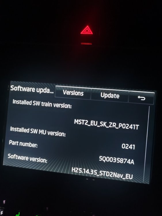

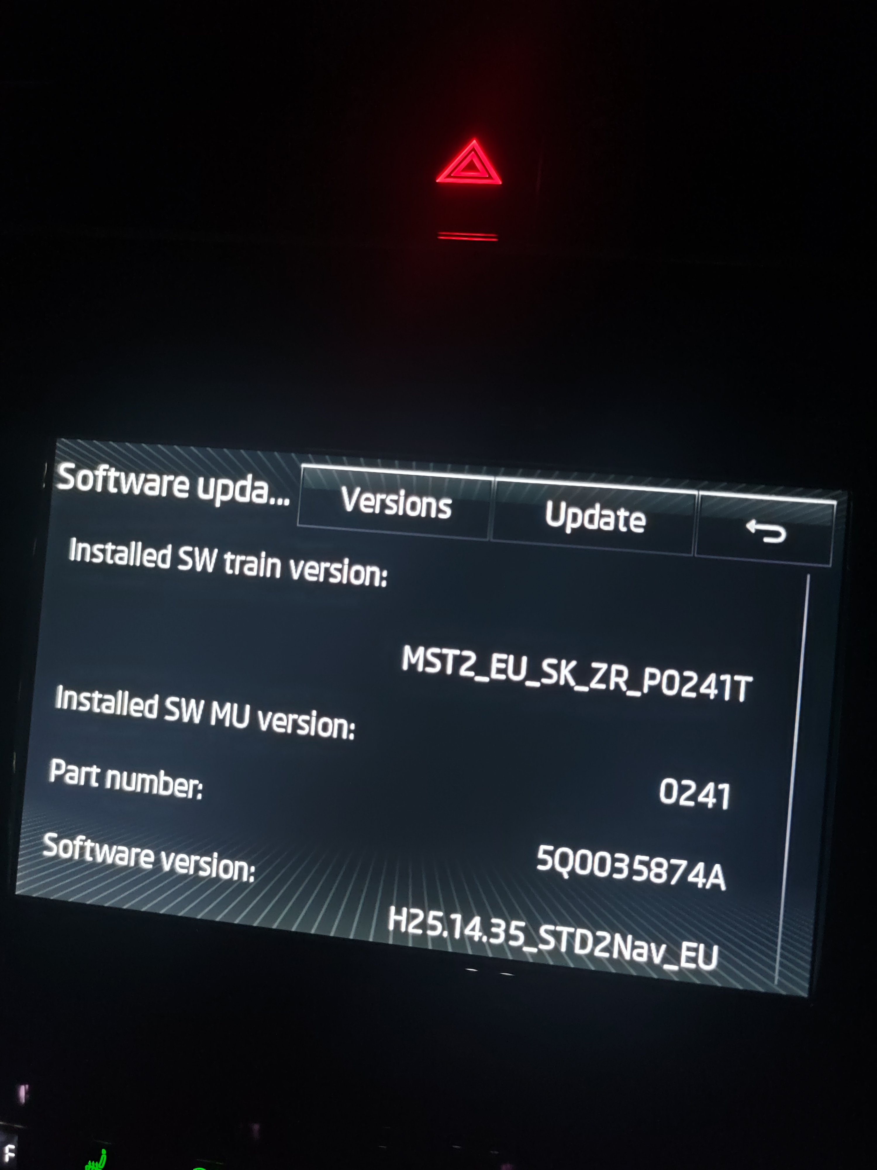

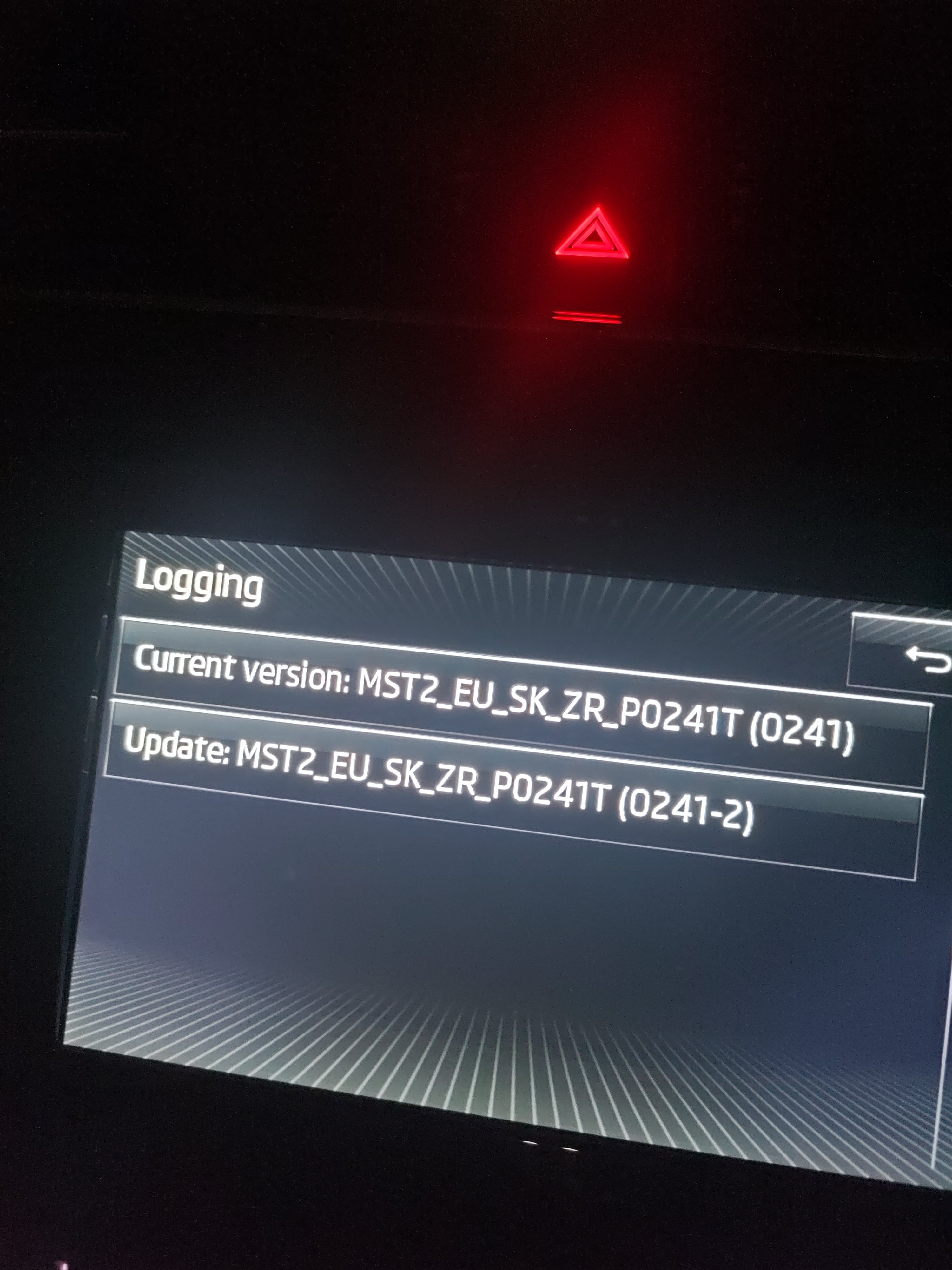

  6. Morning all, Thanks to varooom I know that my unit can be upgraded to 0253. However, I would like to know what benefits/improvements this upgrade brings as I have had several negative experiences when upgrading different devices (phones, TVs, etc). Also, my XIAOMI Redmi Note 10 pro works well with the unit now (streaming Spotify, phone works well .....) And I am weary of things going wrong. Any thoughts on this please? Thanks.

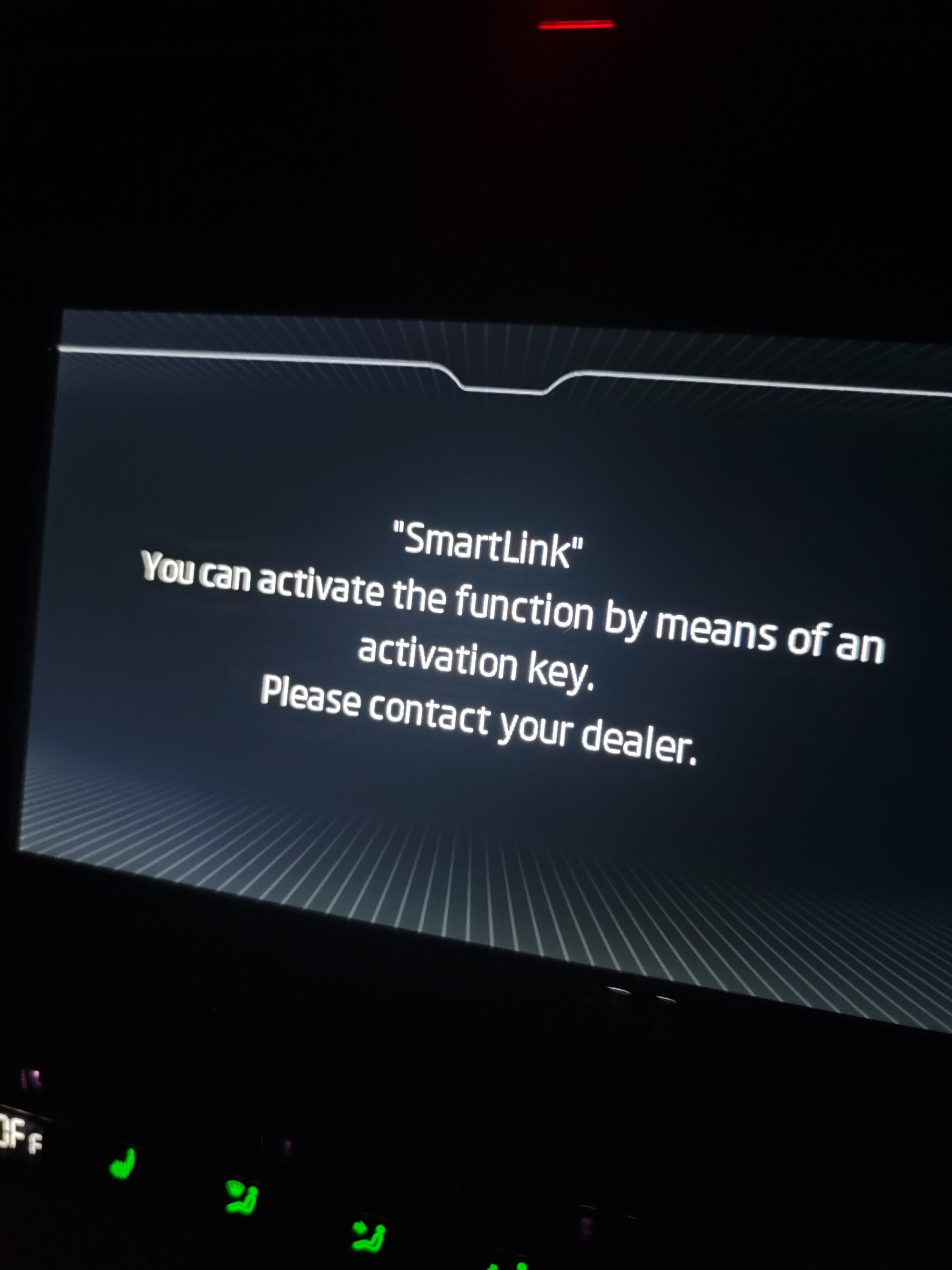

  13. Dear members, A few days ago I purchased an approved Skoda Octavia Scout 4*4 from a dealer and after browsing through the Infotainment menu, I had selected Smartlink to access Android Auto. It said I needed to contact the dealer so they could activate the feature. Today I have called the dealer and the woman I have spoken to didn't have a clue. She said she has never heard of needing a code to activate Smartlink and then she said that I needed to connect the phone with a USB cable. Anyway, she has been told by another colleague (as I could hear them both talking) that I had to visit the dealer and pay around £250 to activate Smartlink as the car was "very old" and Smartlink didn't come standard at the time. Can anyone please clarify if Smartlink didn't come as standard in the Skoda Octavia Scout back in December 2015? Thank you. Gerry
