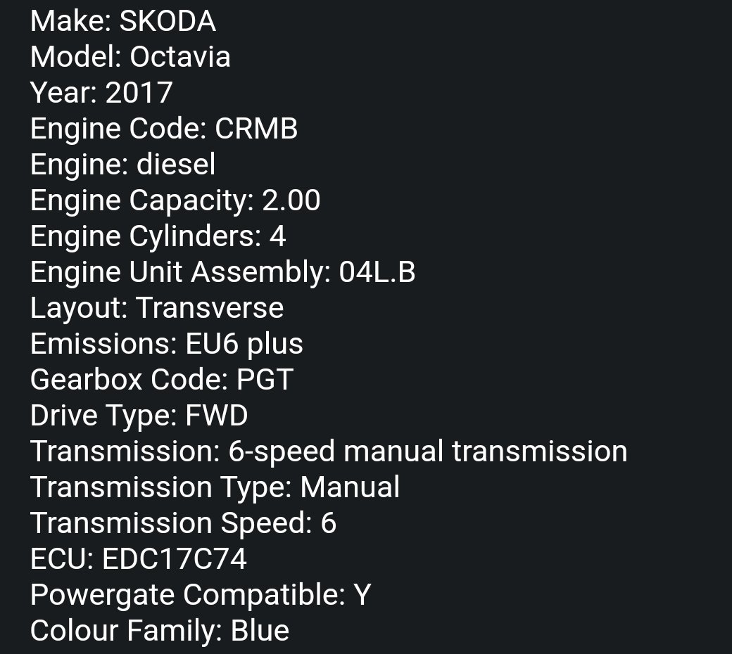

  3. Also the sound cannot be heard from the engine bay, tested it earlier with a friend and we could only hear it inside the car. For information it's a 2016 CRMB engine although the vin says its a 2017 model, is that normal?
