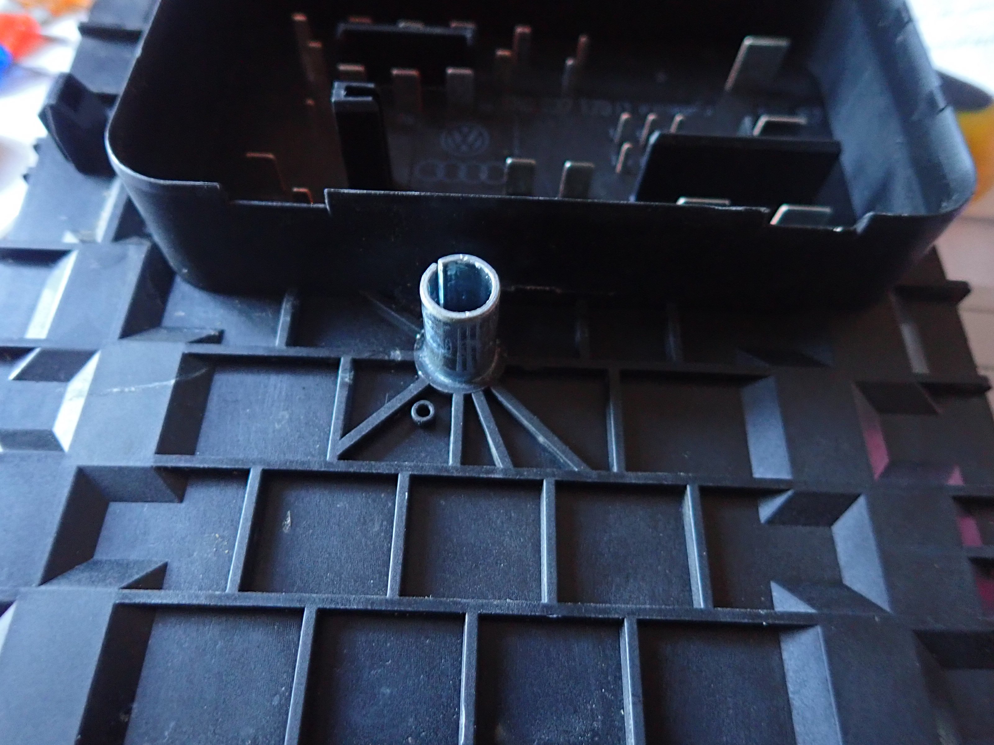

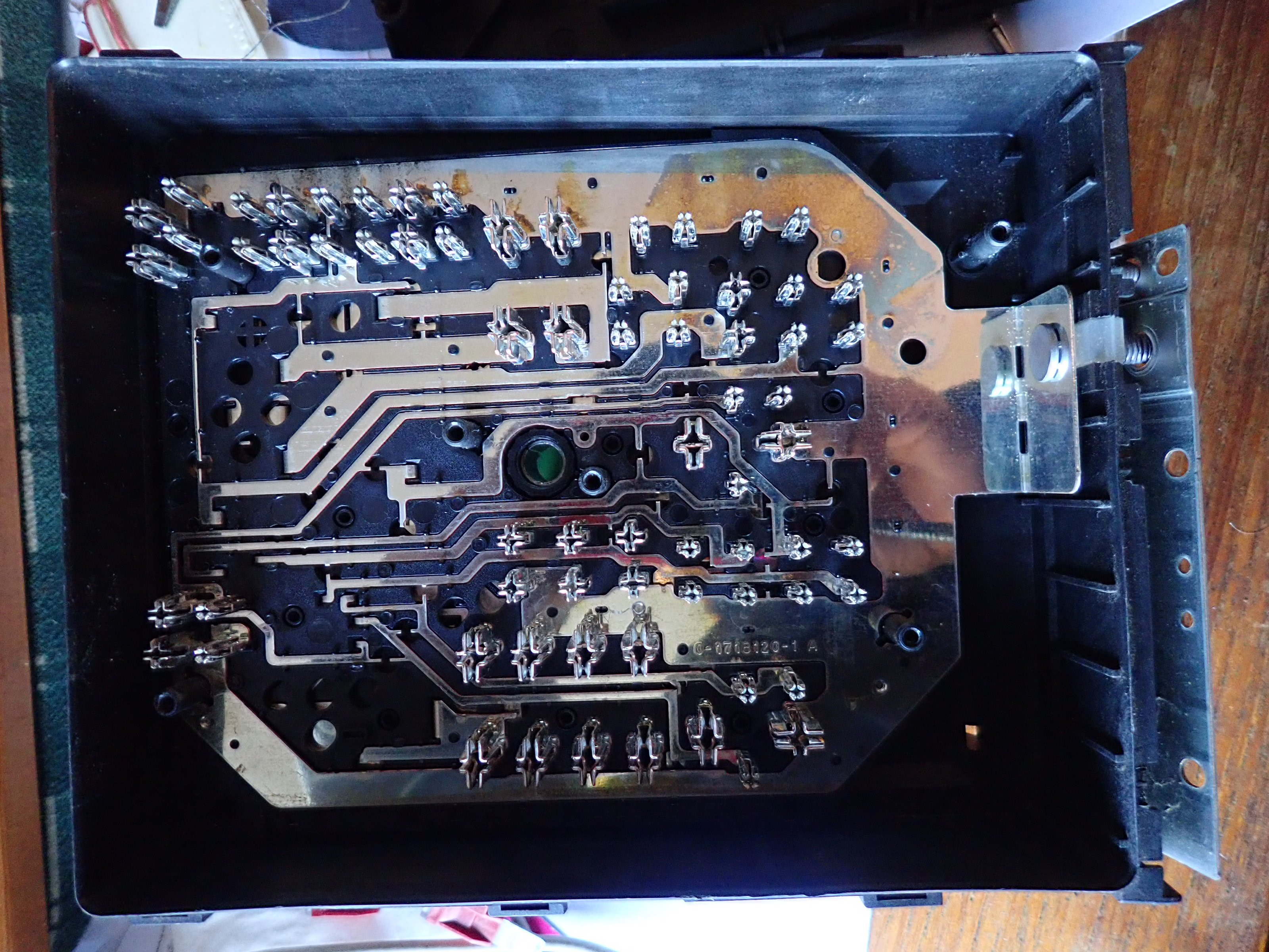

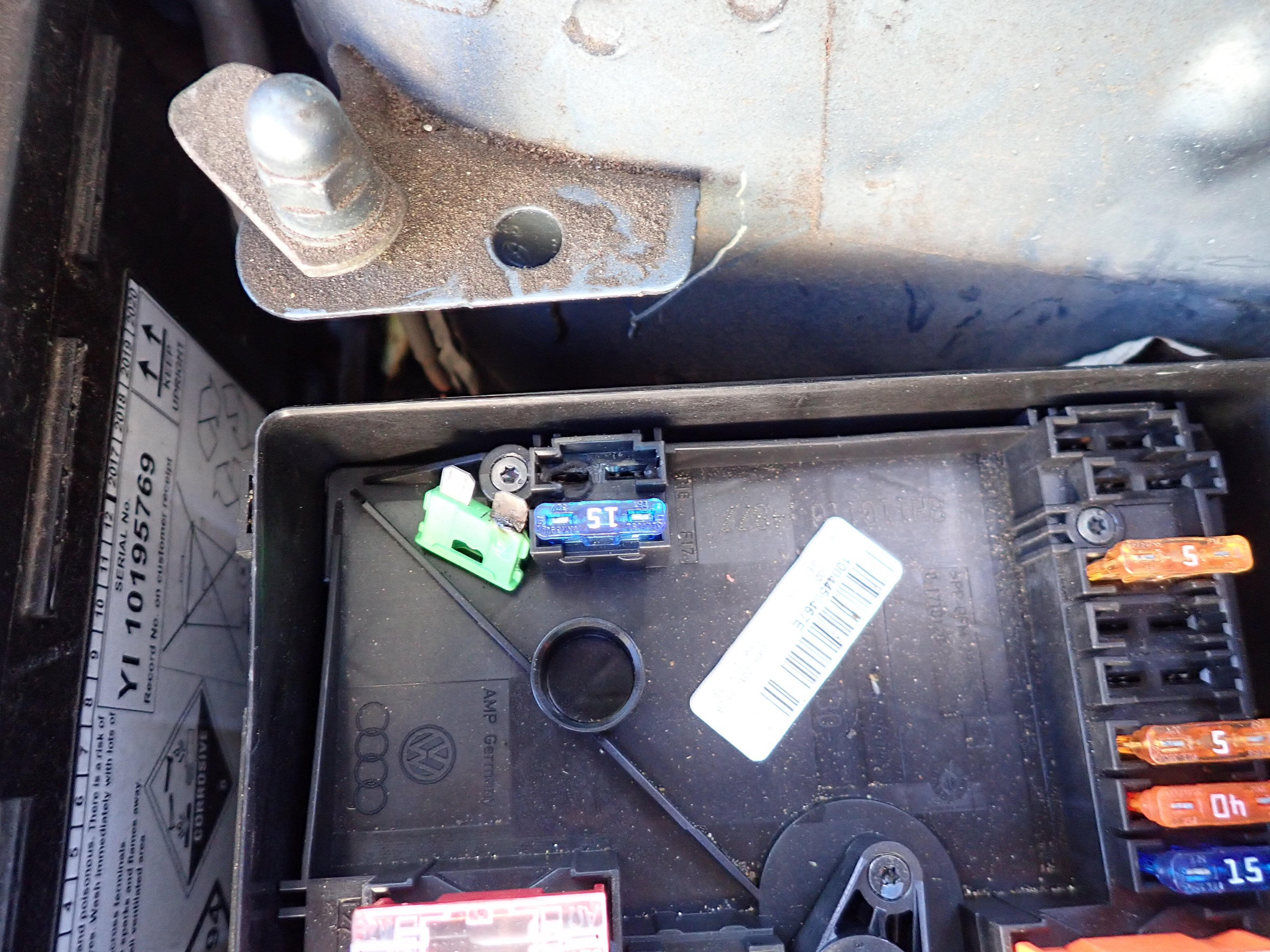

  2. Update on unusual fault on lights. The fault was indeed as Langers2K highlighted, the 30A fuse position No.F16. Removed fuse box and wondered whether it was repairable rather than trying to source a good secondhand correct replacement or buying a new one. I am definitely of the mind to repair where possible. With the fuse box removed and all the fuses (inc the relay blank/bypass plate) and all fuse positioned noted/photographed, I pushed the steel anti-crush tube half way out of the fusebox. It was then possible to lift out the top half of the fusebox. The only thing stopping it from easily pulling out was that the overheated fuse holder had melted the plastic and partially bonded it to the fuse holder/connection. With the top half off it was simple case of cleaning the fuse contact surfaces with emery cloth and crimping them in slightly to increase the contact/grip on the fuse. It all went back together easily, refitted to motor with new 30A fuse and tested ok.

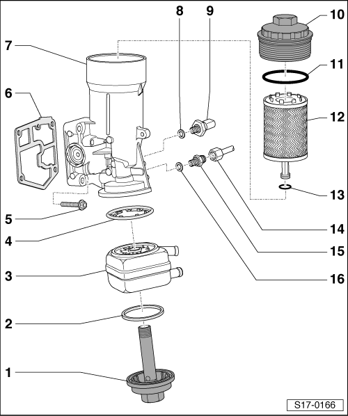

  11. Hi, I have a coolant leak on my 1.6 TDI CR. Using an endoscope poked down the front of the engine I'm fairly confident that it is leaking from the gasket between the oil filter housing and engine block. It would be great if someone can confirm that there is in fact a water channel through this gasket. The gasket from which the coolant appears to be leaking from is item 6 in the attached diagram. Thanks in advance.
