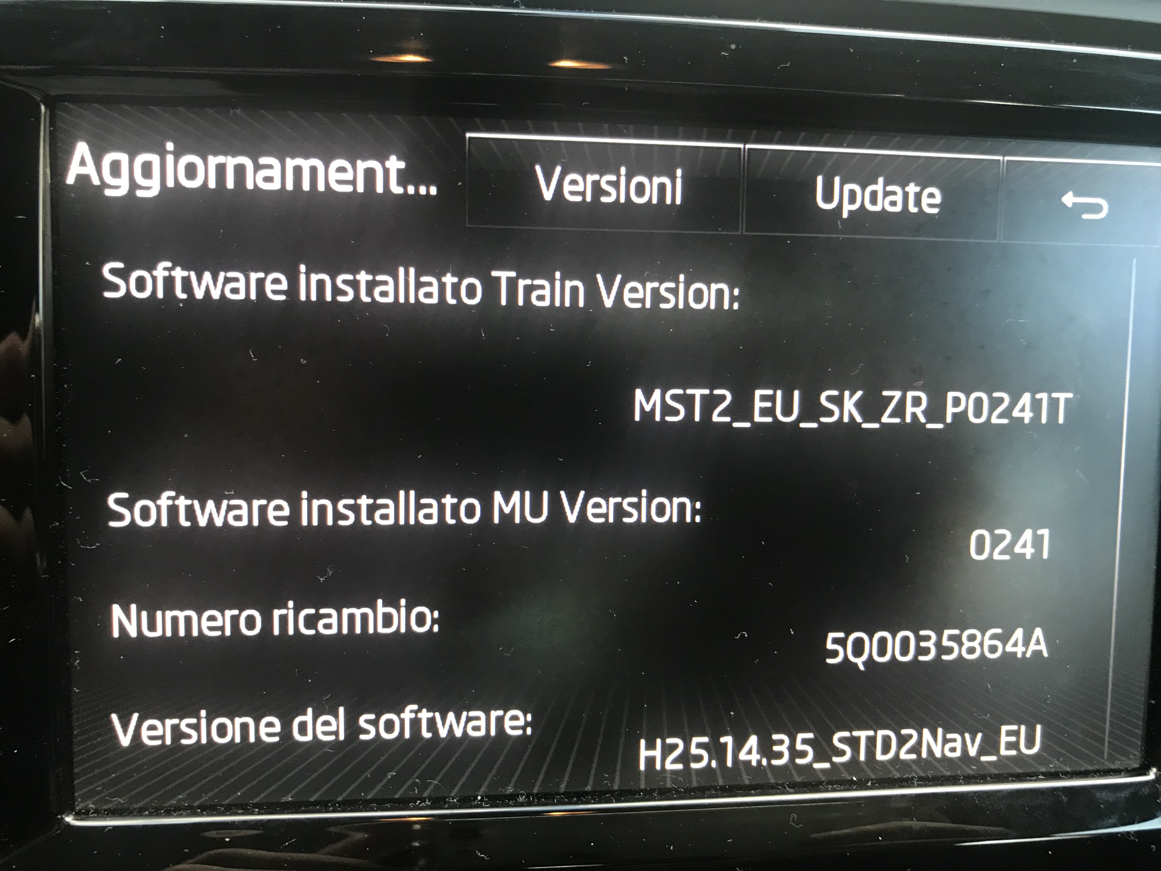

@Joco776Hi , I followed the steps but is not changing the code..remains the old one..and it doesn`t ask me to reboot..doesn`t give errors but does not change the number. I did entered on security code, adaptation..the channel confirmation but doesn`t seems to work. Anyway I noticed that the collors of the display doesn`t look like normal..The update of the unit to 0480 could help? Thanks

it worked now after formating. Thanks again GBU
Amundsen MIB2 Firmware Update
no, i used another sd card and i put it on sd1 where usually the maps sd is. ok I will try to format the sd and since i`m there.. i`ll put the newest maps. hope will work. what is new in this firmware version? or is just faster? Thanks again

I updated the firmware and now the nav is not working..I have the original sd card but the nav won`t start- Amundsen MIB2 Firmware Update
