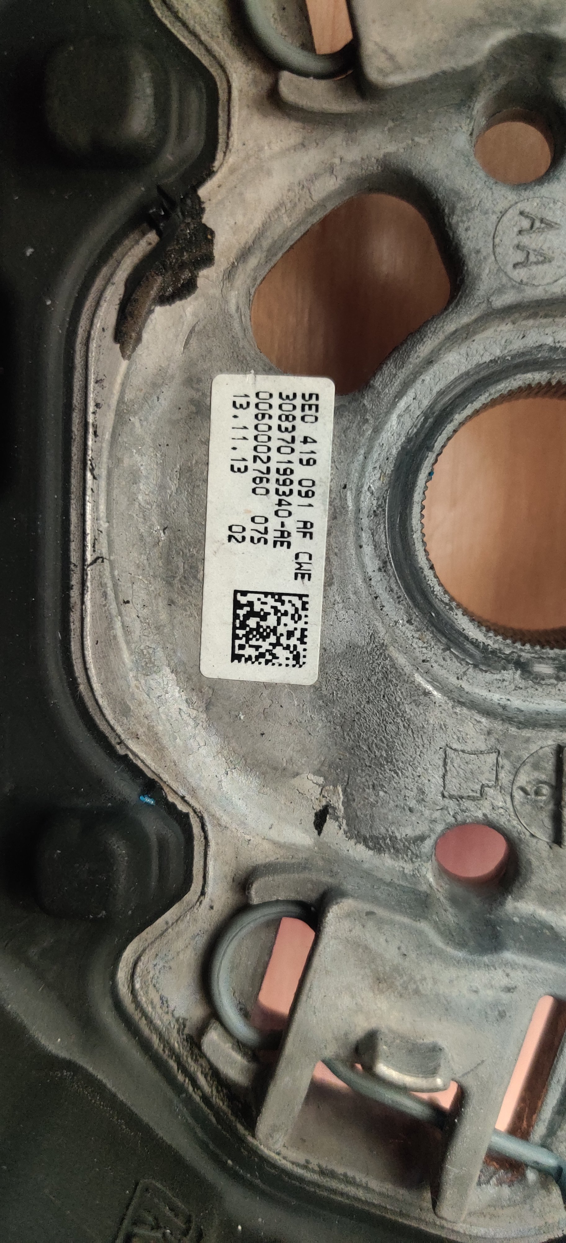

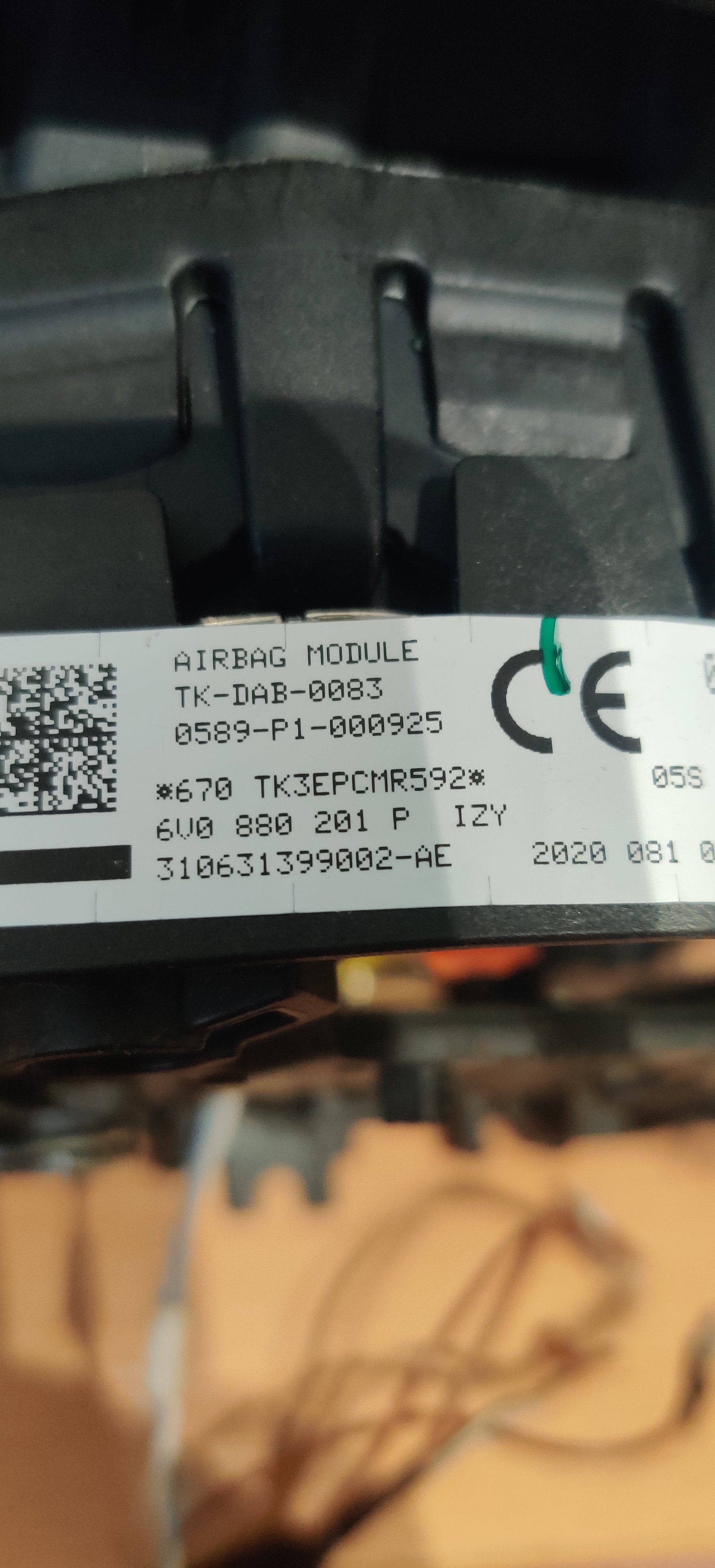

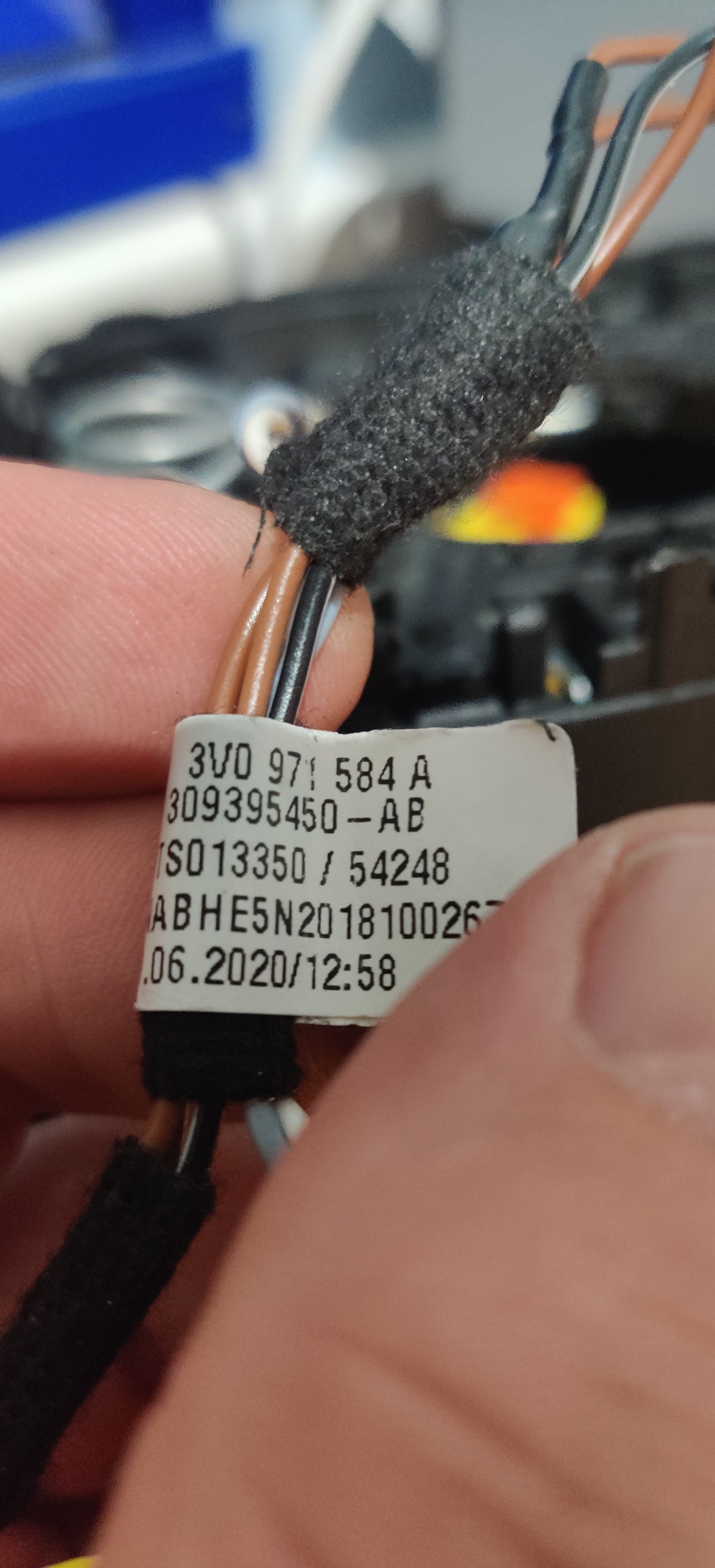

  5. Hi guys! Getting a little desperate now. I have been scouring the forum for advice/instructions on how to retrofit paddle shifters to a Skoda Superb II. Unfortunately, I have hit a bit of a brick wall. Parts I have: Steering Wheel: 5E0419091AF Buttons: 5E0 919 719 G Airbag: 6V0 880 201 P IZY Wiring loom: 3V0 971 584 A See attached pictures. When I fit these, the horn continually sounds and the multi function buttons do not work. I have a feeling I may have compatibility issues between the parts. Can you help/advice? I have spent a bit of money now and feel committed to it but do not want to waste any more. Many thanks in advance,
