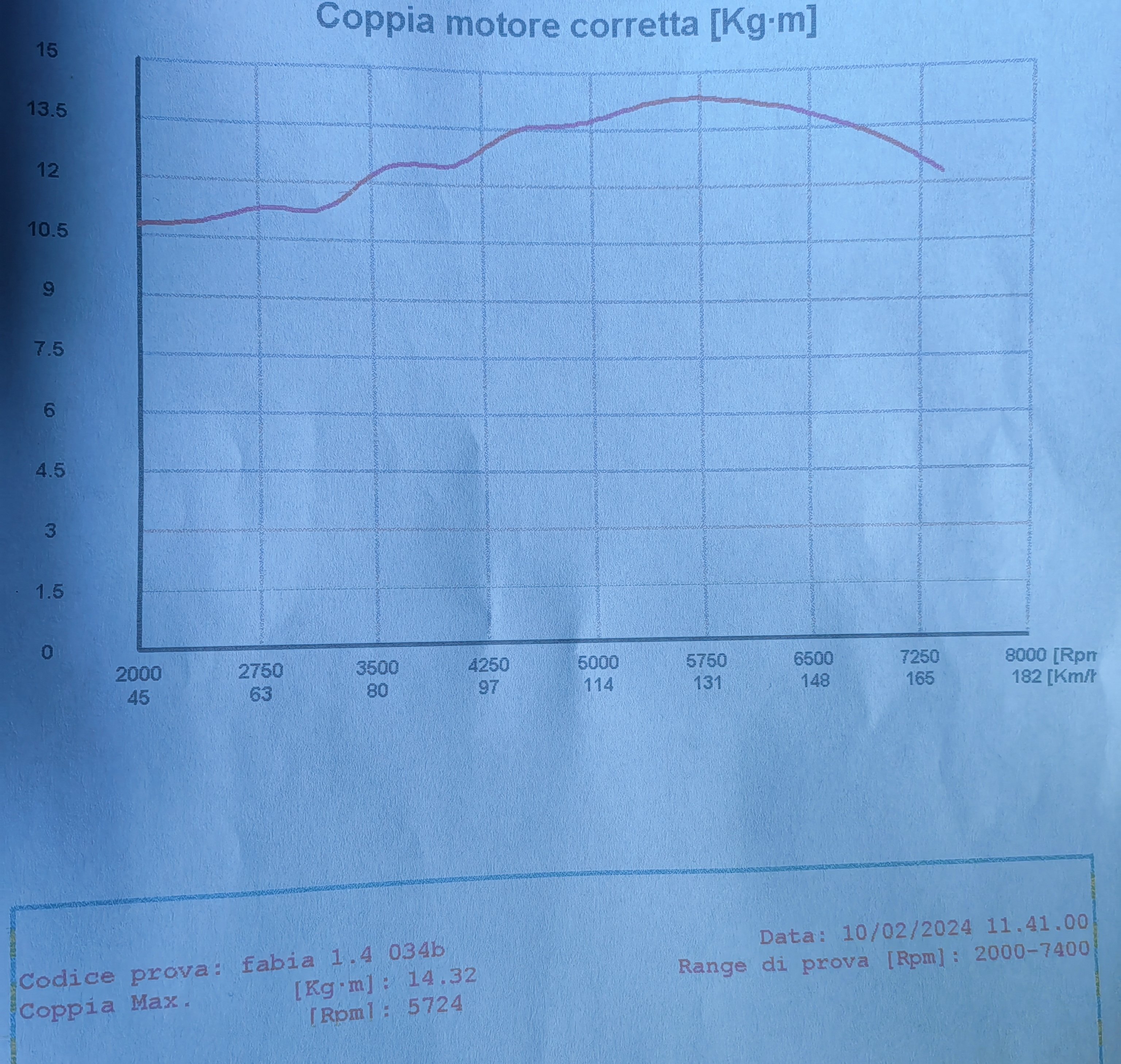

  3. The engine is running quite OK with a good amount of torque. Now I need to thest it on the road to se the result.

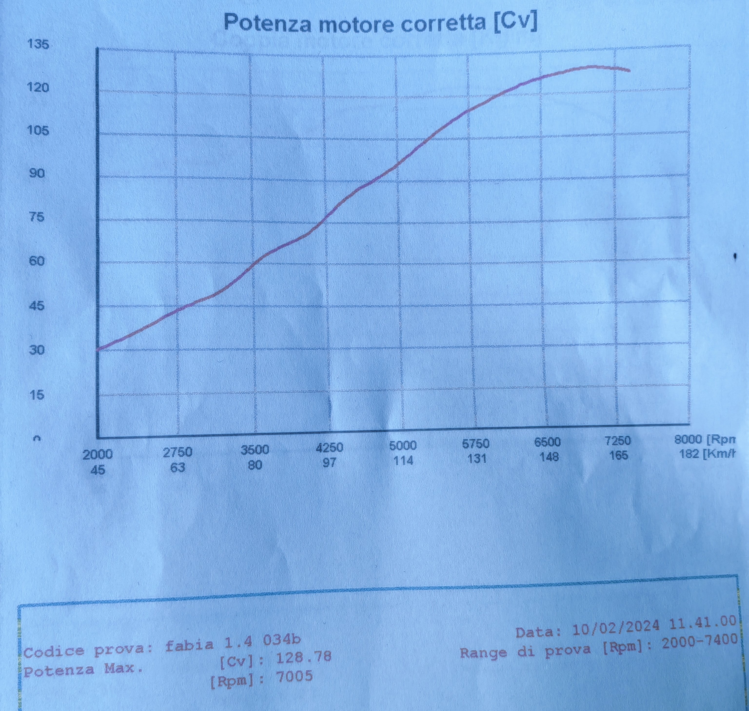

  4. The topic is over i know, but I would like to post an info on my build... With a lot of stuff done on the engine it make 128whp on the dyno today.. I expected more with all the stories about ABT.. But is ok the main goal is to do a lot of kms with no issues
  5. This fabia with aub engine gr.A spec is about 160bhp without ITB's and VVT. And with original exhaust and intake manifolds. Vancik in Czech is stil building this engines. This engines are for rally build and they must last a lot of km and they must be drivable on normal road and they are. It is possible all depends od the cost
