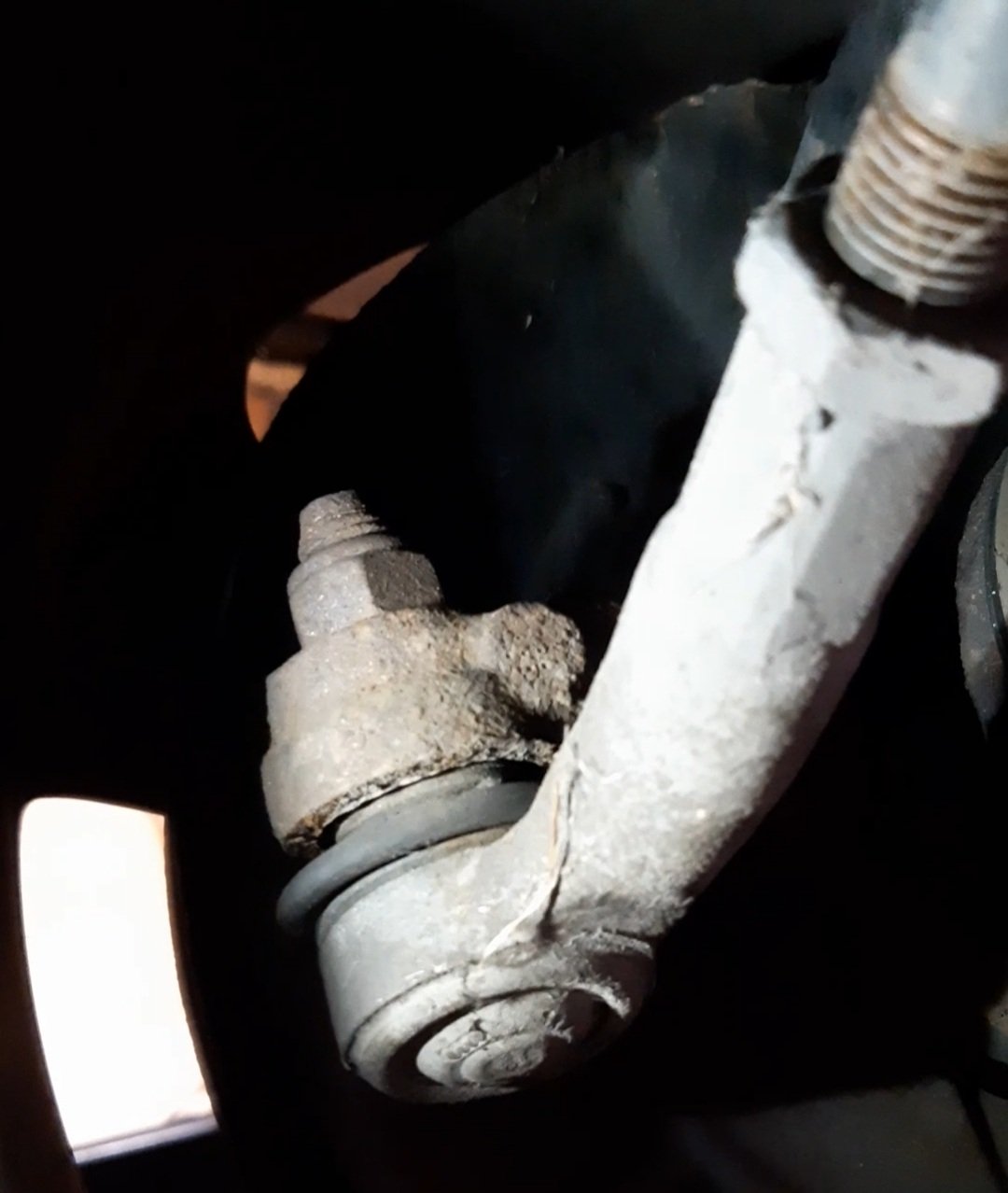

While speaking to the service manager of the Marshalls Skoda a few minutes ago to book it in, I asked him about this and he says he's often seen new cars with non-equal number of threads here, I asked "even 8 /13 threads?" he said yes and it varies quite a bit. Interesting. Hmmm..... Respond to online review.

Posting I was middle of writing suddenly posted by itself while I was trimming size, on the tablet I was using at the time the green 'submit reply' button suddenly jumped right under where my finger was pressing 'delete'. Then wouldn't let me delete the posting. And Edit only lets you delete text and any accidently added sections won't delete once added. So starting again... Me neither. The hole in plate dictates position is probably bent or distorted out of normal place by the big hammer or crowbar or whatever car mechanics use. What's clear is the car hadn't been reassembled correctly so all can do now is speculate. Yes as you point out there's quite a difference in (8/13) threads. I'd not considered this because I've not seen signs the track rod end threads been disturbed, there's no tooling marks on the nuts or rod hexagon sections, in fact signs of disturbance right here was the very first thing I'd looked for. If they had disturbed the track ends (somehow managing not to leave tooling marks) then it beggars belief why they would even want to disturb the track rods anyway? Unscrewing one right off the rack would be more time and work for them to do than popping it off at the joint with a popper. ...Unless they were deliberately trying to muck up the car for some reason. I certainly hadn't asked for toe setting. Just wanted the minor MOT failure (supposedly) fractured spring done nothing else. So it seems then it's normal for these cars to drive fine and straight .... up until the first ever mechanical intervention. I'm very lucky here as I'd escaped this until now being such a low use car. From that point forward there's then bits missed off and the car pulls to the left. I can see now how the car is so sensitive to wheel alignment going off, reading about plates that move position if the mounting bolts are slackened. I imagine these cars when they're built in the factory are put on a jig to align everything then all the bolts are tightened. Woe betide anyone slackening off these bolts after that. I think the take-away here is don't let mechanics touch your car, and I've learned the lesson is if you have a time capsule low use car low mileage and you ever get an MOT failure for front suspension: Get a second opinion first before anyone unscrews any nut bolt or screw as the car is never the same afterwards. Sigh.

Having looked again at videos, no tooling marks either side the track rod hexagon bar part. It would to had been spun round and round lots of times, no first few threads disturbed next to nut and no tooling mark on the nut to slacken it either. Looks like the steering was left connected and suspension leg somehow pulled clear out the ring clamp. Maybe the steering gear had been bent downwards. I've driven the car in the rain since taking the videos.- Steering wheel crooked after front springs replaced
@ J.R. Hitting the CV joint. That might had been how they split the rubber boot. The two photos are one of each side from about the same angle. They're still from a video I took. If this 6mm difference isn't enough to cause the problem then there must be something else bent or twisted or missing , and I expect it's beyond reach of Sepulchraves advice. Good idea about them not able to break the trackrod end and choose to unscrew it right out, but there's no markings on the thread either side. They might had left the rack still connected and extracted the suspension leg. Disturbing the toe seeing would had explained the crooked wheel but not the pulling to one side that wasn't happening before. It seems too much a coincidence the wheel skewed to right by the same amount pulling to left. The car is noticeably more sensitive to changes in road camber now.- Steering wheel crooked after front springs replaced

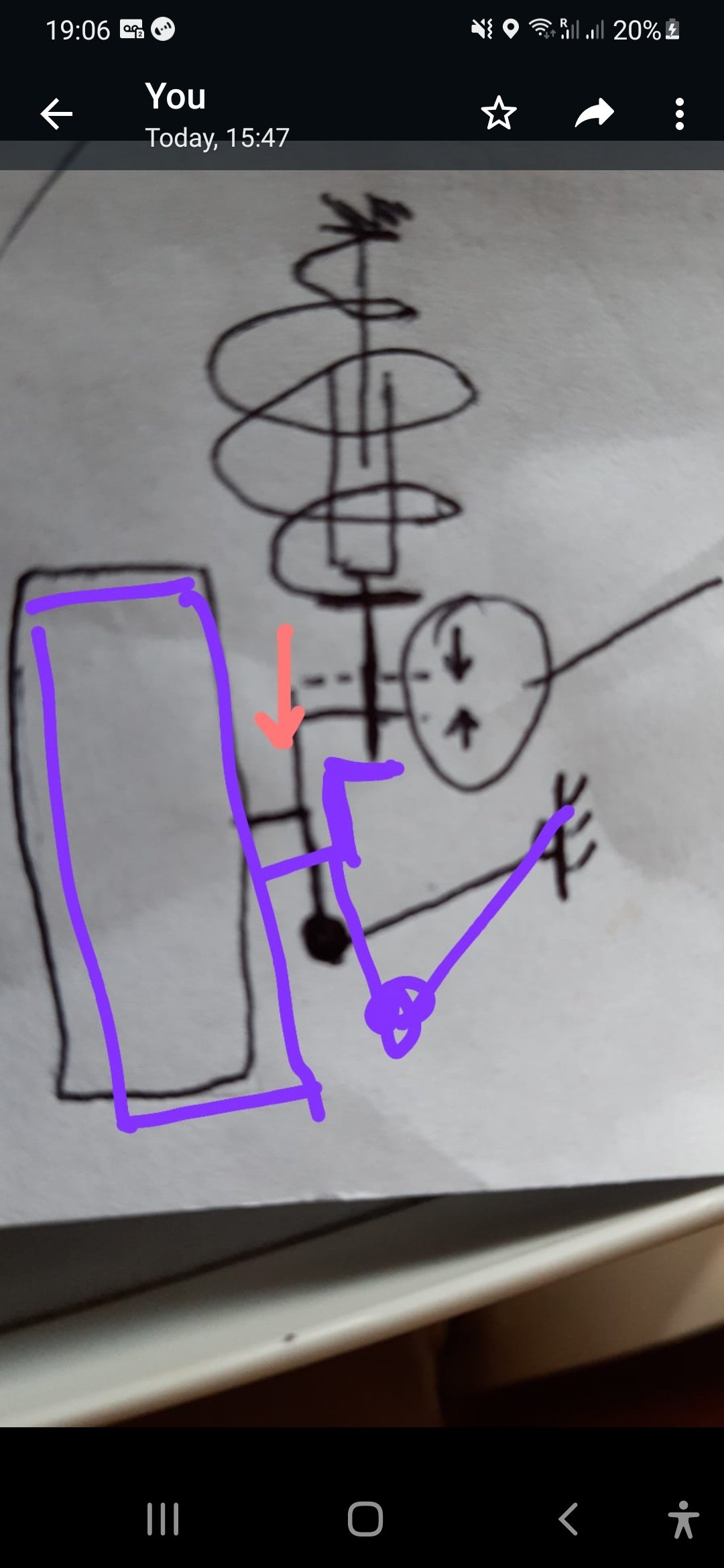

I think I might be answering my own question here. I've just sketched out what I think might be going on. Purple colour exaggerated. The suspension leg compresses OK to equal length both sides (weight of car), but the nearside stubaxle/hub/wheel-bearing-housing they'd positioned it much lower than the offside one. You can see the markings in the rust clearly that it's not been put back as they found it. The mind boggles how they couldn't have seen these markings and re-used them to put it back the way they found it. Or at least put paint marks or something. - Steering wheel crooked after front springs replaced
