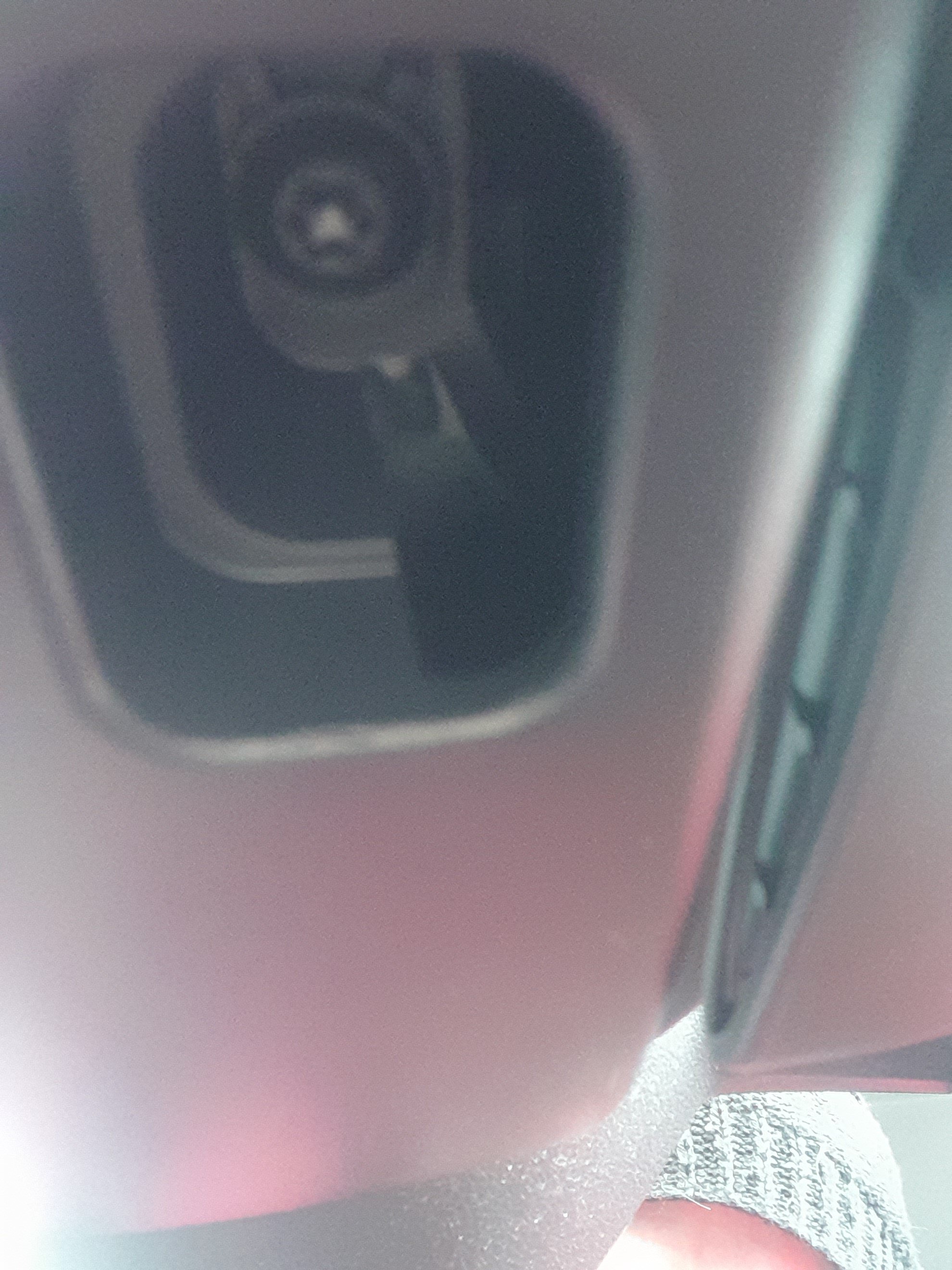

Refueling takes ages, diesel trickles in or stops.
There are two valves in the fuel intake. You can see the top one which moves as you push the fuel nozel into place. I'm our situation the lower one was stuck so only allowing fuel to trickle past. £120 for garage to listen it up. It has made a huge difference, 4 minutes to fill tank instead of 15. So still not working fully but much better.
I have a 2017 1.6 diesel. Ever since I bought it when I refuel I have to just pull the trigger and no more, I can lock 1 1/2 fingers under it and watch the fuel slowly trickle in. Any more and the pump clicks off. Several people have tired, nozzle has been tried all the way in to just the tip, at different angles and pressures, no difference at all. I have searched and not found any solution with suggestions of. Fuel filler breather pipe Fuel tank breather valve Any resources on how to check these?

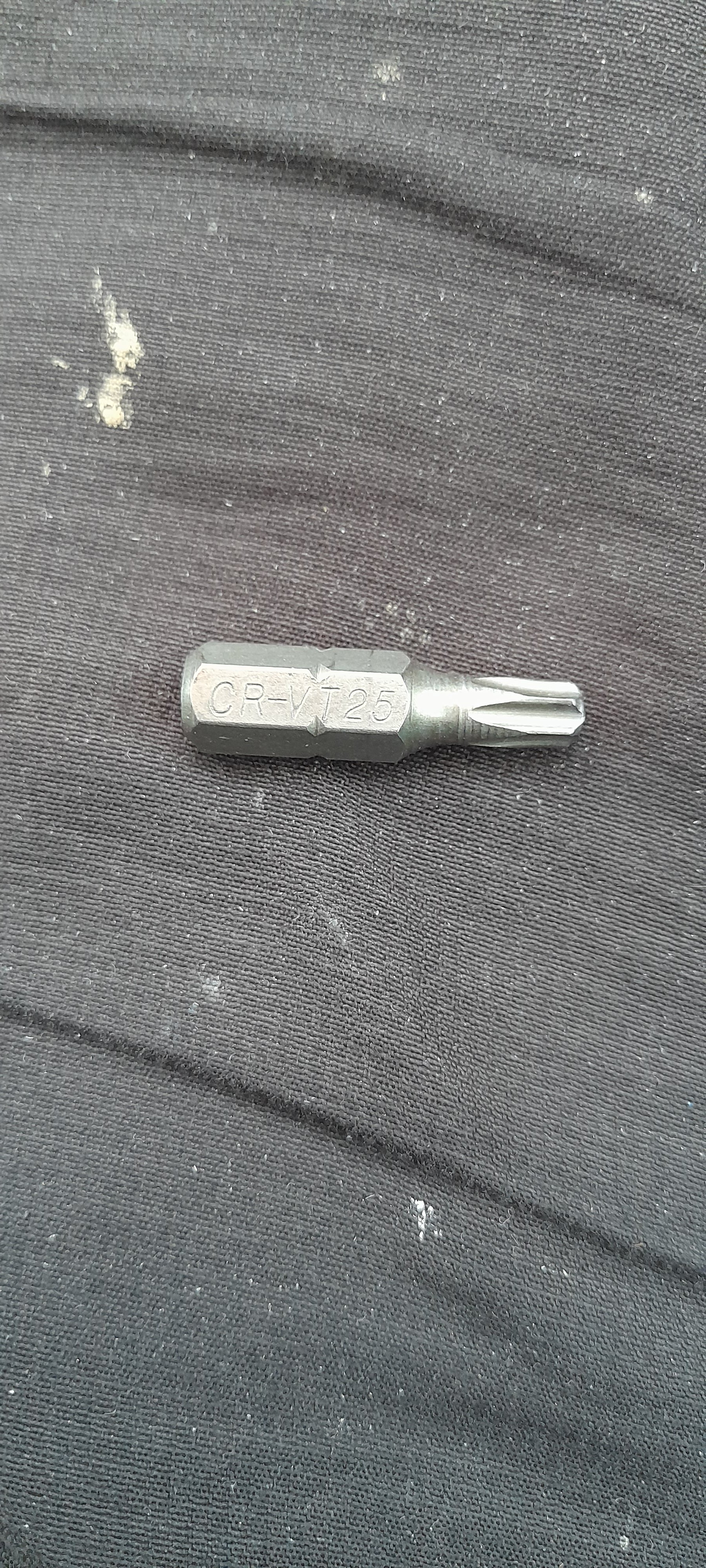

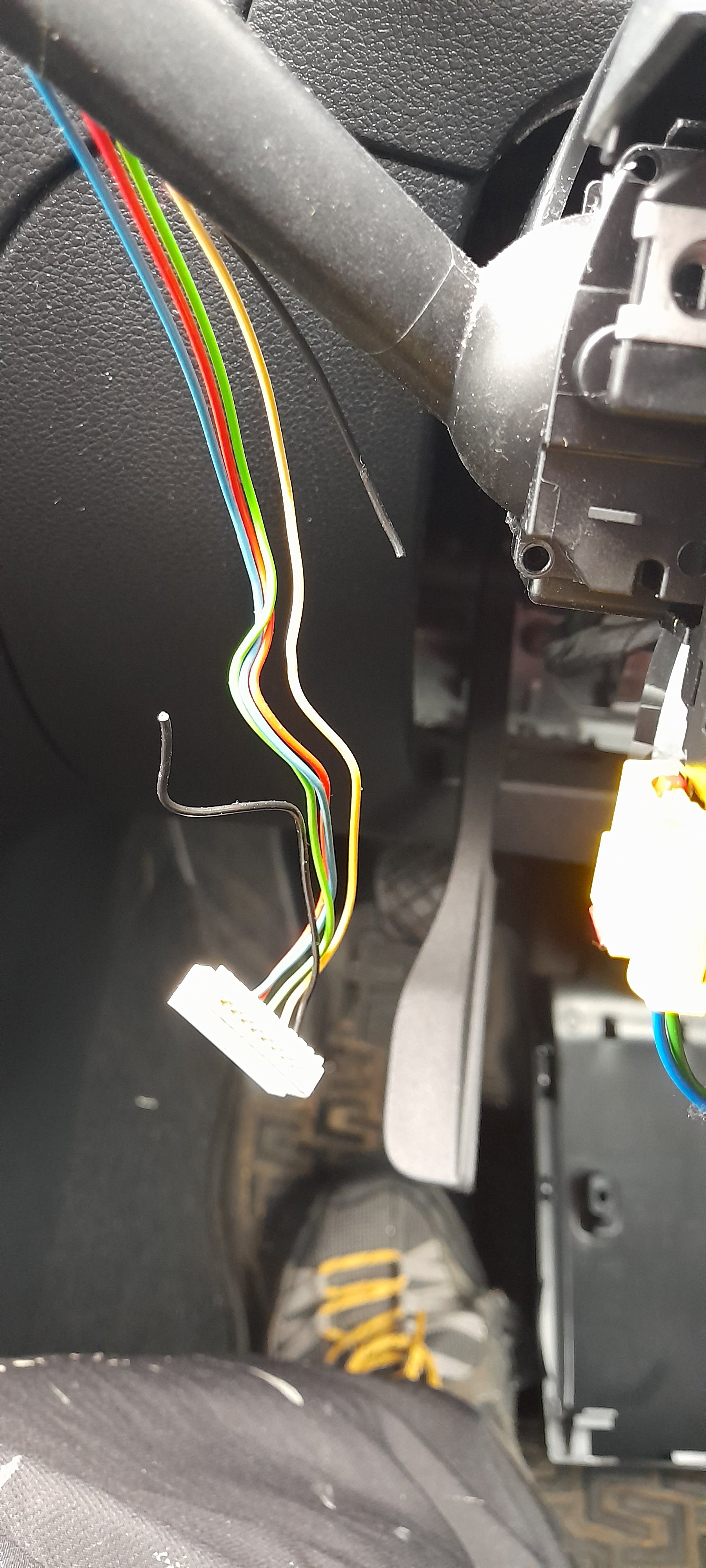

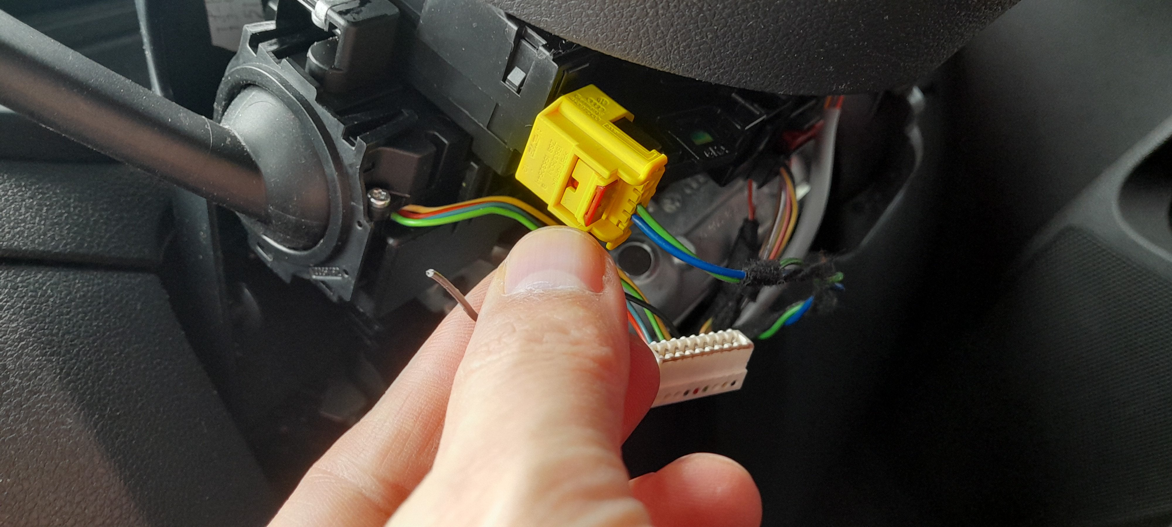

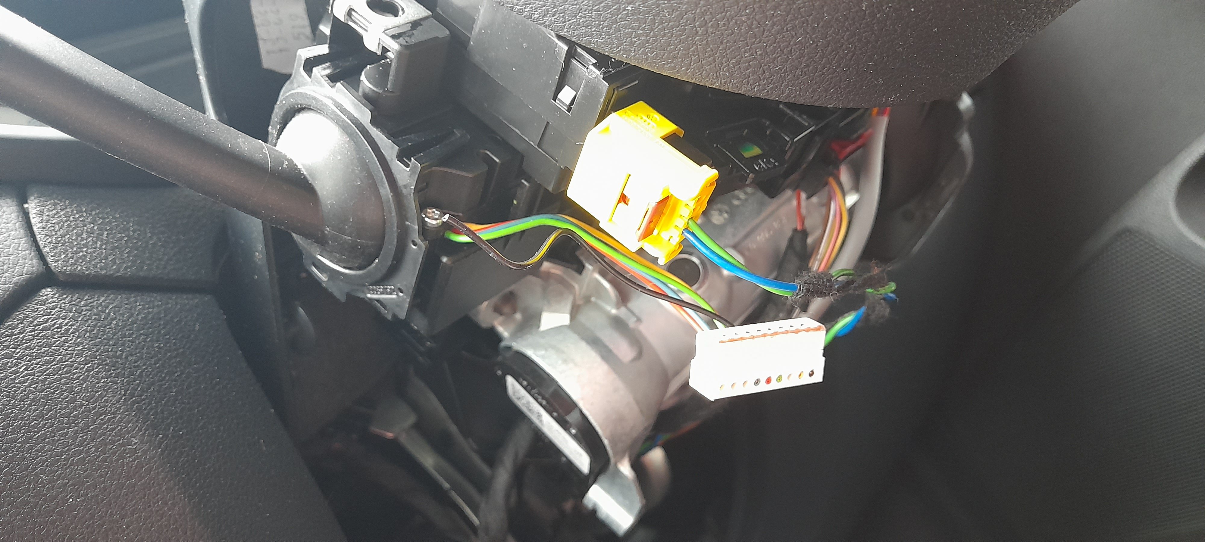

Cruise control stopped working
I have fixed it. I stripped the cowel off the steering column. You need a no 25 star drive. Undo the screw on the underside of the column. Then unclipped the upper section, it will flip up. You will see two more screws, remove these and the lower section can be taken out the way. There are two silver small screws infront if the stalk base, take these out. Unclipped the surround round the stalk, it has two clips infron and the circle of plastic round the slake comes free. Split the stalk with a small flat head screwdriver. The back comes off. You can now wangle the wires out. Unplug it from the column, a small clip and pull. You can now join the broken wires and reassemble. Use a crimp if you have one but don't join at the break, this is where pressure is and it passes through the stalk. The wires are too short and so they are tight against the plastic. I used the smallest electrical block connector, shaved off the excess plastic so it fitted in the stalk and used a bigger one at the other end where there is loads of room.

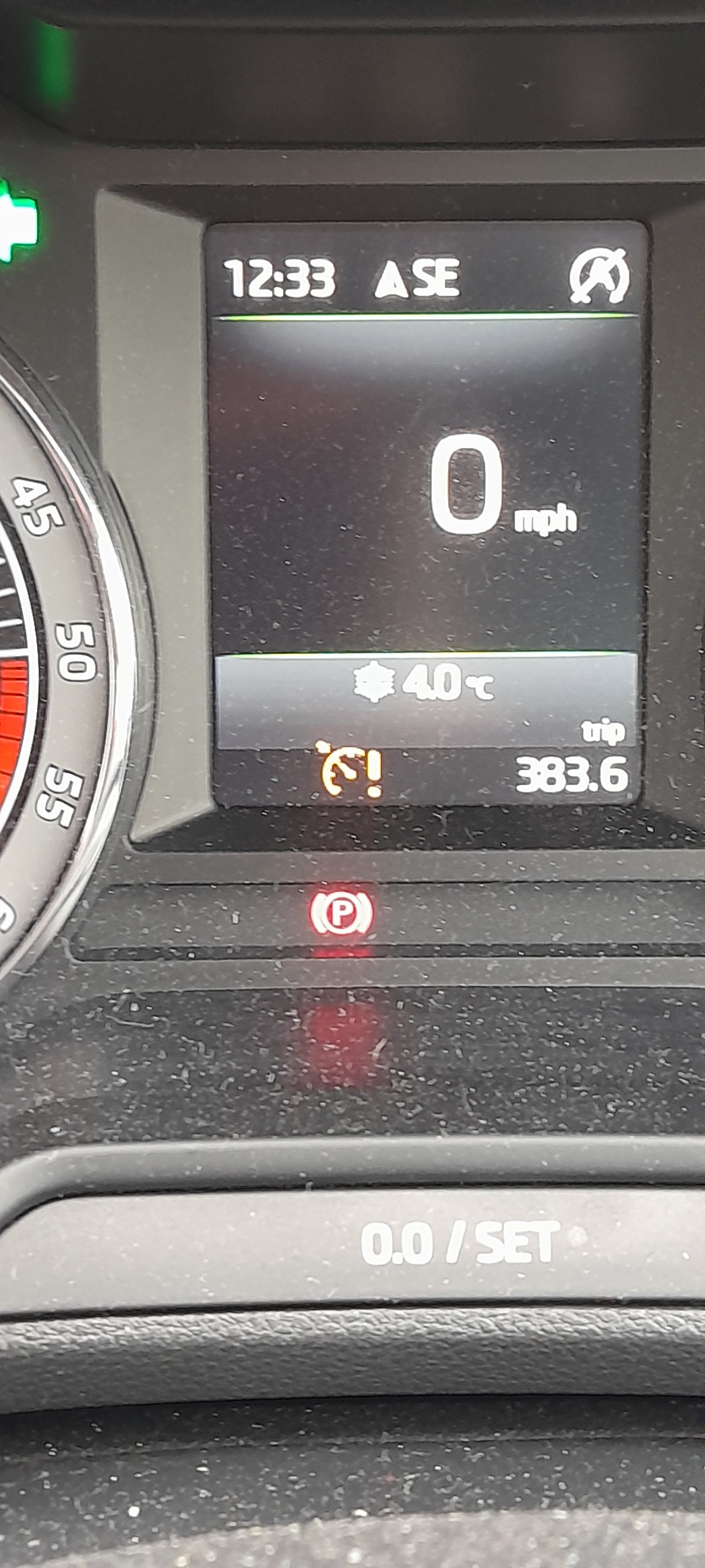

Garage cleared errors on computer. These were sensor errors. The distance sensor does work and warns if too close to vehicle in front. Now the cruise control still does not work. Just no response to toggle switch. However if the switch is on and I signal left I get the error symbol of orange speed indicator with an arrow and exclamation mark. This goes away when the left indicator is cancelled or cruise control turned off. This is standard cruise not adaptive.
This is a 2017 model. It used to work. The cruse control button does nothing. There are no error lights on the dashboard. I opened the stalk to see if the unit connectors needed cleaning but this one is hard soldered in place. I can't find which fuse is involved and as far as I know nothing else has stopped working Help?
