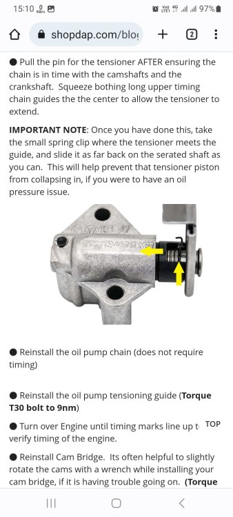

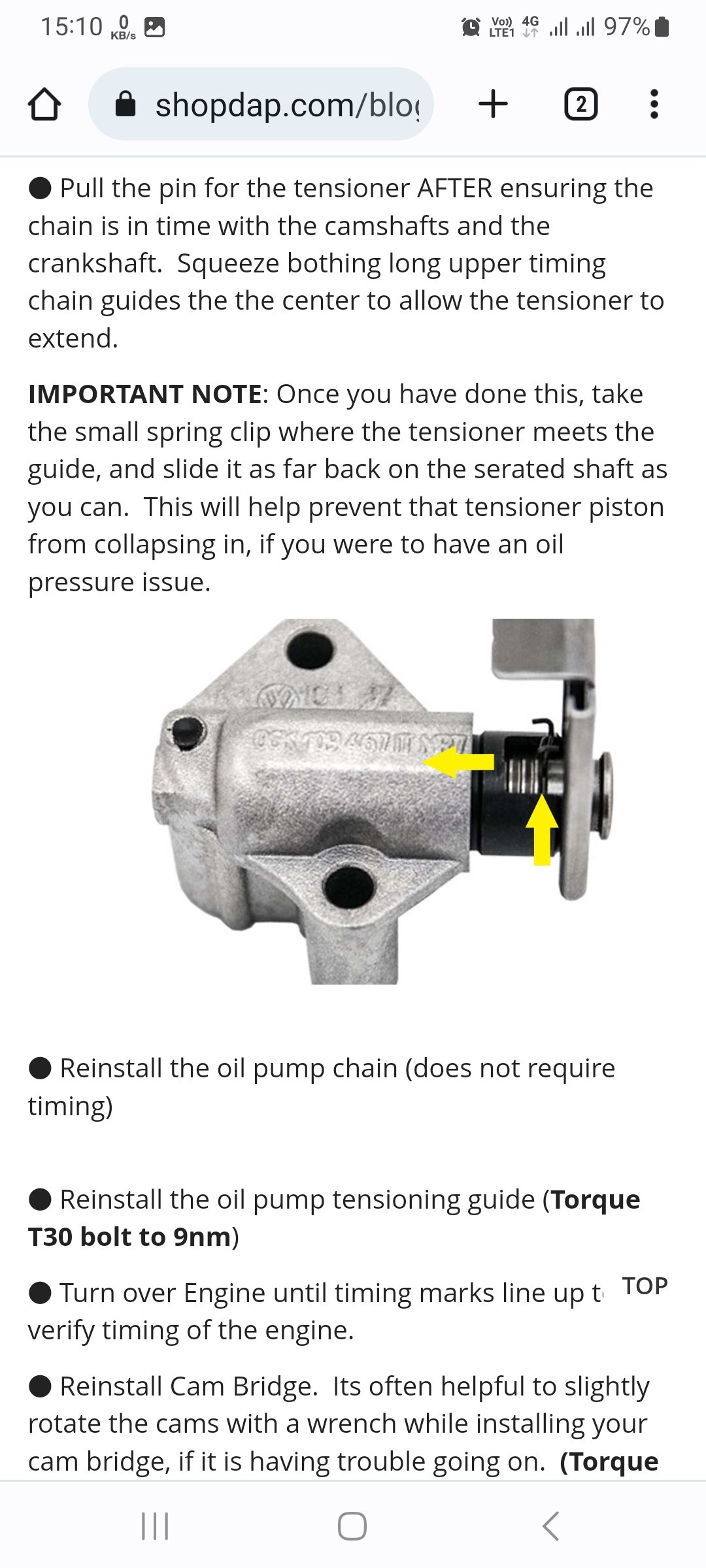

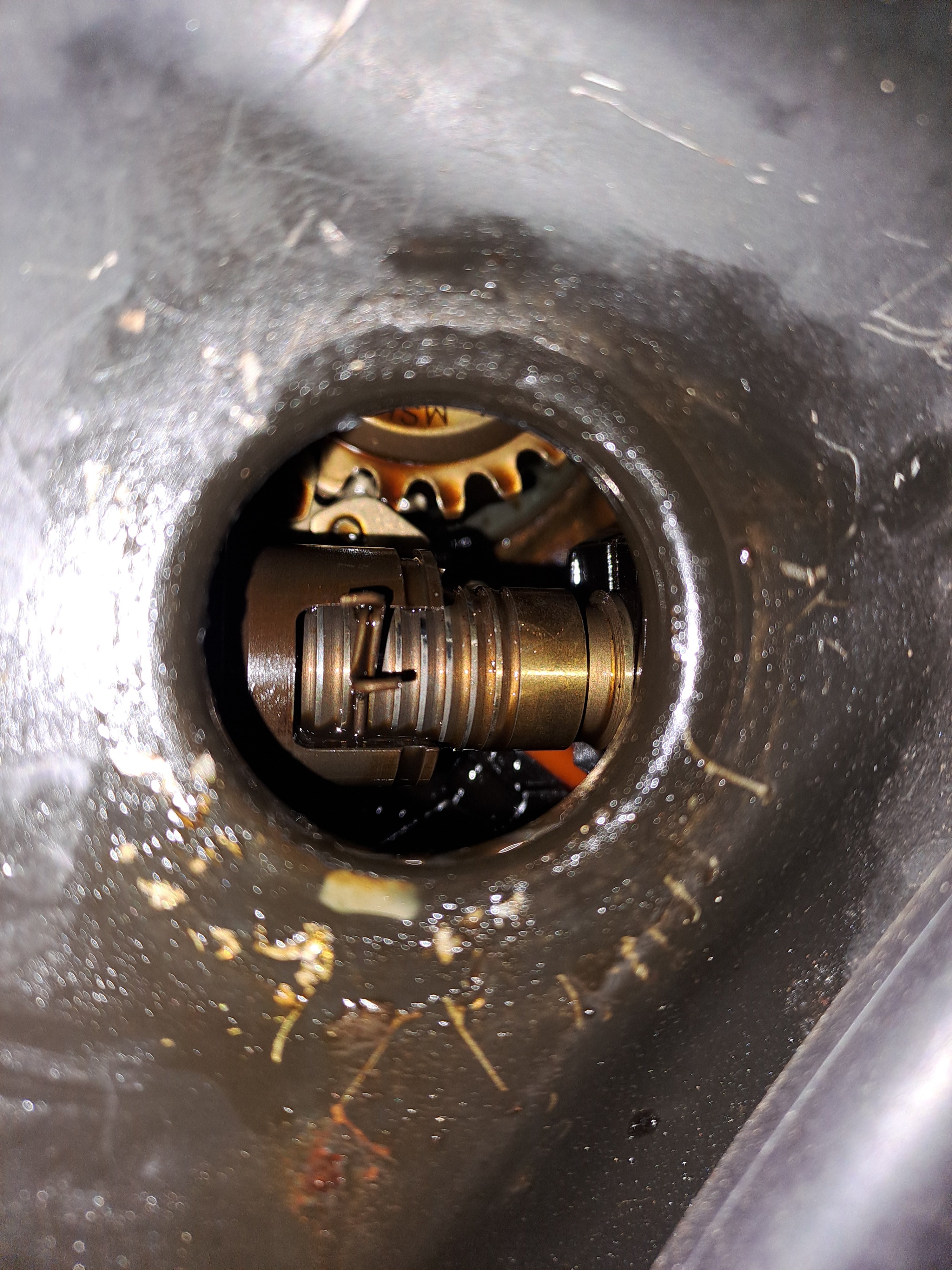

  3. i have 160k kilometers (100k miles), timing chain was probably not changed by previous owner. yes I have new revised tensioner with threads, not old one with ratchet - teeth. But you mentioned wire on tensioner, maybe it should be as much as possible close to left side and then wire will not allow to retract tensioner back. I did photo after ride so it will be good to see from cold stard, if it is rewinded 2 threads... anyway technician says after seeing video that it is wrong tensioner (long life oil contribute to its failure)... But I did cold start with VCDS, and phases were 0.0 degree also during this noise...

  5. you see on the photo that visible threads which are outside of mechanism are 3. VW service manual says that up to 7 it can be out of total 10threads. So according this it is ok. When not running engine i wasn't able to press back with fingers via this hole. Wire I think it it part of this part..here is some explanation

  7. Hello, I have engine 1.8tsi EA888 3rd gen 2015 CJSB and today when I started hear for 2seconds something like chain is about to tension and rattling. Diagnostic is without problems, and values of phase between crankshaft and intake and exhaust camshafts are close to 0° (intake phase is right 0.0, exhaust -0.3° sometimes) - doesnt seem that chain is stretched. VCDS: camshaft adaptation intake bank 1 phase position is 0.0° camshaft adaptation exhaust bank 1 phase position is 0.0° Tensioner of chain is out of three threads from 7 allowed by VW. video https://www.youtube.com/shorts/7O91BDjpFZc Thank you
