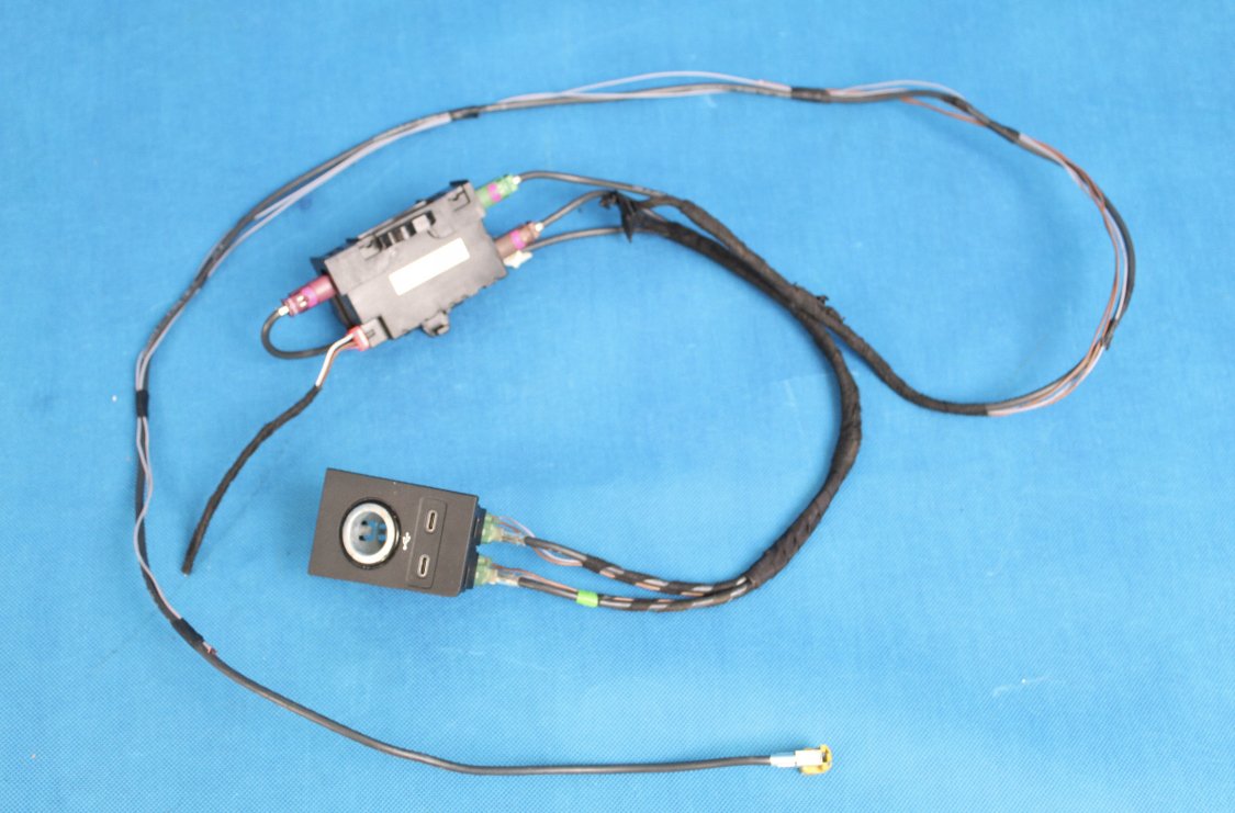

  2. Update on this for those interested. I got this retrofit to work prefectly. Only needed to change hub to mib 2 hub not mib 3 as in picture. All works prefectly.
  3. Hi all I am new here and require your help and expertise. So I have a 2020 Skoda karoq Style version. I recently retrofitted the two usb c ports everything works great except CarPlay. Android auto works reads data from usb dongles no issues. But when it comes to CarPlay it will not recognise it. I have activated the ports via Obd eleven and changed the coding to usb iPod But still will not work. Can anyone on here please help me. I have attached photo of the usb c kit I bought which came out of Skoda karoq 2021 version.
