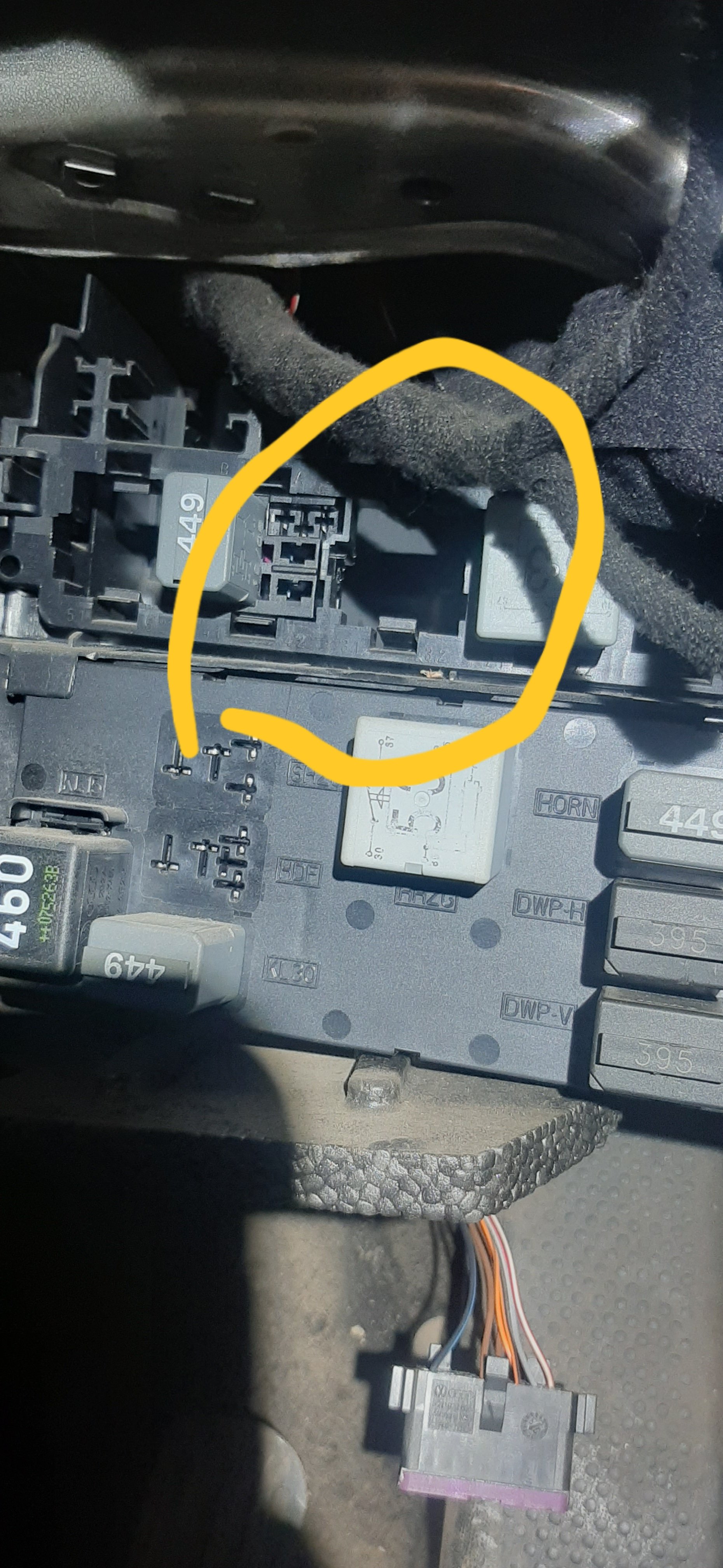

  3. In the end it was the 460 relay sending power to two rows in the fuseboard

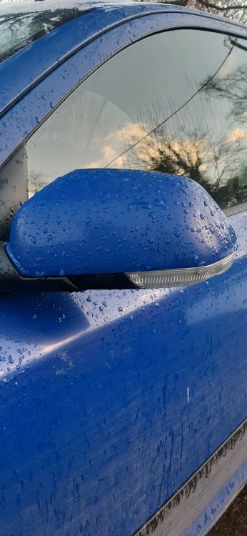

  4. Hi all! Both my power mirrors have stopped working as have the indicator lights on them. I ran a wire direct from the battery to test the led indicators and they worked. So I guess no power at all is getting to anything in either mirror. There doesn't seem to be a fuse and I cant find a relay if there is one. Any suggestions on how to fix? Thanks very much!

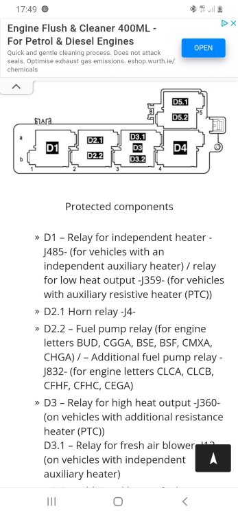

  5. Apologies meant cars with a independent heating element do have the relay. Mine does not.
  6. Hi Pete thanks for the reply. My fault sorry yes its 40a and had checked it and it's fine. There doesn't appear to be a relay in the main relay box under the steering wheel. Online states that there can be one there but cars with a heating element do not have one. The slot where the relay would be is empty so I presume my car has a heating element too. The blower worked before so the lack of a relay there surely can't be a problem. Perhaps there is one somewhere else though? And yes 1.9tdi
