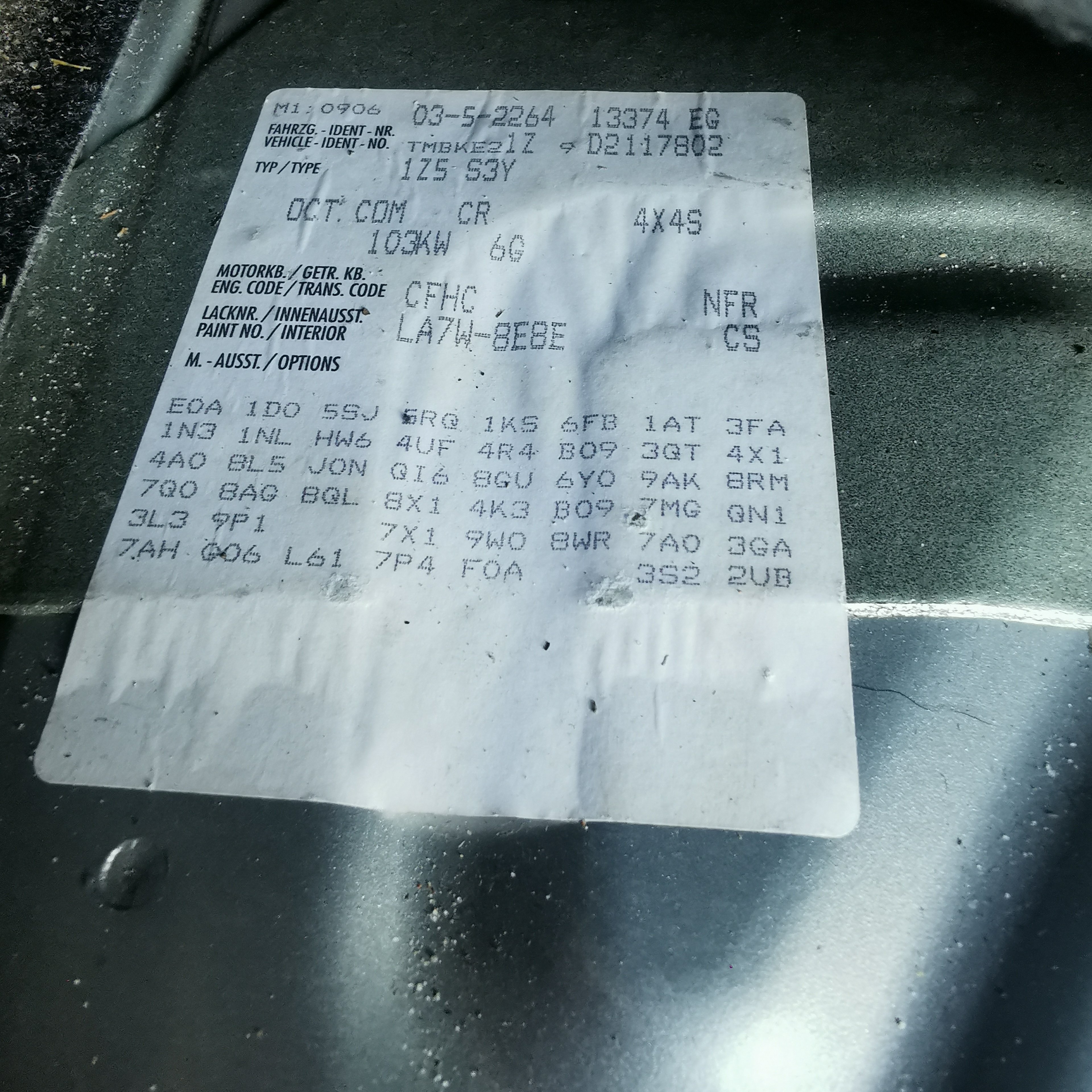

  2. Do you have a website/app ect. you use to decode the white build sticker that would help a butt load if you do🙏🏾
  3. Yeah all the way down the bottom of the globe, there are a couple standard mk2 octavias here may flog it off to them if it's wrong 🫣

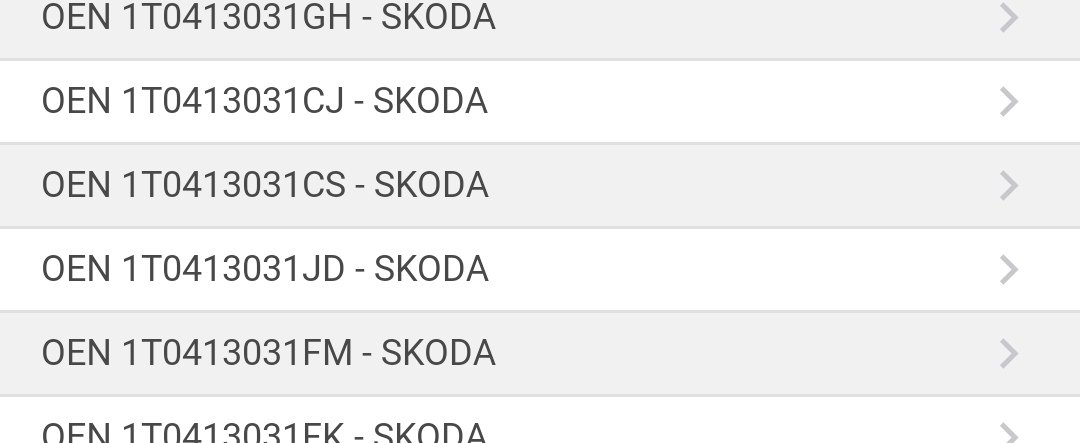

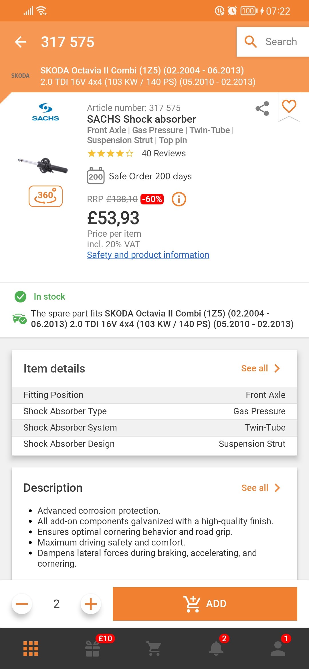

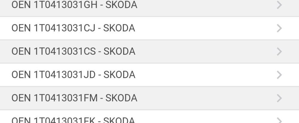

  4. Cheers so had a look on Autodoc n found this, this correct?

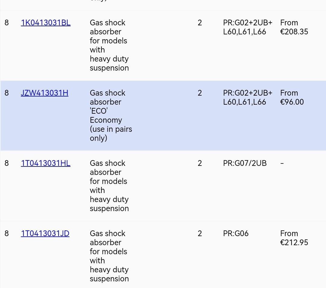

  5. I've got a 2013 mk2 face-lift octavia scout. Im looking new front struts, I've checked on autodoc and LLL carparts catalog but there are so many different part numbers etc. I have a pic of my build option sticker attached and carparts catalog but which do I go for.
