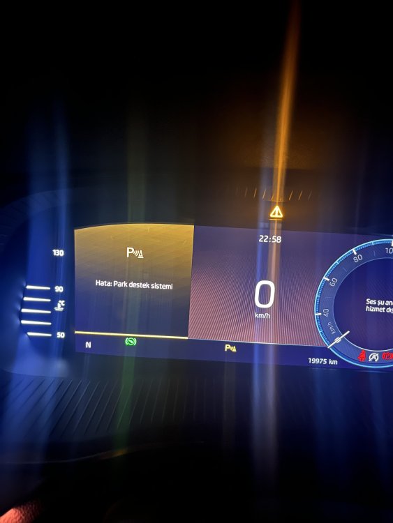

  1. Hi again😬 This morning ı solved the problem. All problems about multimedia system. Making hard reset with pushing ten secnond on/off button in front of multimedia screen . Thanks.
  2. My car has fault light with starting . Manoeuvre Assist brake system not working and come with yellow caution light and at the same time multimedia system not working also multimedia screen is blank . I can not control nav, a/c , navigation !! Have someone have this type error ? It can be from main battery?
