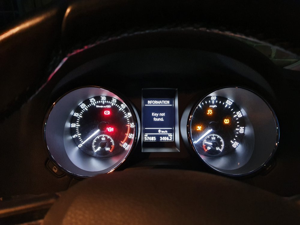

  1. Austin 7 wins a gold star - it was broken wires in the tailgate loom - sorted by my garage
  2. It's not keyless I.e. you need to put the key in the ignition "old skool" - cars done 57k

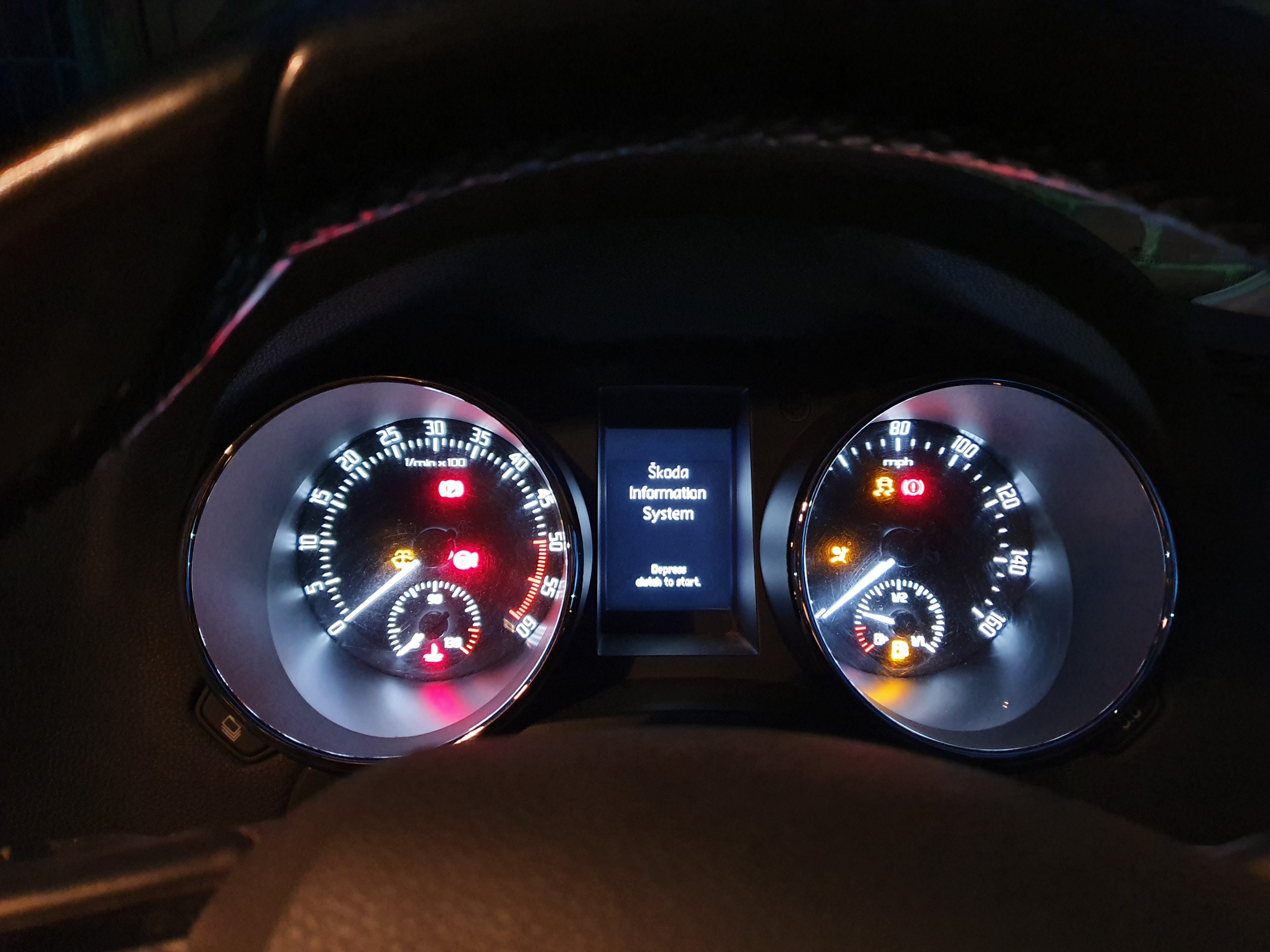

  3. thank you for the replies - I disconnected and reconnected the battery this morning but the the problem persists ☹️
