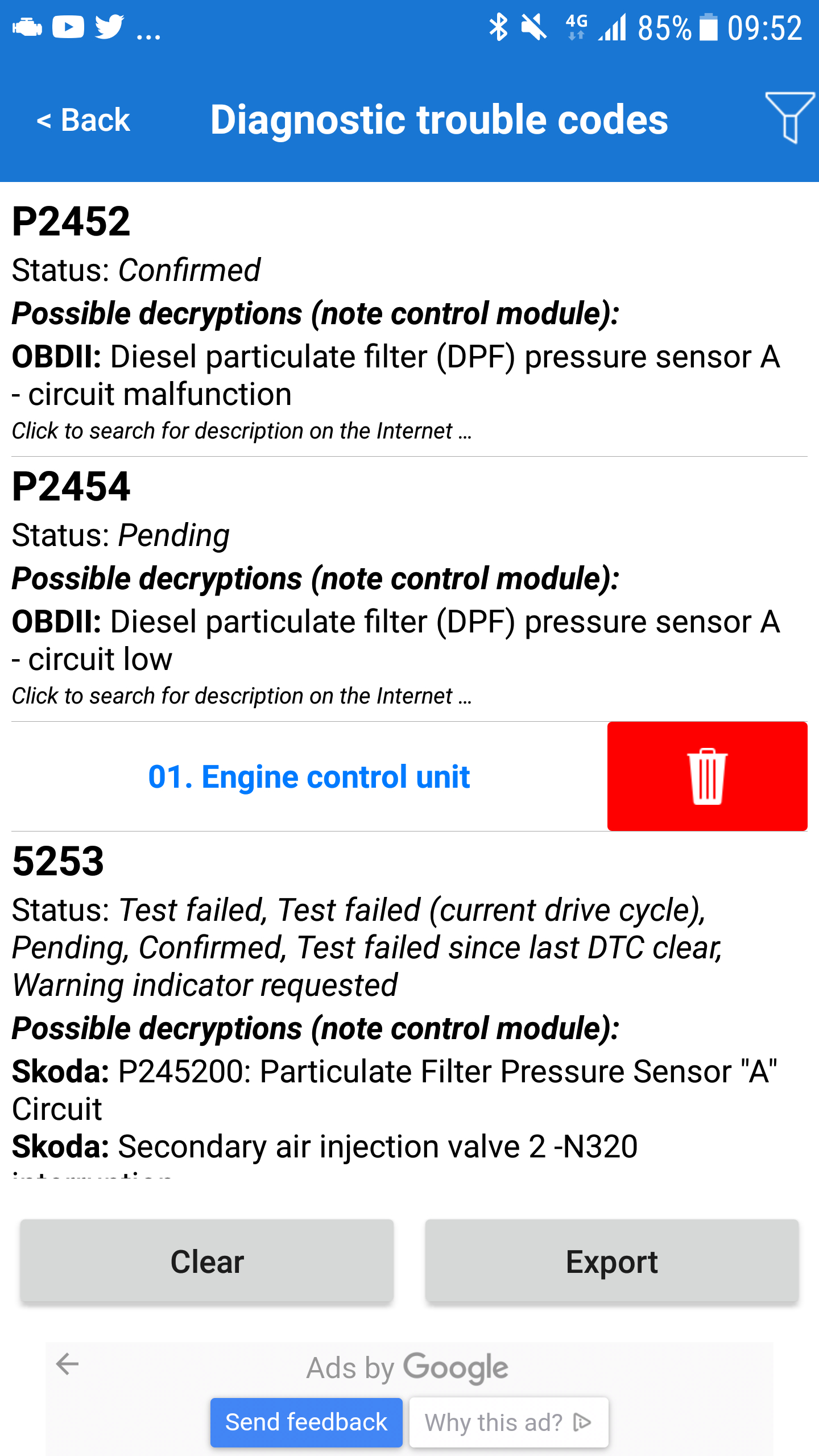

  10. Morning varooom, had a good look at obd2 functions and can't see any soot values etc - (it's only a cheapy 9£ thing borrowed off mate). Below is attached codes thrown up (3 in total). Best. Blue.

  13. Hi varooom, don't have them to hand as app not connected to obd2 reader. From memory though it was p2352 (or close can't fully remember). There was a stored dpf filter pressure 1, 2 and 3 code plus an egr code. I'm pretty sure it's the pressure sensor - will read again tonight or tomorrow and get back with specific readings. Best. Blue. Thanks for the reply.
