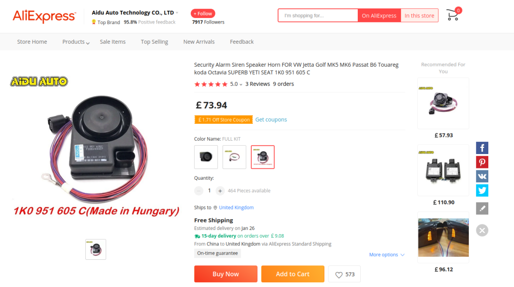

  2. My mistake, it's £14 for the wire, but the "FULL KIT" (Siren + Install wire) is £74 on this link. Is that the right one? I've heard they were cheaper elsewhere. https://www.aliexpress.com/item/32867380080.html
  3. We've known the car history for 5+ years and the alarm unit hasn't been changed, I doubt it was with the first owner. So I've found some potential links to the alarm units, are these the ones you would recommend: First-hand, official supplier, £163 - https://www.theskodashop.co.uk/products/electronic-siren-1k0951605f?_pos=1&_sid=69a6cb427&_ss=r AliExpress, made in China, £14 - https://www.aliexpress.com/item/32867380080.html?priceBeautifyAB=0 I spoke with my stepdad, he's saying we should go for the cheap one, it's a tough one. If there are any other links or places you would recommend to look, please share them below and I'll check them out, cheers.
