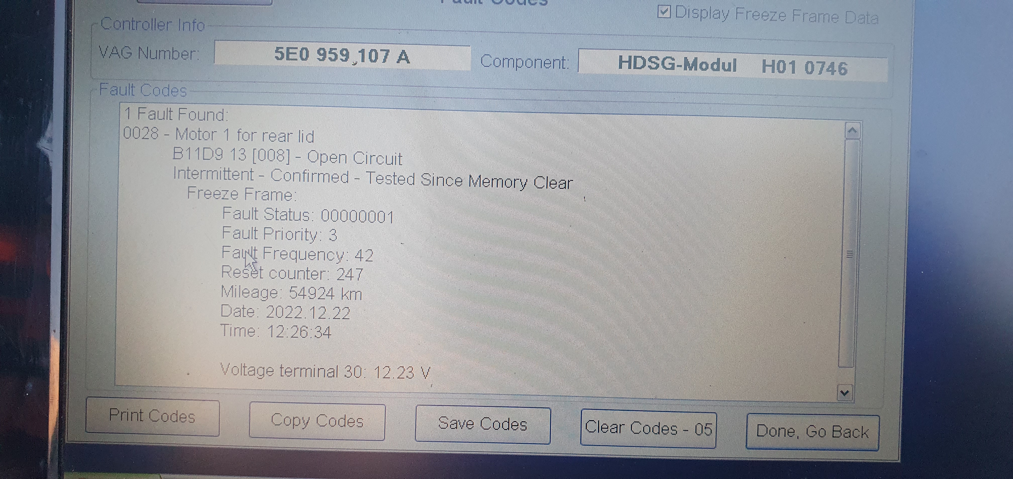

  1. Thanks for the prompt response. I will give that a try. £220 is a lot better than nearly £300 per side on Autodoc
