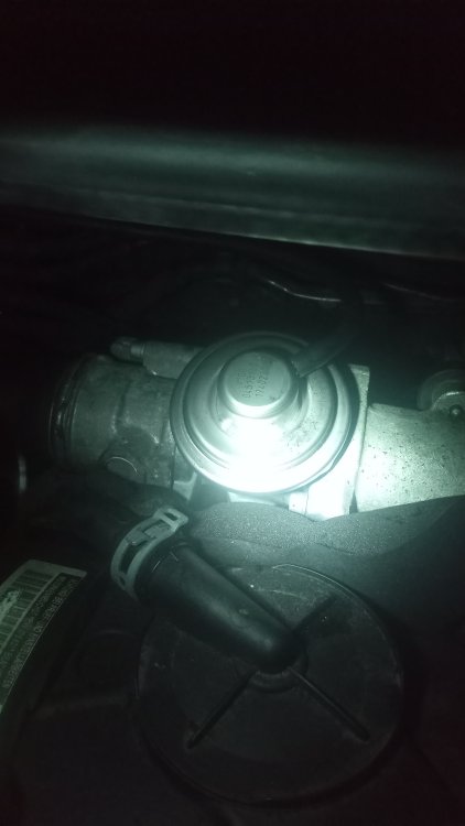

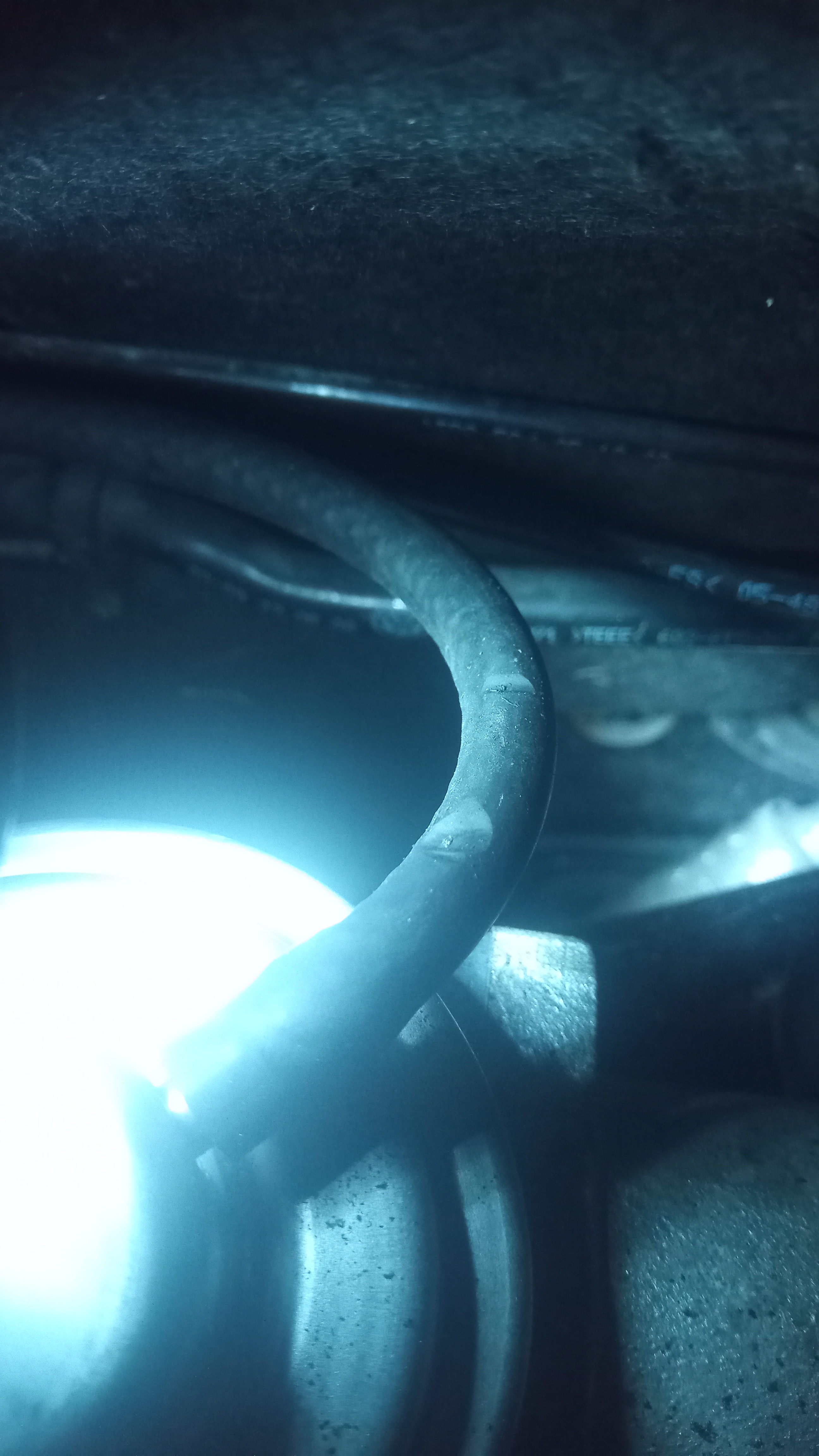

  7. Thanks, I couldn't open the the fabia section as it wasn't highlighted. The link seems to work Thanks
