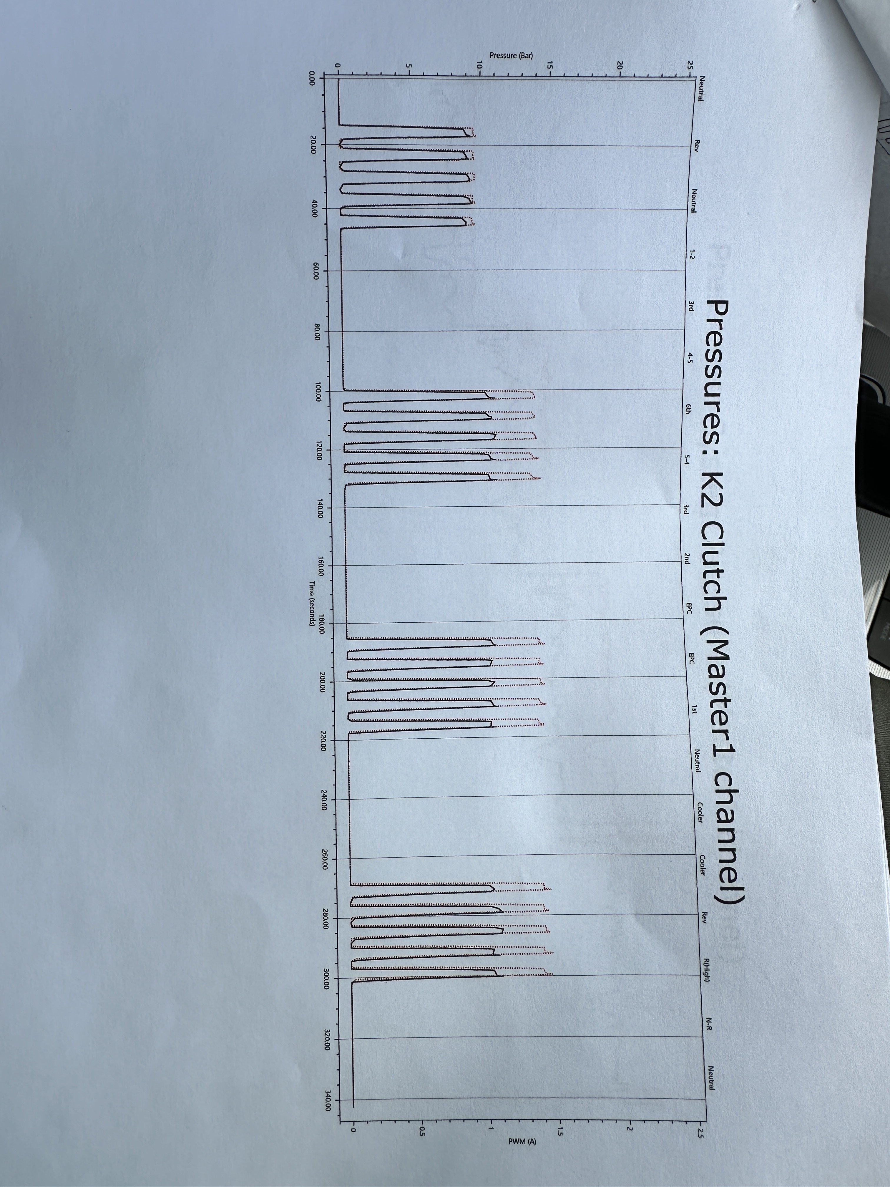

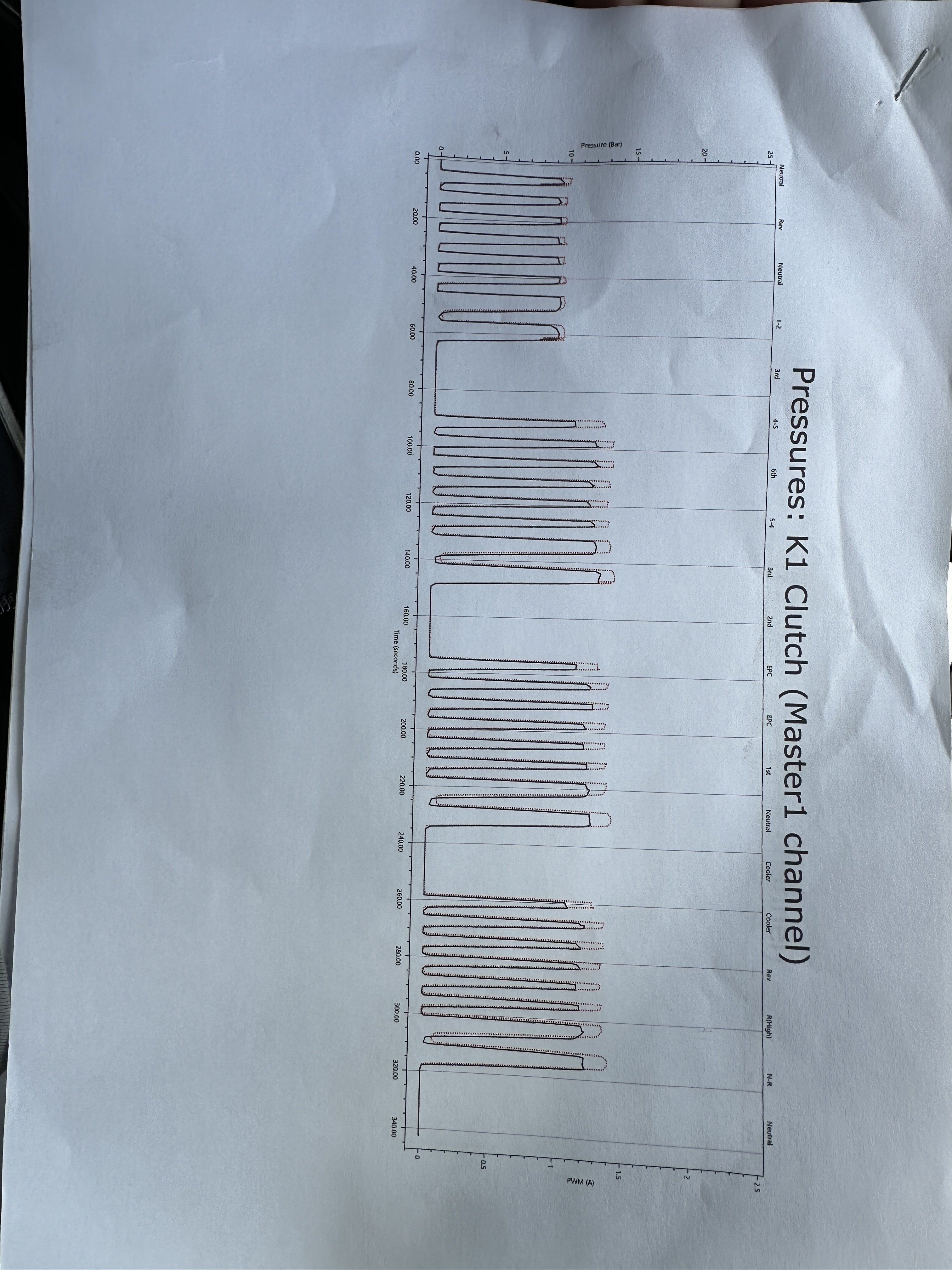

  3. Update. So after they replaced the clutch nothing changed with the car so the same symptoms gear disengagement in 2-4-6 gears (especially when coasting) and lost of reverse gear until stop. The reason why I accepted the clutch replacement was because I thought the car would be like before with no errors but it will wear the clutch in time due to mec unit being not able to keep it in gear. The garage told me that the pressure on k2 clutch is too low and this will cause the gears slipping of. I have attached the photos with the tests done by the garage. The funny thing is I took myself the mec unit out and send it to ECU Testing and they couldn't find anything wrong with the unit. I just explained them the situation and what the garage told me and they accepted to retest it so I'm waiting for further news from them. I'm in a very strange situation as I don't know what to believe. Maybe it was a mechanical problem inside the gearbox and the garage wanted to rip me off, maybe is something wrong with the mec unit so I'm totally confused.

  6. This is the report they gave me. There are no fault codes for mec unit.

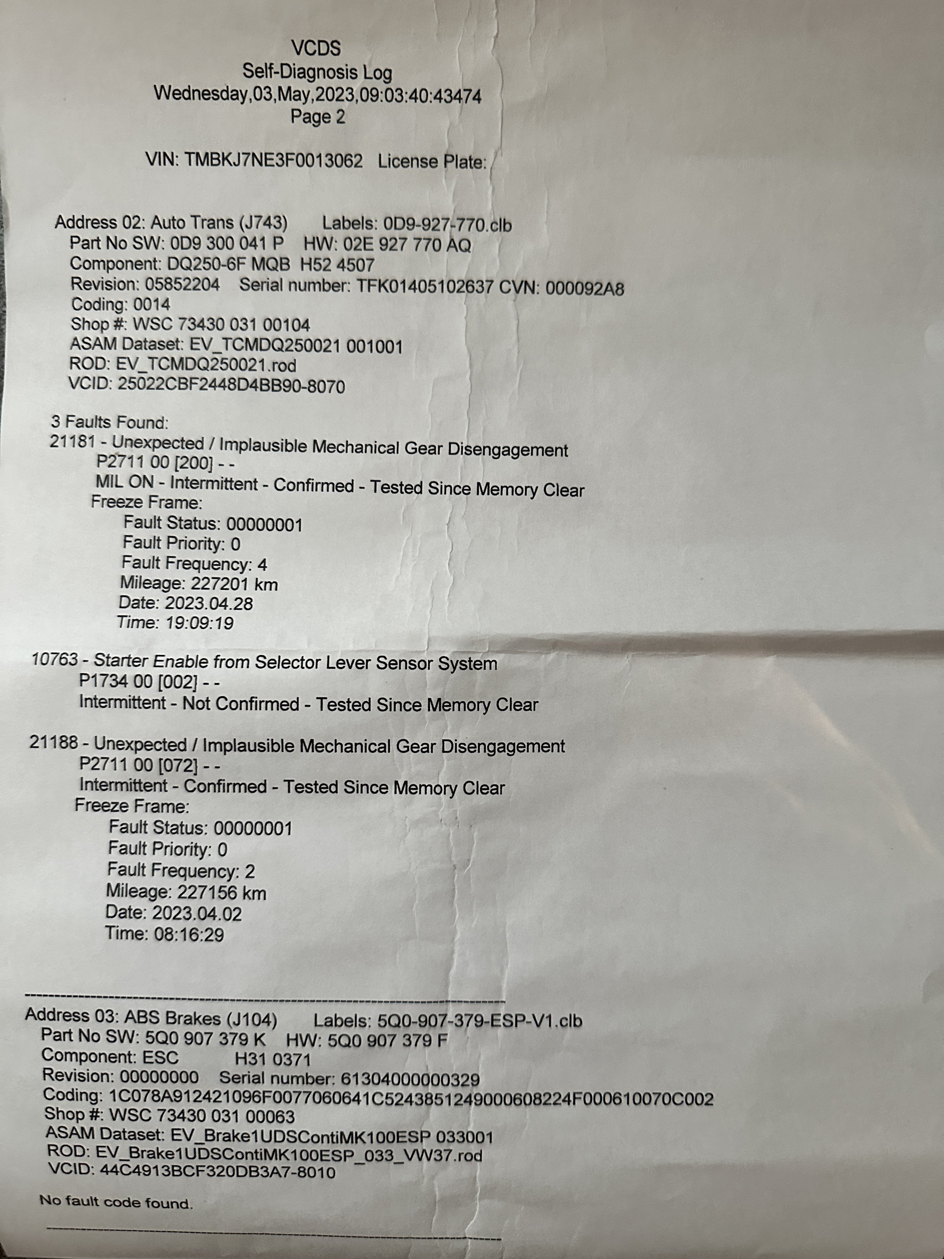

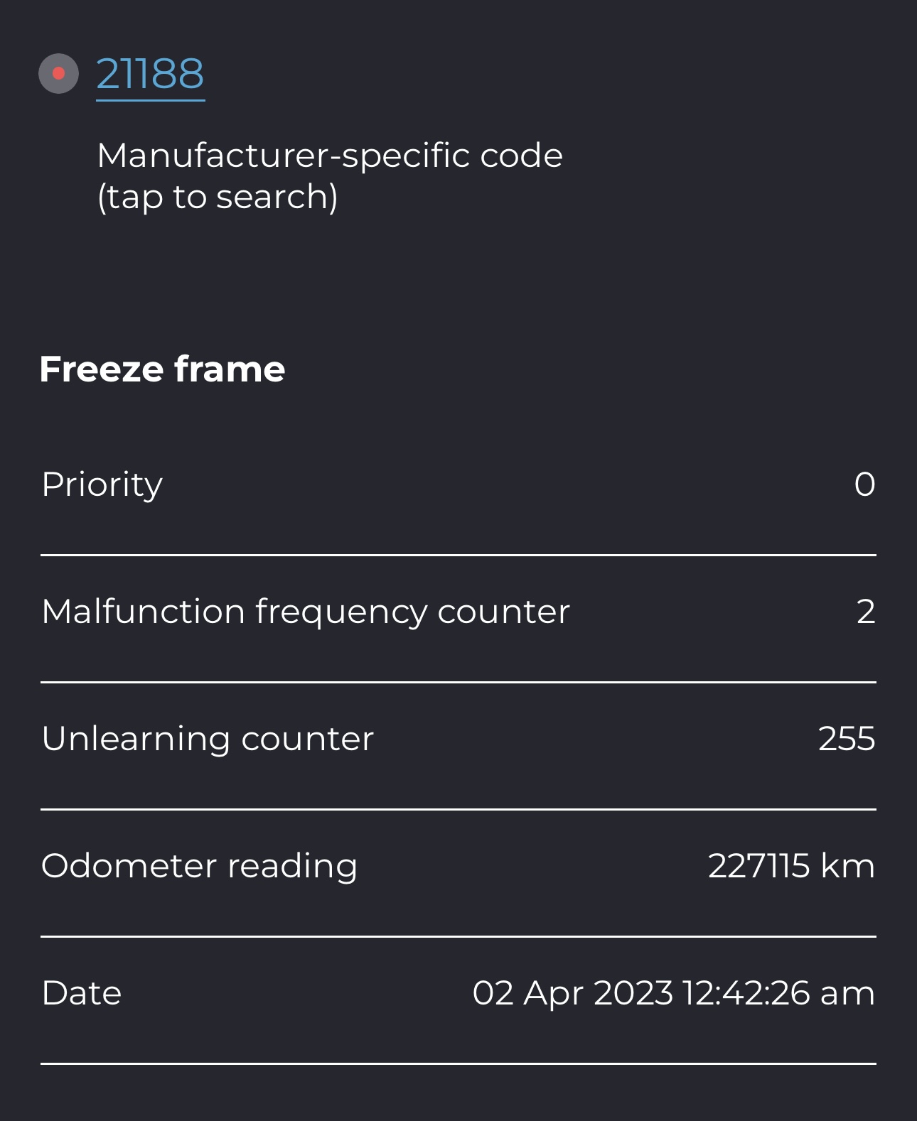

  11. Checked and these two codes came.

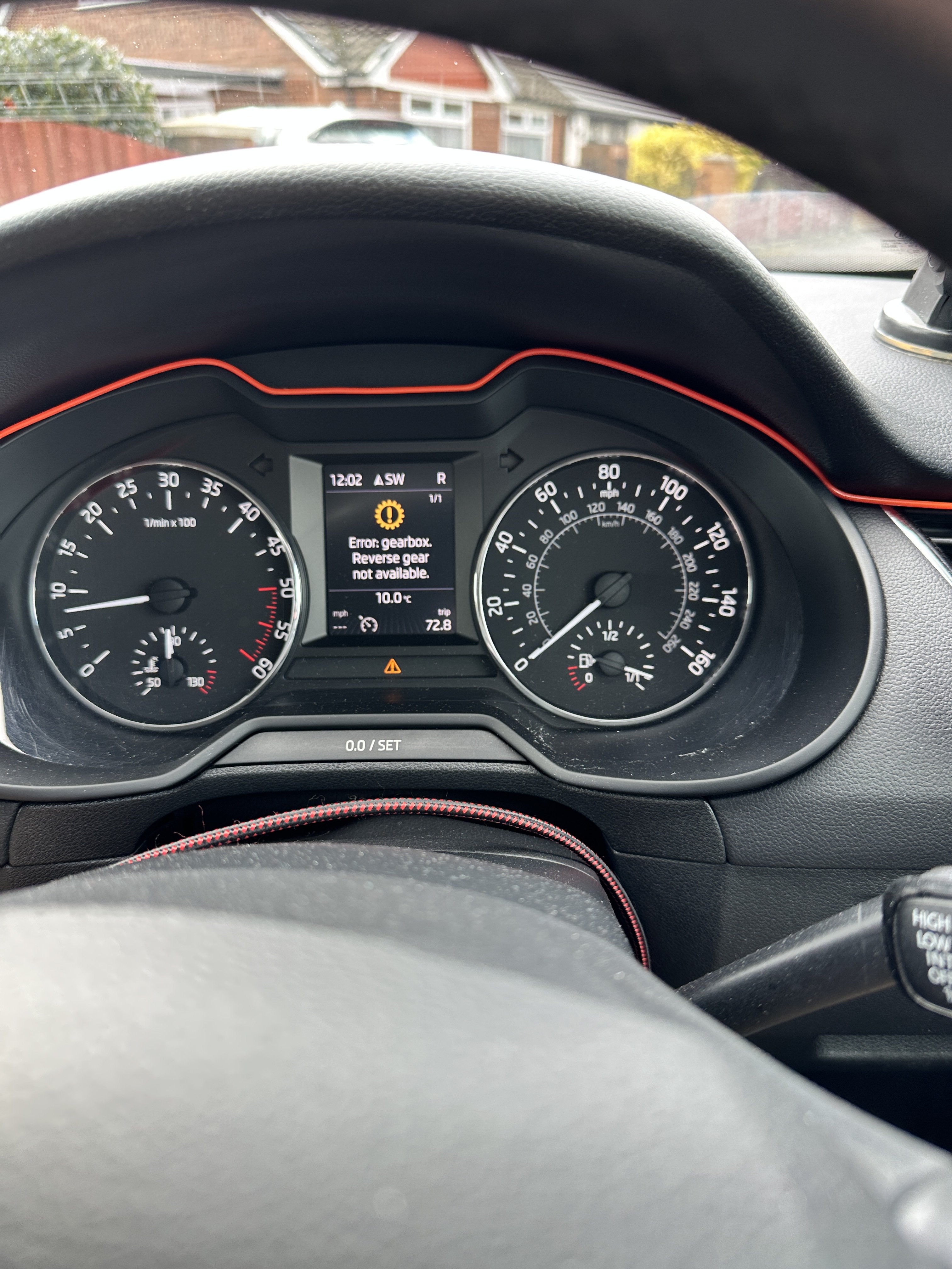

  14. Hello everyone. Today during a motorway drive the car suddenly came off gear and this error occurred. The error disappeared after I stopped the engine and turned it on but it will come again only in the 6th gear I've noticed. Also when the car is in the 4th or 6th gear and I take off the foot from acceleration it feels like the car is sluggish and the rpm indicator is going up and down. So seems like only the 6th gear trigger that error. The car pulls and change the gears as normal so no noises or something. The clutch was replaced 35k ago so I'm thinking to change the oil hopefully this will solve it. Anyone experienced these symptoms?
