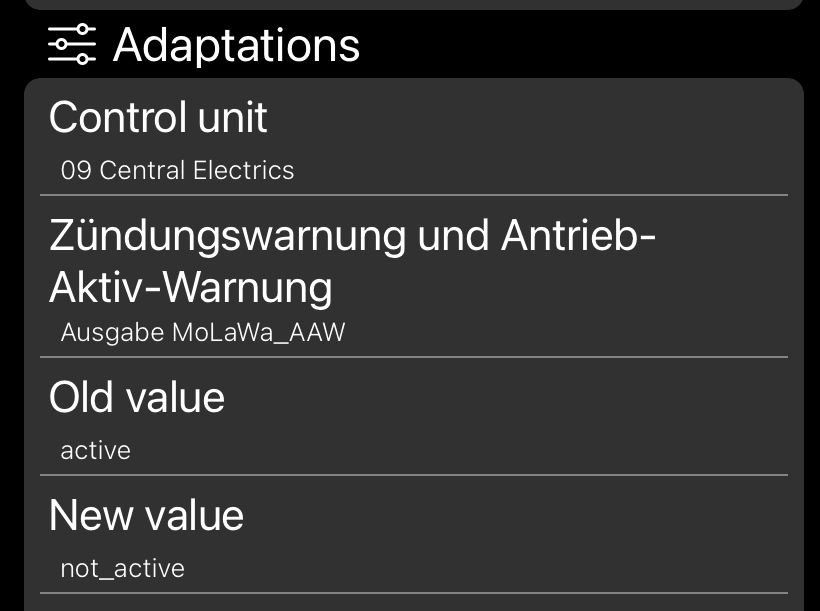

  1. Open door alarm deactivation with engine on.
  2. I activated Blower display in auto operation and g-meter, but it didn’t work.
  3. Hi, is it working? Disable beeping when opening door when engine on. I changed the value: 17 - Long coding - Ignition key warning device - NO. Inoperative if the engine is running or in start-stop mode. Do you need to change other values? Thanks. Tomas
