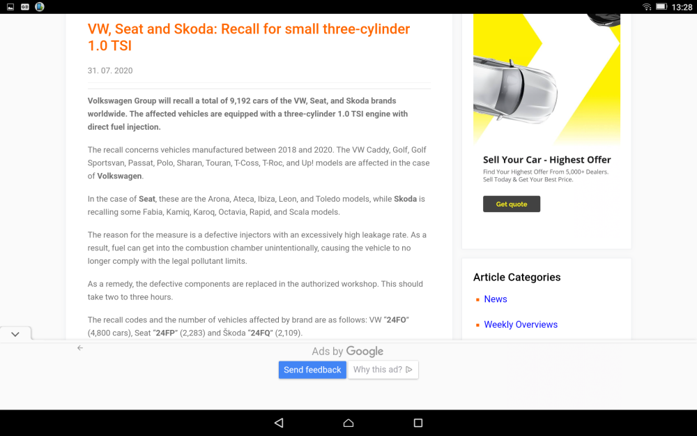

  3. Gerrycan, emissions wouldn't get tested until a cars 3 years old here, during its first mot. I would expect emissions to be checked when the car leaves the factory. Previous 2 mots were OK. Toot, interesting point regarding GPF, not sure if it has one or not. I do know the mot tester/mechanic drove the car hard for 12mls and retested emissions . Eventually he did just manage to just get it to pass but says there's a definite fault. He's doing more research to find the cause of the fault. I've attached a screen shot of the recall. Couldn't get the link to upload. Perhaps file to big? Cheers

  5. Hi- My above 2018 , 47k car has recently failed the mot on exhaust lamda after 2nd fast idle and exhaust carbon monoxide after 2nd fast idle. With no fault codes showing. I've found a number of these engines have been recalled due to injector problems but on approaching Skoda dealership they said mine wasn't on their list and all had been recalled so I'd have to book it in at my expense for investigation. Has anyone experienced a similar problem and solution. Difficult to know what to change with no fault codes present. Cheers, Benno
